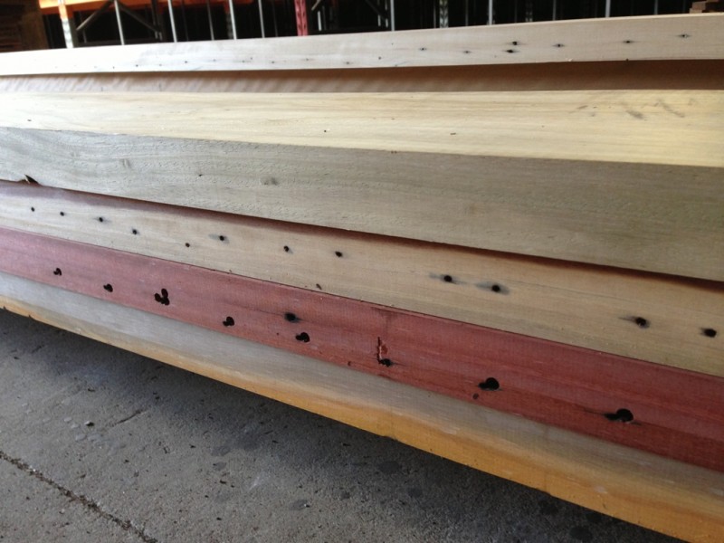

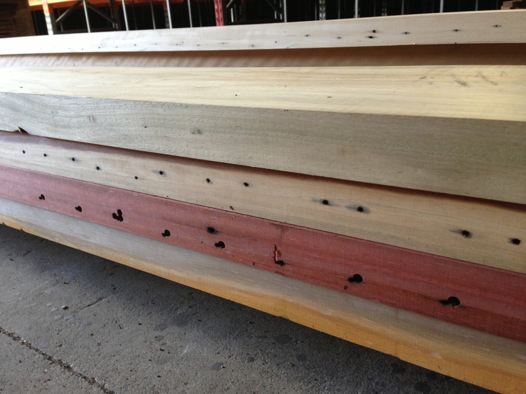

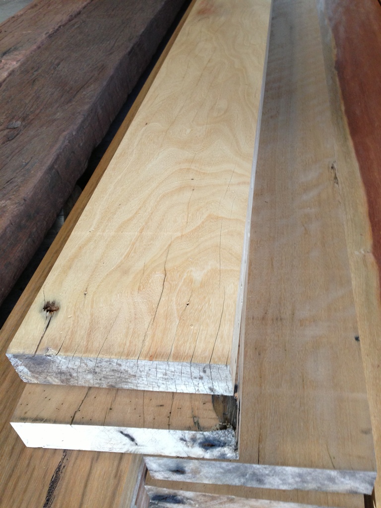

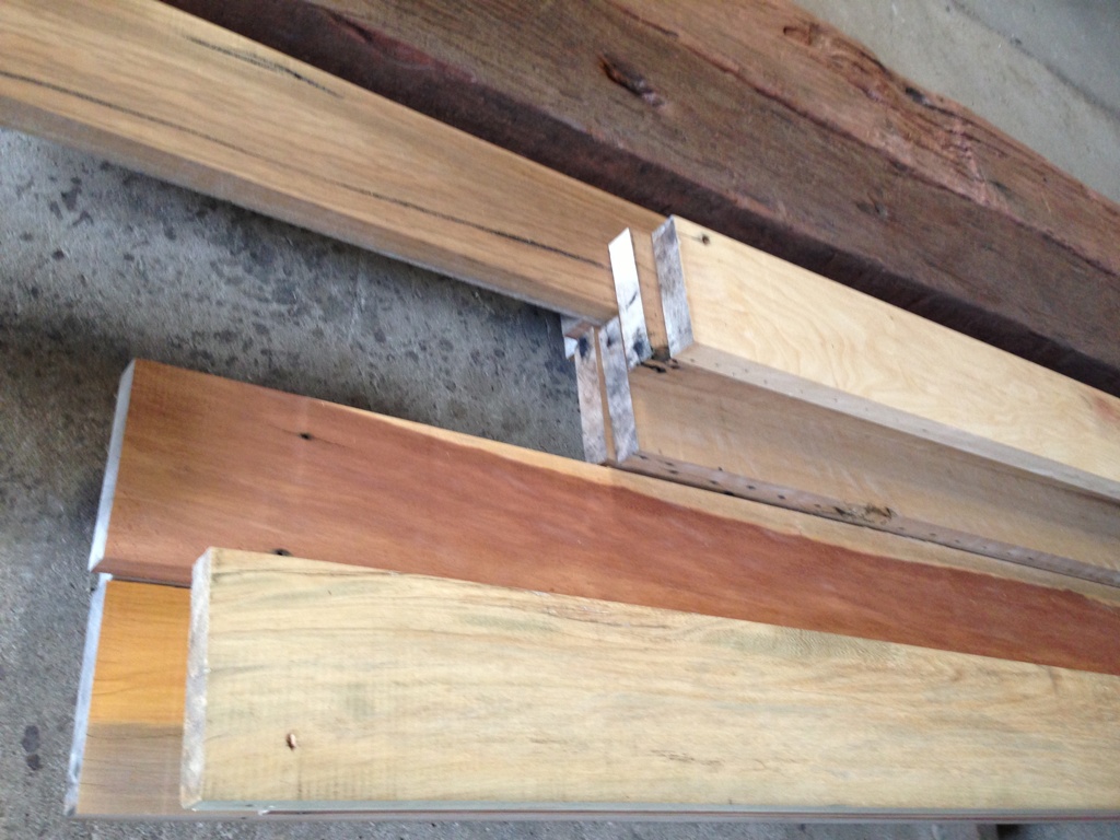

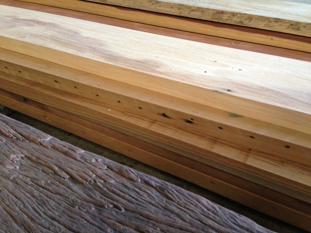

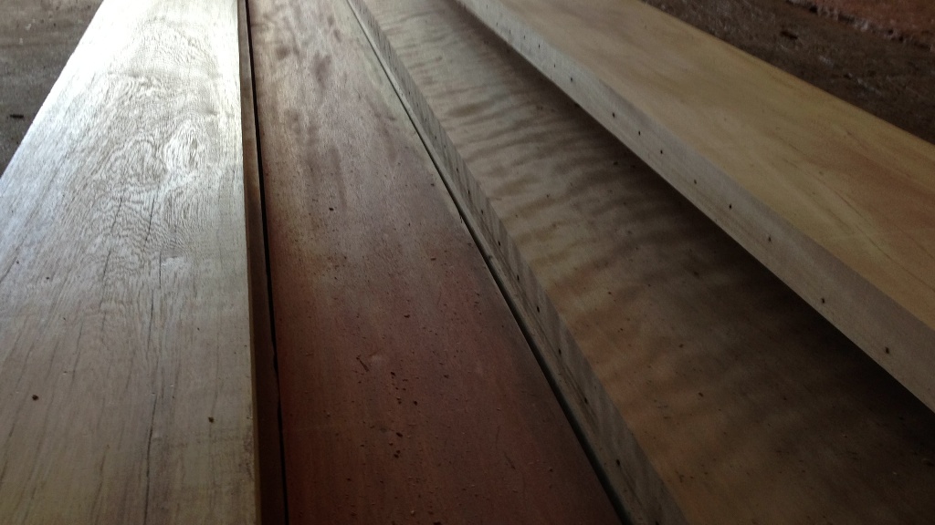

Hi, just went to "the Big Red Shed" at Darra, Brisbane where I came across these timbers.
They were not sure what species they were other than one may be yellow wood. They all come from North Qld and were salvaged from cyclone Yasi.
Anyone know what they are or if they would be good for electric guitar bodies & necks.
Cheers< Will

Some spotted gum, red ironbark maybe?

Given where the timbers come from it would be pretty difficult to answer exactly what timbers are there . The region is Australias most diverse for tree species . Assuming the recycled timbers were sourced locally ( which of course they may not have been ) you would then move on to what the timbers were previosly used for . If they were exposed to weather then they will be of durability rated species . Unfortunately given the region that still leaves a whole heap of possibilities . Genus could include Xanthostemon , Flindersia , Lophostemon ,Backhousia , Gmelina ,Syncarpia , Eucalypts of course and tens or hundreds of others .
The 5th photo shows what looks like a backsawn board of Crow's Ash , Flindersia australis but equally could be a weathered bit of Yellow Wood , Flindersia xanthoxylon ( probably wrong spelling , didn't google check ! ) . What you would find is most of the timbers will be hard and heavy , difficult to carve particularly and work with hand tools generally .
I might have it wrong but I think I'm looking at old durability structural timbers like Turpentine , Ironbark , Crows Ash , Johnston River Hardwood , Brush box , Penda and such .
One of the backsawn boards seeemed to show a faint ray fleck reminiscent of an Argyrodendron , a Booyong or Crow's foot Elm which can be really pretty and not so hard .
Looks like some good stuff there .
What I'd say is if there is something you really like , buy it and try it out . If you want to be more methodical send a sample off to the wood testing lab of the DPI in Brisbane and Garry will tell you what you have . From there you could cross reference it's properties and uses to Bootle or one of the other guides to figure what it's good for .

Bottom photo showns a red timber that looks a little like Mackay cedar , from memory Alstonia toona . It's a bit lighter than some of the other likely timbers in the lot , polishes out well .
