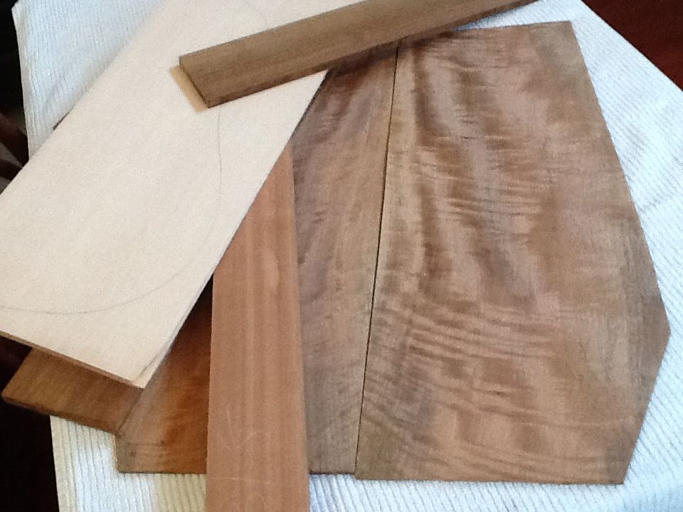

OK, so some friends have asked me to build a guitar for their son, Jack's, 18th birthday. You could knock me over with a feather. Gonna be done cheap for them, really just to cover costs and maybe sneak in a B/S set or two.
Jack came over yesterday and we went thru my little stash, and settled on mango (from bobthebuilder,maybe?), a AAA Sitka top from Brent Cole, Qld Maple neck from Tim, and have spoken to Graham at Loggerheads(first time, and nice to deal with) to get some ringed Mulga for the FB, bridge, linings and head plates......a picture of what I have on hand. It's pictured dry, and I think it'll really pop under lacquer.....
Now, my question.....I'm out of kerfed linings and am not too interested in making up a jig to make them and not sure if I really want to buy more at this time. What I do have is a big pile of the bracing from the group buy for Bearclaw tops last year.
Oops, NOW my question(s) Is there any benefit to using solid/laminated linings over kerfed? What thicknesses would you recommend, I was thinking 3mm spruce/2mm blackwood, 2mm spruce? Would they need to be bent the same as the sides? Finally, until I think of more, how would you orient the grain? with quarter into the side, or along? Don't know if you understand that distinction or not, but do I want to see the grain lines in the face of the lining from the inside, or more like a brace with the grain ....... vertical,for lack of a better word......?
