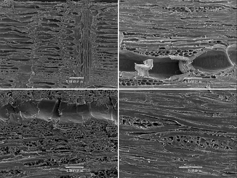

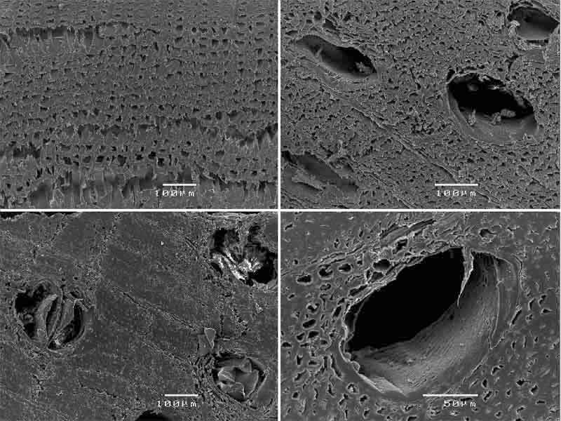

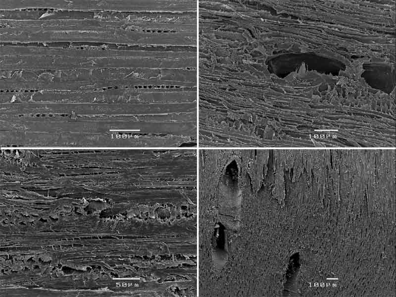

Not hugely rigorous science here - just some pretties comparing timbers. Tried to get all 3 planes and if I got it right they should be in order as if looking at a quatersawn slab -
Transverse (end grain); Tangential (side edge); and Radial (top surface). Rather than a huge long line I've grouped them and they run clockwise from top left as Sitka Spruce, Queensland Maple, Indian Rosewood and Tas' Blackwood.
Transverse-end grain
Tangential- long edge
Radial (top)

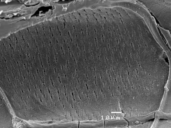

And one for Markus - earlier request for inter vessel pitting (close anyway).
Blackwood intervessel detail

Nice pics, interesting the difference between cuts, looking at the Transverse slice I would have said that the Rosewood is really porous, looking at the size of that crater but looking at the Tangential slices it would appear that the Queensland Maple has more cross sectional porosity.

[quote="Kev3"] Rather than a huge long line I've grouped them and they run clockwise from top left as Sitka Spruce, Queensland Maple, Indian Rosewood and Tas' Blackwood.
/quote]
Got that wrong... I listed them left to right, so last two are mixed up. Should have read "clockwise from top left: Spruce, Maple, Blackwood and then Rosewood"
should have proof read and sent for peer review before posting :lol:

Kev3 wrote:And one for Markus - earlier request for inter vessel pitting (close anyway).
That's an absolutely amazing picture! :cl :cl :cl
It is not too often that in a luthierie-forum one can get this kind of pictures "on request", free of charge, just because someone else apparently also likes to have fun with the benefits of technology. 8)
