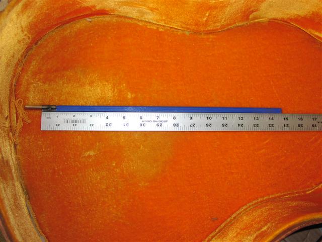

Re: A few neck issues
The rod pictured is not a martin rod at all , the failure point on this one and others has to do with the design. In these cases the barrel nut is soldered or welded to the threaded rod. This creates a stress riser at the threads. The rods failed when they were tightened after neck assembly.
The martin design ( I am talking CF Martin ) not the fake martin designs out there is bullet proof.
Martin uses 2 suppliers and the rod will come in a black or blue shrink sleeve. This is not removed.
http://www.bluescreekguitars.com/shop/i ... cts_id=128
the design is simple and very reliable. The rod has a welded in the business end has a cylinder attached and inside this is the barrel nut. As you adjust the nut it will pull or push on the cylinder making it longer or shorter, This in turn makes the static rod bow in both directions. It is very reliable and I have not seen one fail.
The older Martin design was a single action rod that was inside an aluminum channel , and this only adjusted to create back bow. As a machinist and engineer I can say when you weld or braze a nut on to a threaded rod , you will change the rockwell hardness. This can make the weld point brittle , and that is where the failure occurs. This is not a new problem , it has been around for a while.
Nothing is more frustrating when a finished neck has a broken rod to be replaced.
The Martin rod with the aluminum channel is a 1 way adjustable rod.
In the 2 upper pictures the red one is a stew mac hot rod. Mine snapped off at the barrel nut at the brazed end
the next one down is a 2 way design from lmi again it broke off behind the barrel nut at the weld
the blue on is a martin rod they will be in black or blue depending on the supplier they get them from The welds on the others are torqued and this doubles the force on the joint . On the martin rod the barrel nut is not welded , it is crimped . I tried to break it , and it took a lot more force than one would ever use .
If you set things up right , you don't need a 2 way rod . Wayne Henderson makes his own rods, they are a true tension rod. A long threaded rod with a barrel nut inside the guitar. He gets a tab welded on the end of it and it just lays in the channel. I have seen rods like that in Gibson that appeared to be long bolts like what are used on phone cable wire reels.
