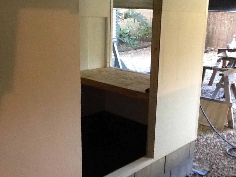

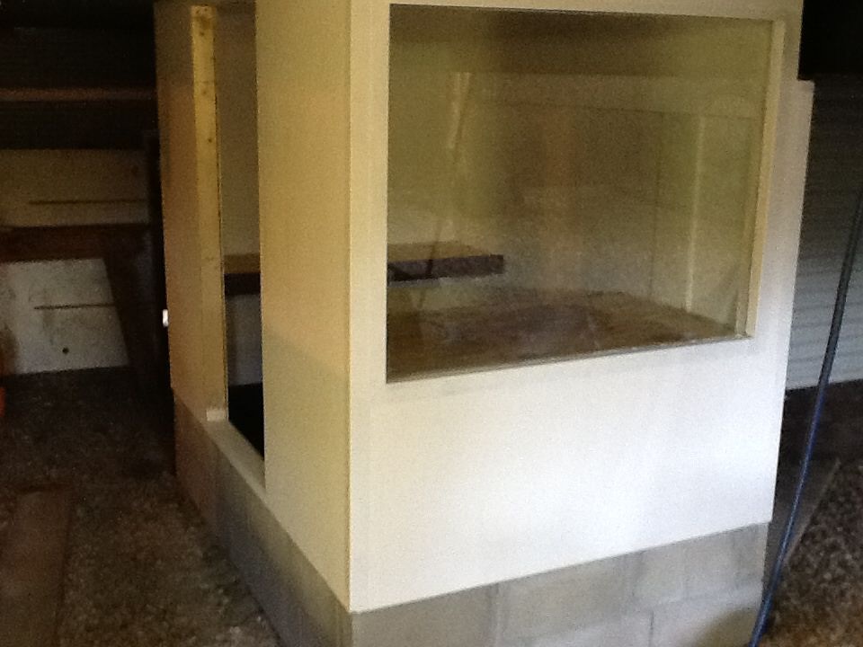

OK, having got jack of not being able to do any work yet this year, due to average RH around 80% up here, I built myself a small dry room....
1.2m x 2m x 2m
It isn't insulated, but it IS very well sealed, and all the gaps have been filled. I putmin two benches, which will double as go-bar decks. It's on a slab and has a block base due to the fact that this area under the house has flooded before. If it goes more than the 450mm, it deserves to get wet.....
Here's the problem. I have a small de-humidifier, which in the past wo days has removed about 1/2l of water from the room, I've tried a heater, and a spot light, but neither of my hygrometers measures lower than 68%..I've ordered two more, as my two are always at least 10% apart....
I'm going to Brissie on Sunday to have Mother's Day dinner with my wife and daughter(who is in Brissie) and there is a delonghi dehumidifier for sale on the bay, that I could pick up on the way. It is a bigger unit than what I have now, not to mention half the price....
Would a bigger dehumidifier make the room dryer, faste ad more efficiently? I'm struggling with this RH issue up here, and sort of only get a week or two a year.....My dry box goes low, but, as I learned last year, I can't ever open it to manipulate the materials inside....
It does have a door and weather stripping to seal it now....
Pics
Oh, I also have four Damp-rid buckets in there....
1.2m x 2m x 2m
Pics
