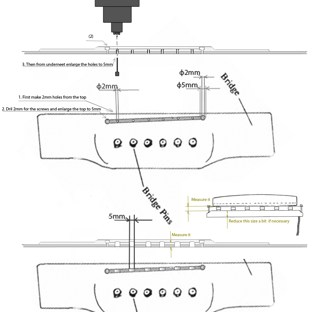

Hi Christian,
They are only available from maton, you will need to turn your top into swiss cheese to install it , they are know as a palathelic Pickup, I suspect Dekka might have another name for them .
As Dekka said they can be inconsitant , and when they go wrong can be a bitch to get balanced and working properly, talk him into something else , K&K or BBand or a Fishman.
See pic below.
ap5 2.jpg (5.32 KiB) Viewed 12839 times
Posts: 1070
Re: Maton AP5 pickup
Post by Taffy Evans » Wed May 22, 2013 4:44 pm
I agree, something like this. Causes weak and often "bellied" top.

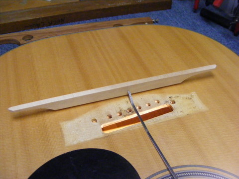

I can't get over that huge slot cut in the top. I gotta say i'm a little worried about these. Especially if it needs fine tuning because my building style isn't the most practical for adjustments.

christian wrote:I can't get over that huge slot cut in the top. I gotta say i'm a little worried about these.
I reckon that if you make the top 50% thicker you'll be just fine... :mrgreen:
