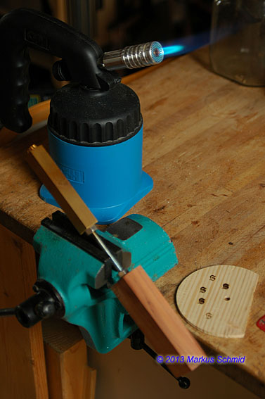

I know, it may seem kind of an exaggeration for a non professional instrument builder to have a branding iron. But the same does go for non professional instrument building itself, doesn't it?
I "lent" the letters M ans S from the facsimil of book of the times when the guitar was called vihuela de mano: Libro de música de vihuela de mano intitulado 'El maestro' by Luys Milán, MDXXXV (1535). I photographed the two letters (different texts in the book) run them through Photoshop adapting them slightly and smoothing them out, converted the jpg File in a vectorized file in order the engraver would accept it, emailed the vectorized file to them, and received today this:
MS

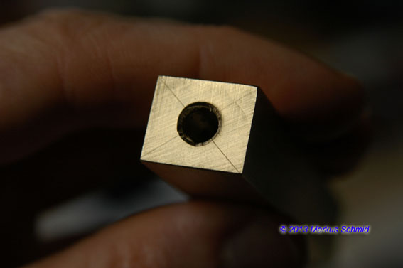

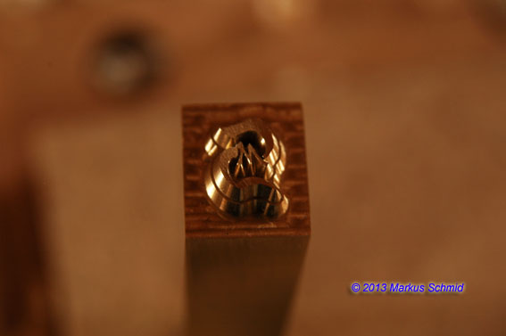

It is rather small. The letter "S" is 8 mm high and is engraved (well, actually it's "outgraved" :lol: - is there a proper term for this?) on the front side of a 80 x 13 x 15 mm brass bar. I then drilled a 5mm hole 25 mm deep in the opposite side, made a M6 thread...
25mm deep, threaded hole
...screwed in a threaded rod, attached a wooden handle and fired up the torch:
The branding iron is held in the vice during heating up and cooling down.

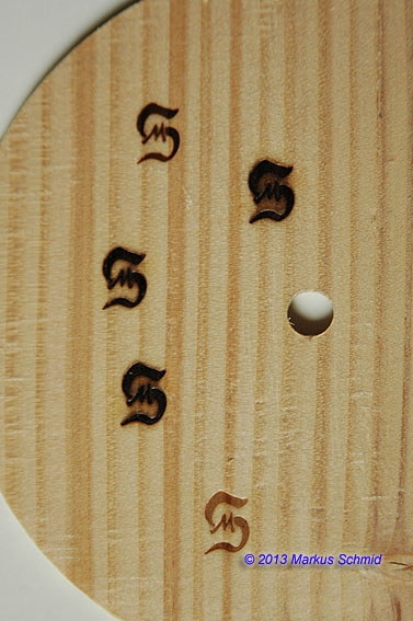

Then I proceeded to do the first tests on scrap wood. After about two minutes of heating the bar ca. 20mm behind its tip (directing the flame directly on the engraving could destroy it) it was ready to go:
The uppermost attempt in the picture above was the first one (about two seconds of branding iron contact). In the next two minutes, without re-heating the brass bar I tried out how the results would vary with longer contact (maximum was about 5 seconds):
MS - Testing on silver fir (Abies alba)
The use of this small branding iron is easy, that is, the duration of contact is much less critical than I thought it would be. As there is a reasonable hunk of hot metal behind the tiny engraving one can make several tests before branding the piece of desire, with no danger that the temperature would drop significantly meanwhile.
It is such a lovely toy that I want to mark now everything: instruments, tool handles, stools, the desk, the computer screen, and if I had a pet it certainly would be in danger to get a branding mark on its flank! :twisted:
