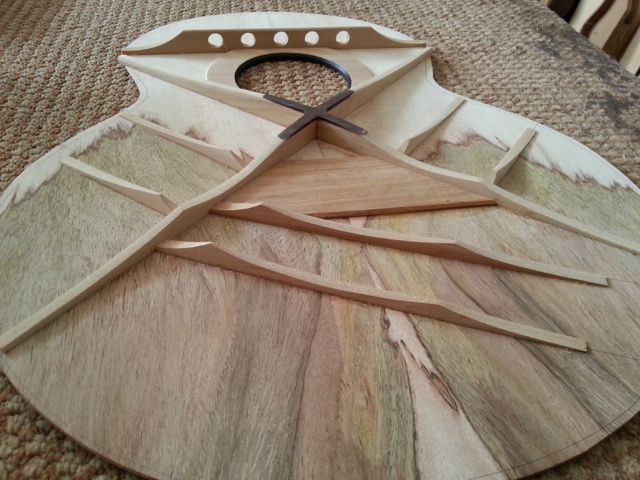

Post by nnickusa » Thu May 30, 2013 11:34 am
No dramas with mine so far. Bends easily, but doesn't want to hold it's shape too well, so it stays in the mould all the time...I sand mine on the homemade jobby I have and it was easy. Feels kinda "waxy" if that makes any sense, but glues well with tiebond, and the back is to die for....

Post by nnickusa » Thu May 30, 2013 12:10 pm
It's not spalted, but it still looks nice.....Got a mate who saw this set and asked if I wanted a section or two from the trunk of a Biggie he's taking down soon.........

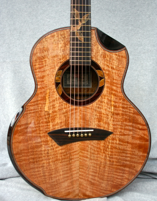

this mango guitar was a hit at the recent Tokyo Handcrafted Guitar Festival.

inoz

Very interesting Jeff.
Will the fretboard and headstock have leaf inlays to keep with the theme?
Please post some progress pics.

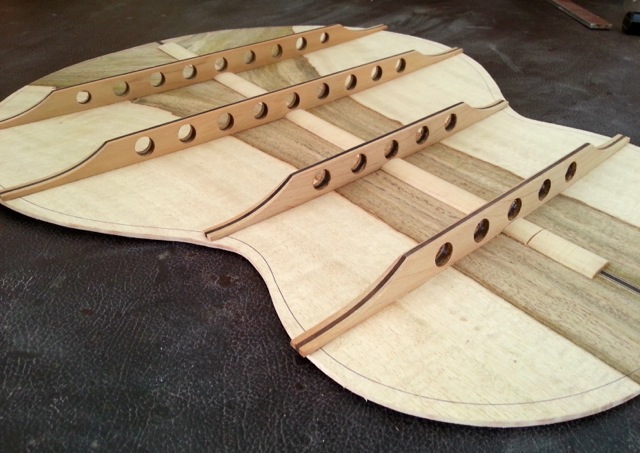

did the rosette today

P Bill
Posts: 521
Re: Mango wood? Any good for instruments?
Post by P Bill » Tue Jun 04, 2013 7:19 pm
Outstanding Jeffery. Outlaw tonewood indeed.
