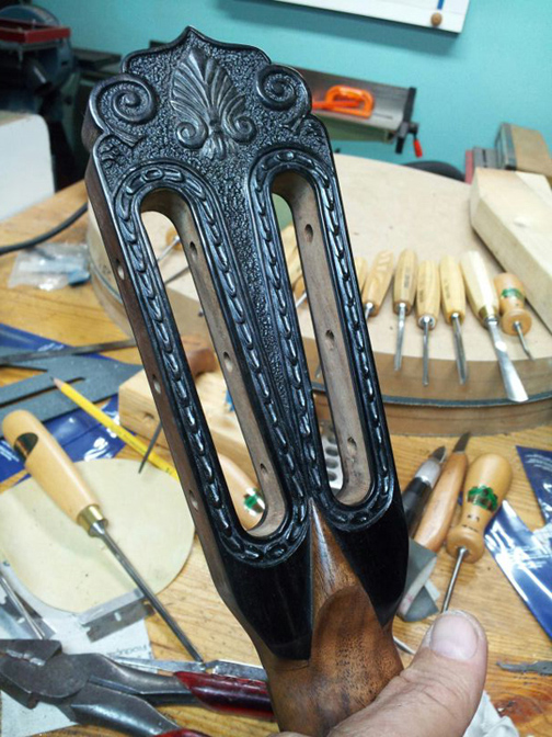

Just finished it up. Low relief in the influence of Weissgerber Guitars carvings by Paul Uhlemann.

So did you break your camera Chris

Wow! Chris
Realy nice job do i dare ask how many hours work there.

Don't really know to tell you the truth. I worked on it mainly on the weekends and not every weekend. Spend a lot of time looking at stuff for design ideas and watching carving videos and getting tools together and etc. Maybe 50 hr. or more carving but you have to understand I'm pretty much learning as I go.

That's an absolute cracker Chris. What are you going to do on the other side?

I thought the other side was done, that's why I asked Chris if he had Brocken his camera.

Looks so great as if you never had done something else than carving headstocks.

Nice work Chris, very even and neat carving. I'm sure you are justifiably proud of it.
Re: Finished My First Head Carving
That is very well done. I'm sure you're very proud. Great work

That looks great Chris. A spectacular aesthetic work of patients and care lurking on the back of the headstock. Like understated craftsmanship. Inspiring.

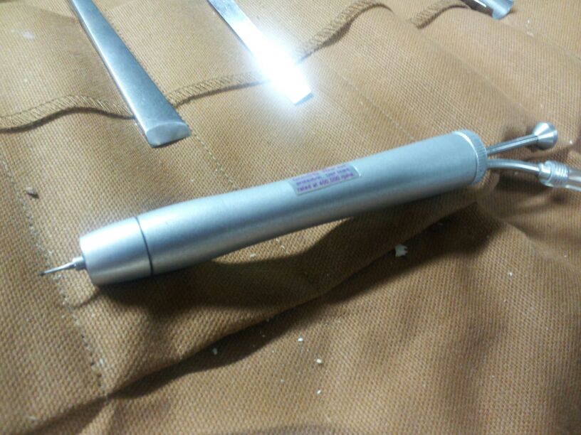

I have looked now a few times at your carved headstock and keep wondering how you did create the "field", the stippled area. Of course (or at least I assume that) you have used some kind of punch, or a shaped nail or similar, but how does the point of this tool look like, and how do you use it? I'd like to learn more about the direction of pressure you applied, and how you advanced over the area - in rows, or by small squares or circles, a mix of all, none of all...
. I'd appreciate a close-up of the tool's point if it is not a trade secret or too much of a hassle to take the photo.
I am asking because I really like how the stippled area looks: not too homogeneous but still not distracting, and it has a considerable "visual depth" (hard to tell from the photo how deep it really is).

Traditionally the background would be randomly just punched with a nail or some type of punch or a specially shaped stippling tool. Sometimes the background would have been grounded or leveled to a depth to make the shapes proud and then stippled.
But I have a pneumatic 400K rpm dentist type drill that is also used for power carving and engraving that I use with a very small carbide ball end bit to do the stippling. Much faster then traditional stippling but I have seen some stamped stippling that I'm assuming was done with a special stippling tool that looked like leather grain, really nice. I use traditional gouges and hand tools for the rest of the carving. I also use some gunstock checkering tools for the straight lines .

Wow, that's some really great info,, thank you Chris. The dentist's tool sounds really almost like a trade secret!
I have to say that your headstock reminds my of those by Francisco Simplicio: he also made the "field areas" in a way that does not look much like stippled with an ordinary nail, he gave these areas a rather fine texture, even less coarse and more homogeneous than yours.
