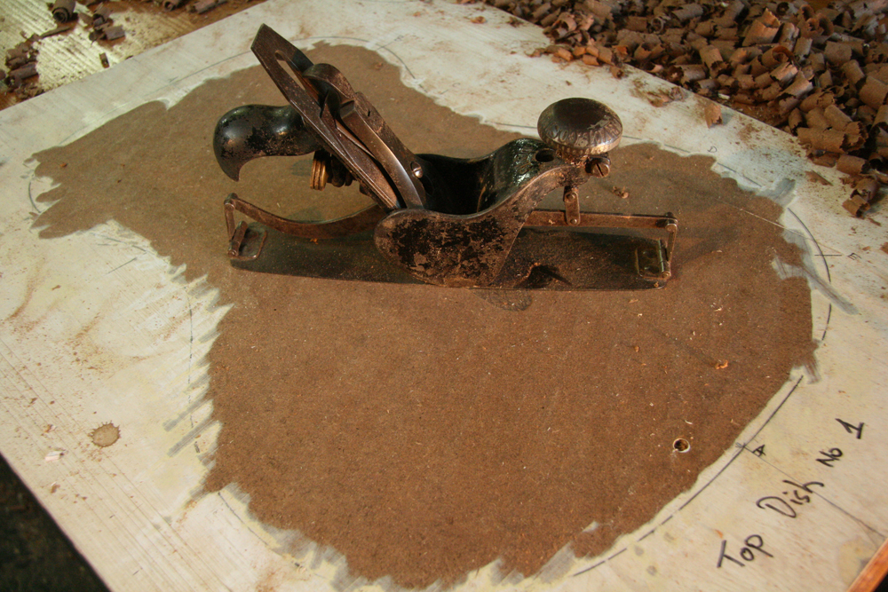

Hi Richard ,
When I did my build, using the Kinkade book I shaped the dishes with the compass plane then fine tuned with a radiused stick with sand paper. There was a bit of a method getting the depths accurate with a feeler gauge and a router first,

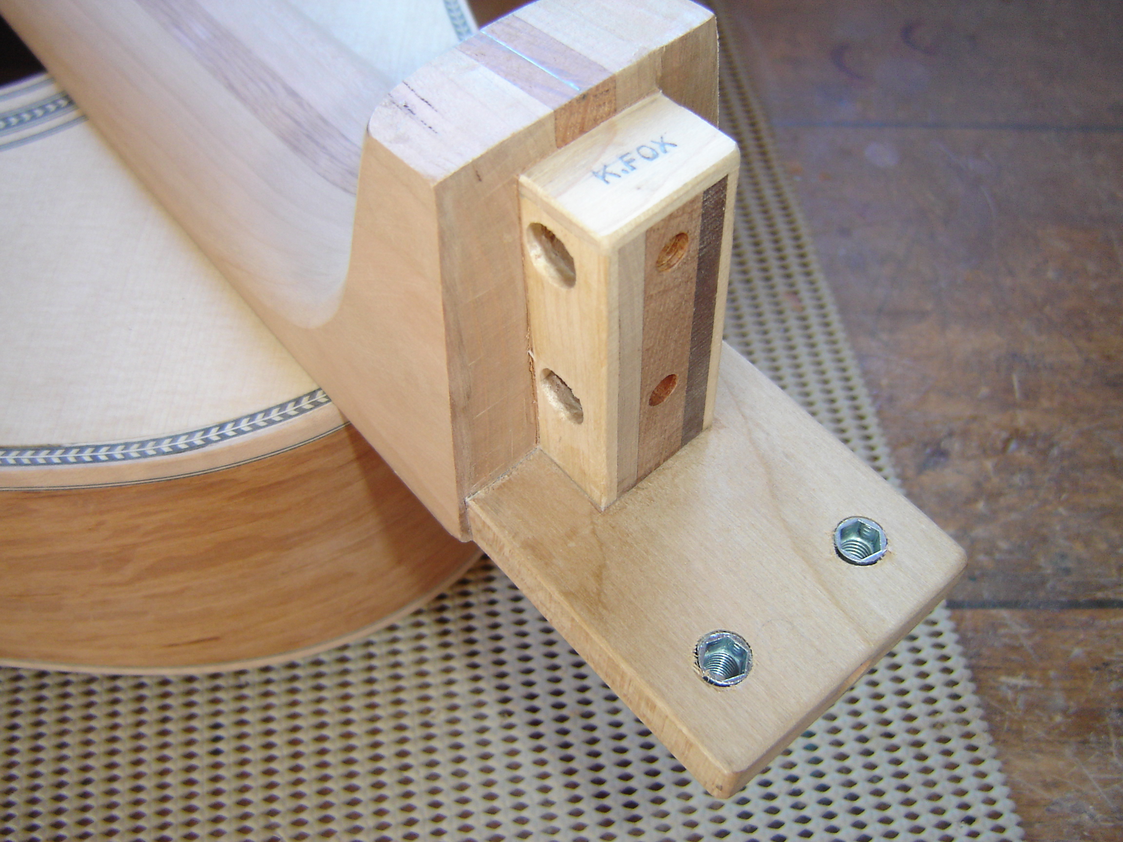

Crafty Fox, any pics would be welcome. How did you integrate the removable tenon with Kinkade's trussrod, or did you use the Cumpiano style truss rod (for which I have the bits). Did you drill a truss rod access hole in brace 'C'. Did you use the revised Cumpiano approach with hardware?

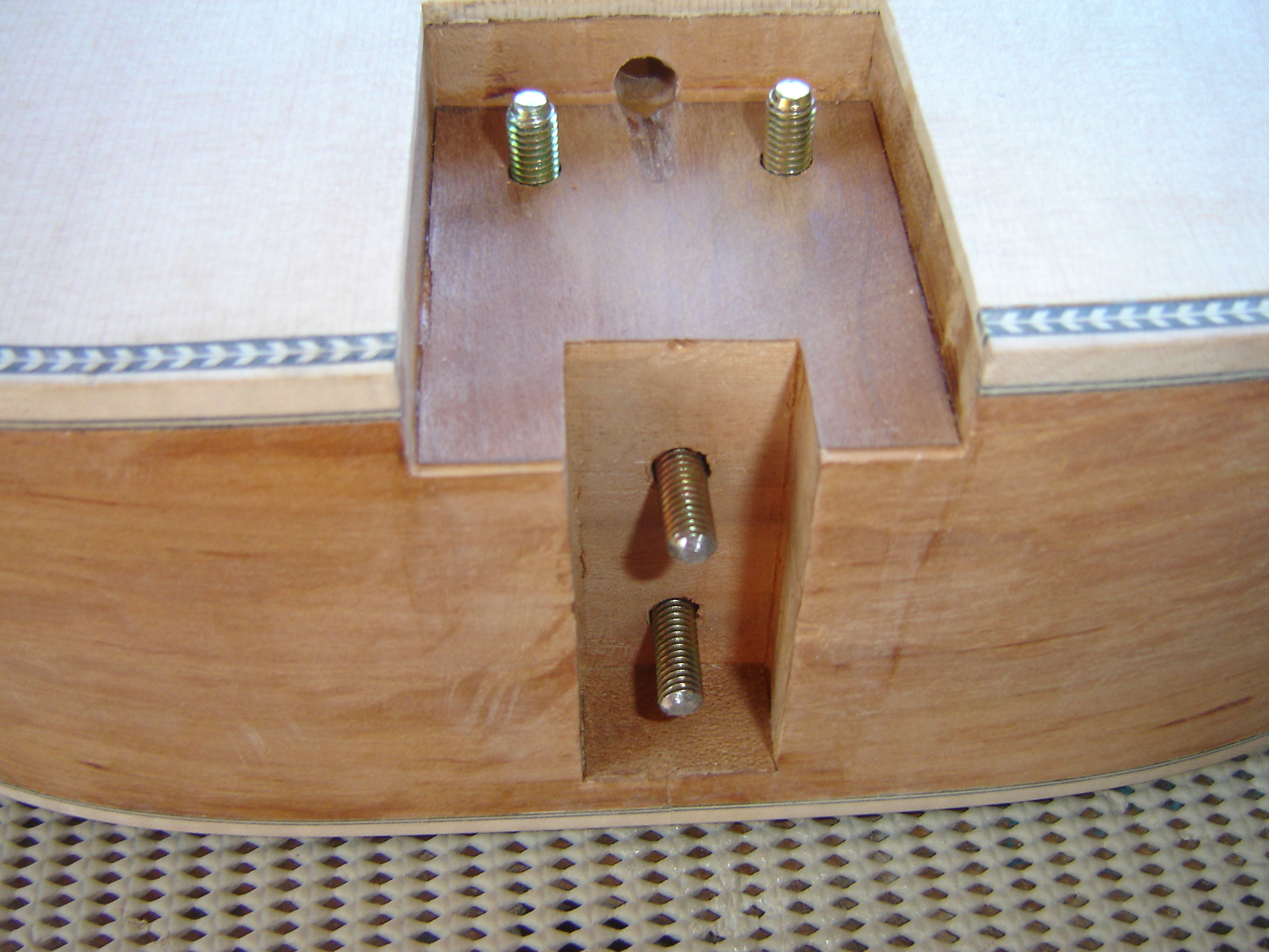

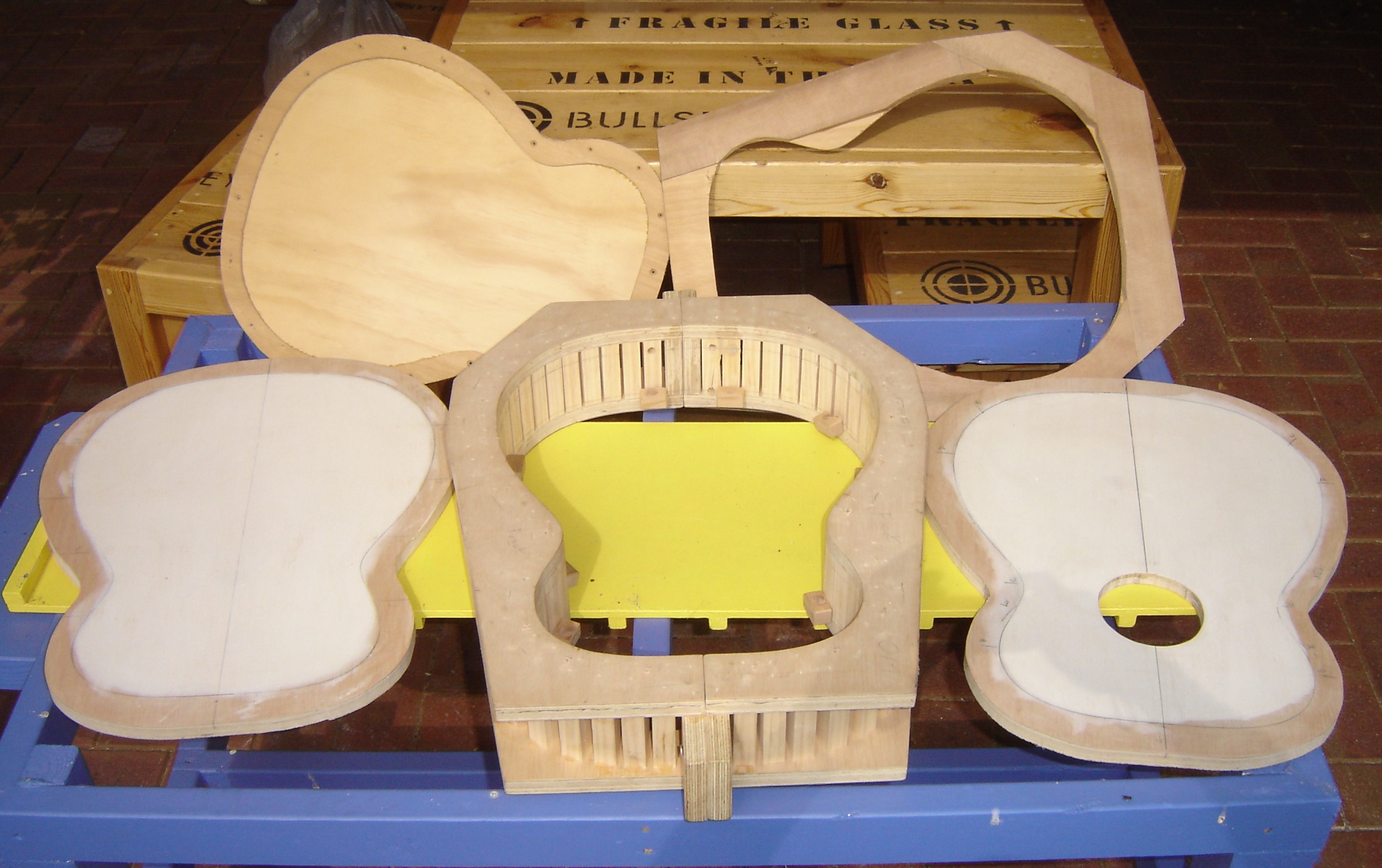

Hi Richard. Regarding the dishes I used an orbital sander on 17mm ply. Went a little deeper than I should've and filled it with a thin gyprock base coat mixed with a bit of Bondcrete then carefully sanded again to correct(ish) contour, and sealed with diluted Bondcrete. Just stuff I have lying around really. I prefer to use ply nowadays over MDF for health considerations. As a carpenter I get to work with MDF more than I like.
For the neck joint I used a hybrid revised Cupiano/Gore method of 2 KD bolts into a neck tenon and 2 more up into a neck extension. So no glue holding neck and body together. I did drill truss rod access through the brace and right through the neck extension and I can adjust with a longer Allen key. I fitted a 14 1/4" StewMac double action Hotrod. I've used them on my previous builds; 3 resonators and a handful of electrics.

Nice work there Ken . I like that outside mold construction in particular . Those little middle blocks look a better solution than multiple layers of ply ( or particle board ,,,cringe )

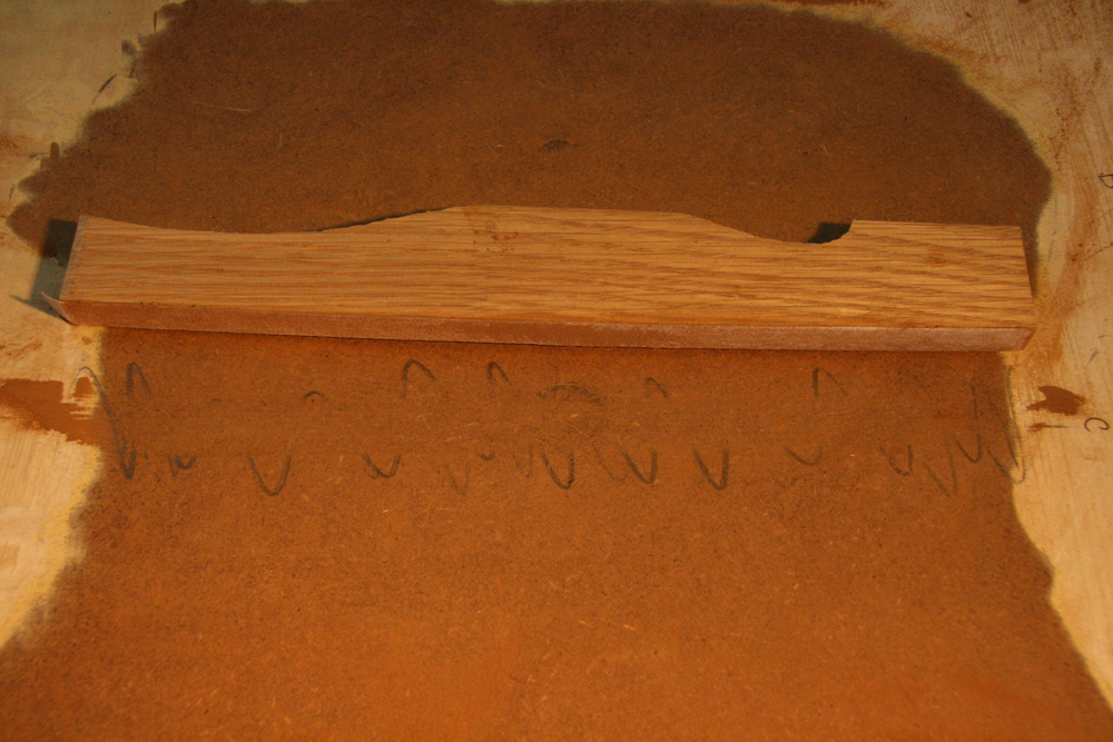

I'm in Wellington. Don't know how often you get down this way but I have a simple jig for making the radius dishes using a basic plunge router. It has rails for 15' and 28' radii. You're welcome to borrow it. Means you would only need a sheet of mdf or ply and a bit of time to make some mess (it makes a lot of dust!). Also happy to catch up if you want to talk about the guitar-making process.

Richard, I'd jump at Shane's offer. Take along a bit of MDF with you and you'll come away with one of the most useful guitar making tools one can have in their workshop.Shane Woonton wrote:Hi Richard,
