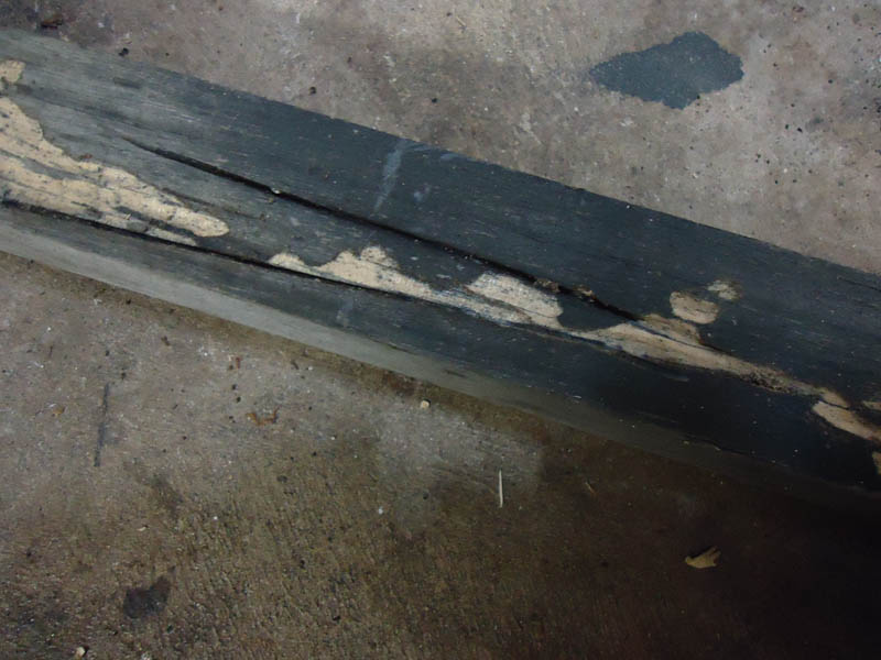

Post by DarwinStrings » Tue Jun 25, 2013 10:46 pm
Here is a bit of Vic Ash, it has been sitting on the ground on iron fillings, no heat applied at all. The termite excavations in it are a few mill deep and there is still bits of stain in them, the stain runs deep.
