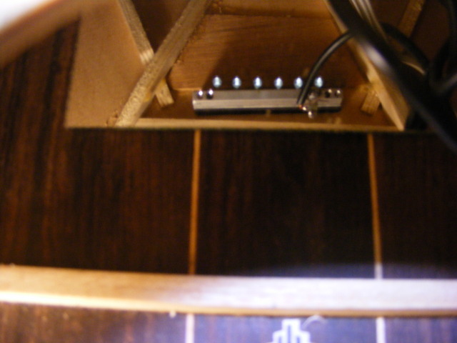

I think I am going to decline this one unless any of you have suggestions.
Cole Clark Fat Lady 2 with a lot of buzz, everywhere I tap on the lower bout sounds "clacky"
No wires in contact with the soundboard, I suspect multiple loose braces.
I suspect it has had exposure to a hot car,but no deformation showing.
With the braces set in machined slots in the top as they do, I can't feel any gaps, other than flooding with superglue, can't imagine how I could repair this without pulling the back off and removing each brace.
Anyone got any experience here or suggestions?

This one is ok on the neck but the soundboard is buzzy, goes clack when I tap it over most of the lower bout.
I suspect it has been in a hot car.
With the braces inset into slots as they are, I can't move them around or get a feeler under them to confirm.
All I can think of is to put it upsidedown and wick in some waterthin CA along the brace?
Any other suggestions besides junking it?

Having looked and felt around a bit more I found that it was the "Face sensor brace", an aluminium bar with sensor which had come adrift.
I rang Cole Clark's service department whose response was "you're in for some fun"
After they described the repair I decided they could have the fun.
However pulling the bar around to feel how loose it was seems to have stopped it rattling when playing the low E for now so back to the owner it goes, so he can send it to Cole Clark when he wants.
