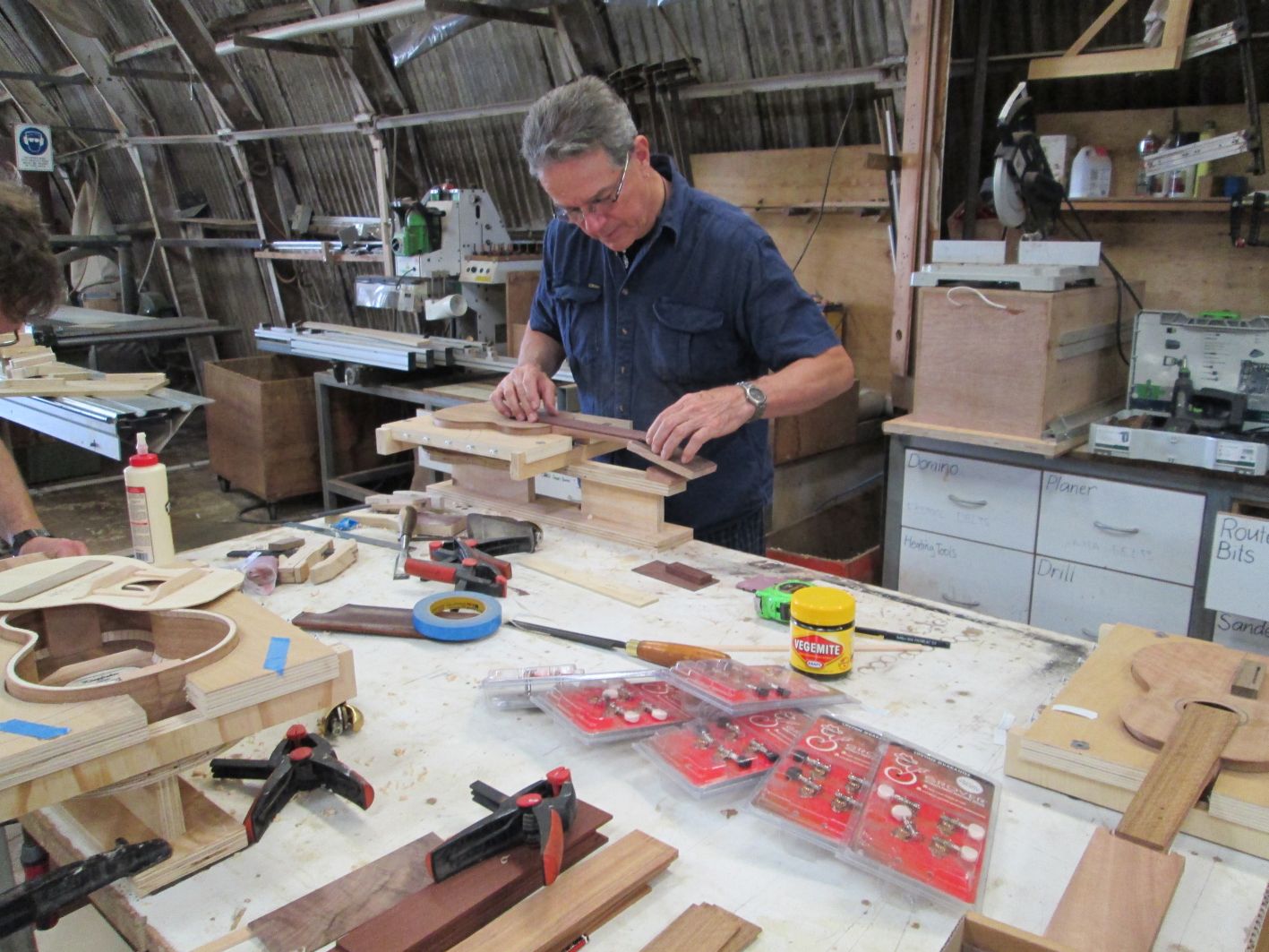

Recently I approached a local furniture make here in Townsville with a proposal to conduct a Ukulele Building Course here in Townsville. Kingfisher Furniture is a family owned business managed by Joel and they make very fine furniture. Joel has an excellent knowledge of locally grown timbers and knows how to use the large array of woodworking machinery setup in their workshop. Joel is also a wiz when it comes to making jigs and working with wood. Although he mostly uses the big machinery in the workshop he also loves to use well tuned hand woodworking tools. We are both building an instrument in the course and it is Joel's first ever musical instrument. I said to him be careful that building musical stringed instruments is addictive and he said too late, he is hooked already. We have been working together over the past two months setting up our course to build a concert ukulele. The course is designed for people to build a concert ukulele without high level woodworking skills. The course started two weeks ago with six participants and we are up to speed so far although both weeks have gone an hour longer each week. Although it has been a fair bit of work it has been very enjoyable and a great deal of fun for everybody.
Here are a few pictures and there will be more details and progress information with pictures in the future....

Looks like you guys put together a really well organised course Alan and in an awesome workshop to..

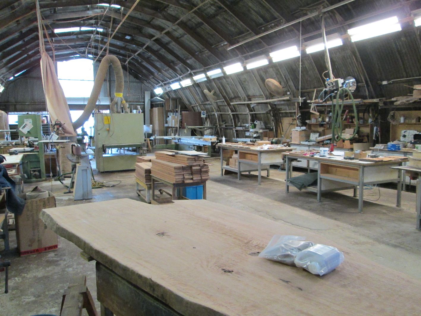

Nissen or Quonset?

Trevor: Sorry mate, I don't understand your question. Is it something to do with machinery brand or model?

I think he might be referring to the shed.Trevor: Sorry mate, I don't understand your question. Is it something to do with machinery brand or model?

Ahhhh....The shed used to be a soft drink factory in a previous life.

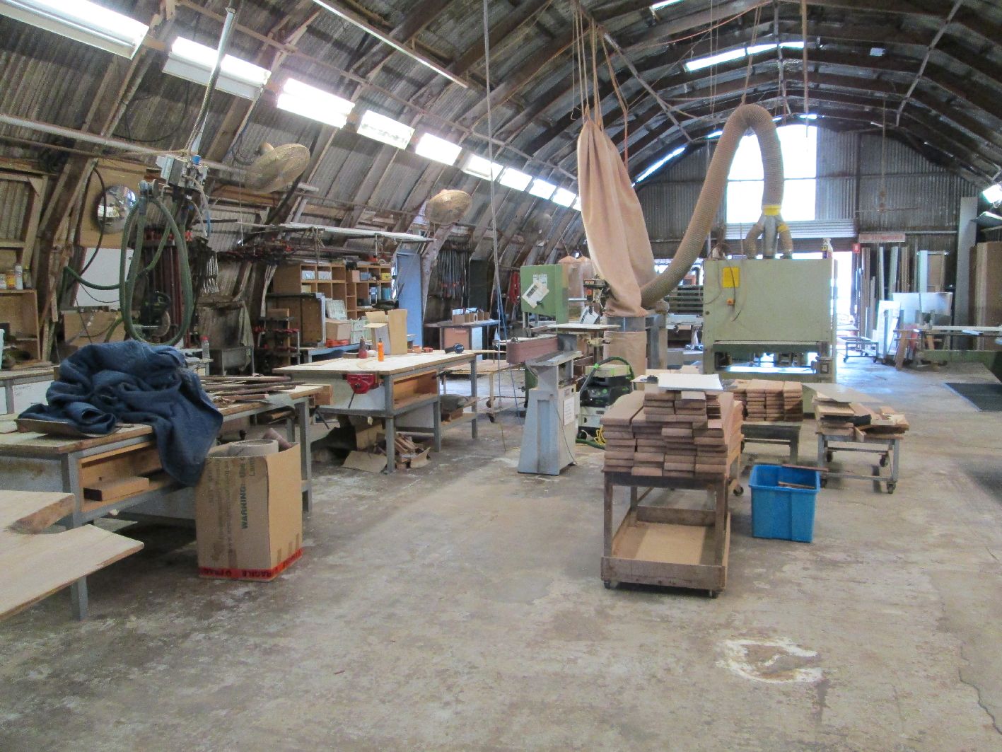

Goes with the moniker I suppose. Both Nissen huts and Quonset sheds were pre-fab buildings used by the armed forces in WW1 and WW2. They were semi-permanent building that could be erected really quickly. The Nissen huts were the original pommy version, designed during WW1 by Major Peter Nissen of the Royal Engineers. Spans up to 30 feet and as long as you like. The ones I was used to were smaller and tended to have bricked in ends. The Qunoset hut was a development of the Nissen hut by the USA army, built originally at Quonset Point, Rhode Island. The biggest was about 40' across and 100' feet long. There's not too many of either type left, these days68matts wrote:I think he might be referring to the shed.Trevor: Sorry mate, I don't understand your question. Is it something to do with machinery brand or model?
Given the size, I'm thinking the one pictured was originally a hangar, but I'm not so much of a shed nerd to be able to pick the type!

By the way Trevor, the shed is a 30mx12m quonset hut.

Living archaeology! Great stuff! Must be one of the very few left, especially in the large size. I'm guessing originally used for servicing flying boats, WW2. Probably has a few tales to tell...timberfreak wrote:By the way Trevor, the shed is a 30mx12m quonset hut.

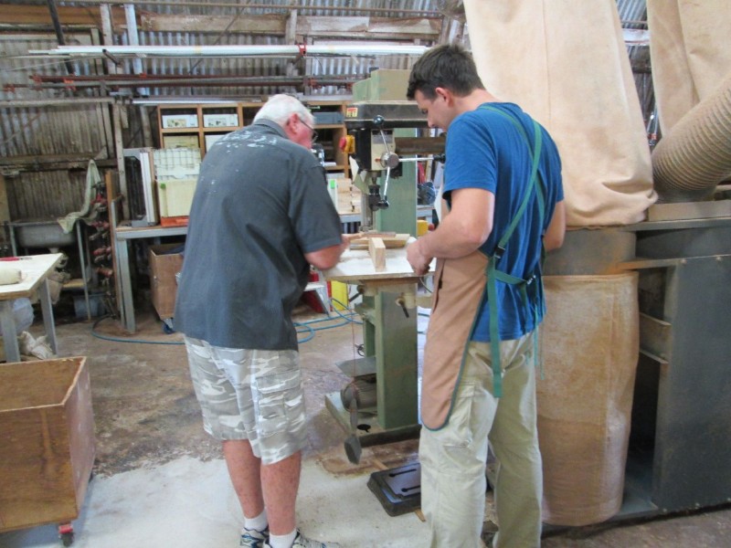

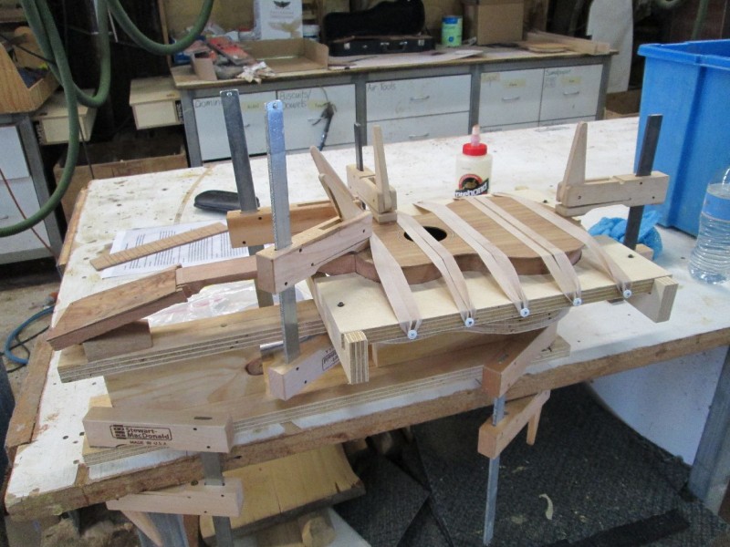

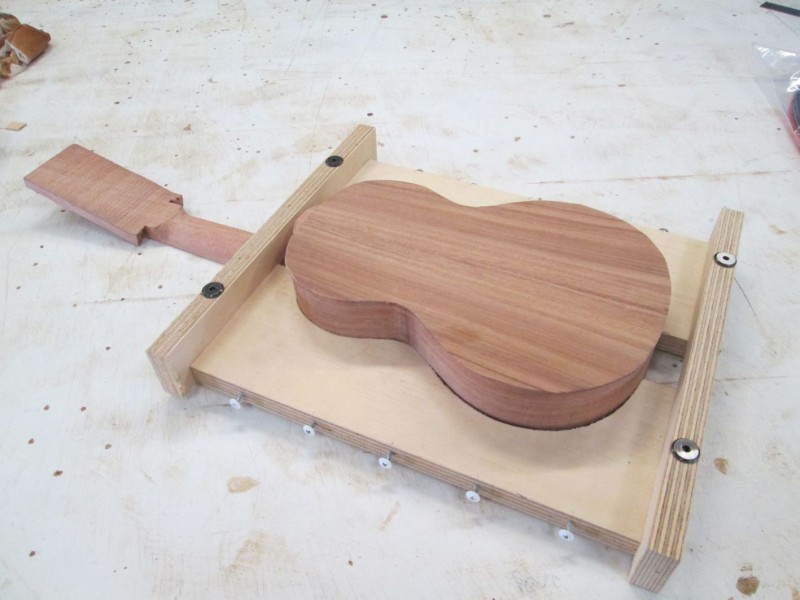

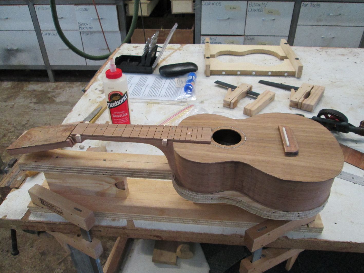

Today we had our third session building the concert ukulele. The humidity was very high here today so we didn't get the top glued on but all instruments are prepared and ready to do so. Good progress achieved again today and we are on track to be finished in the fifth session.

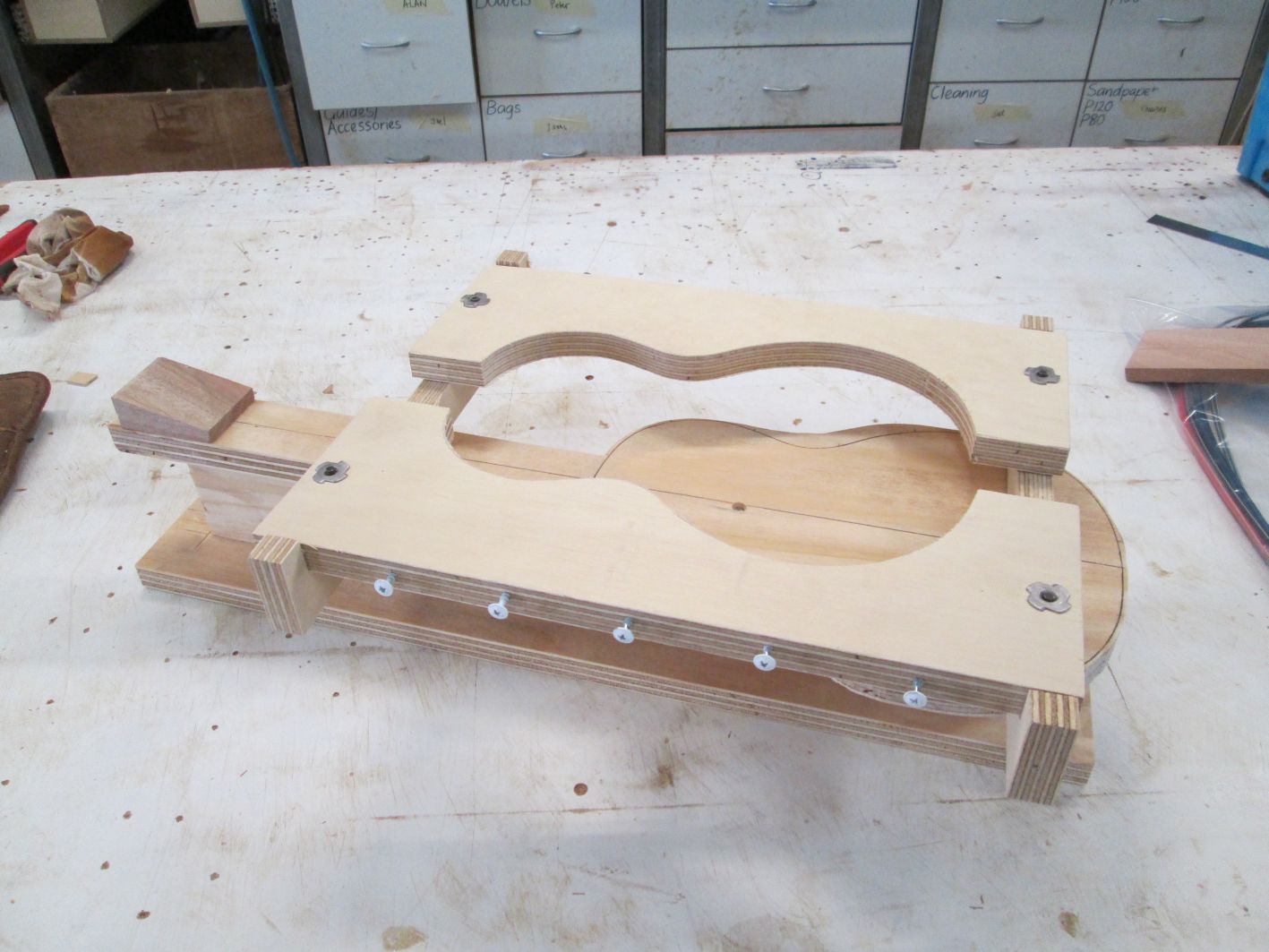

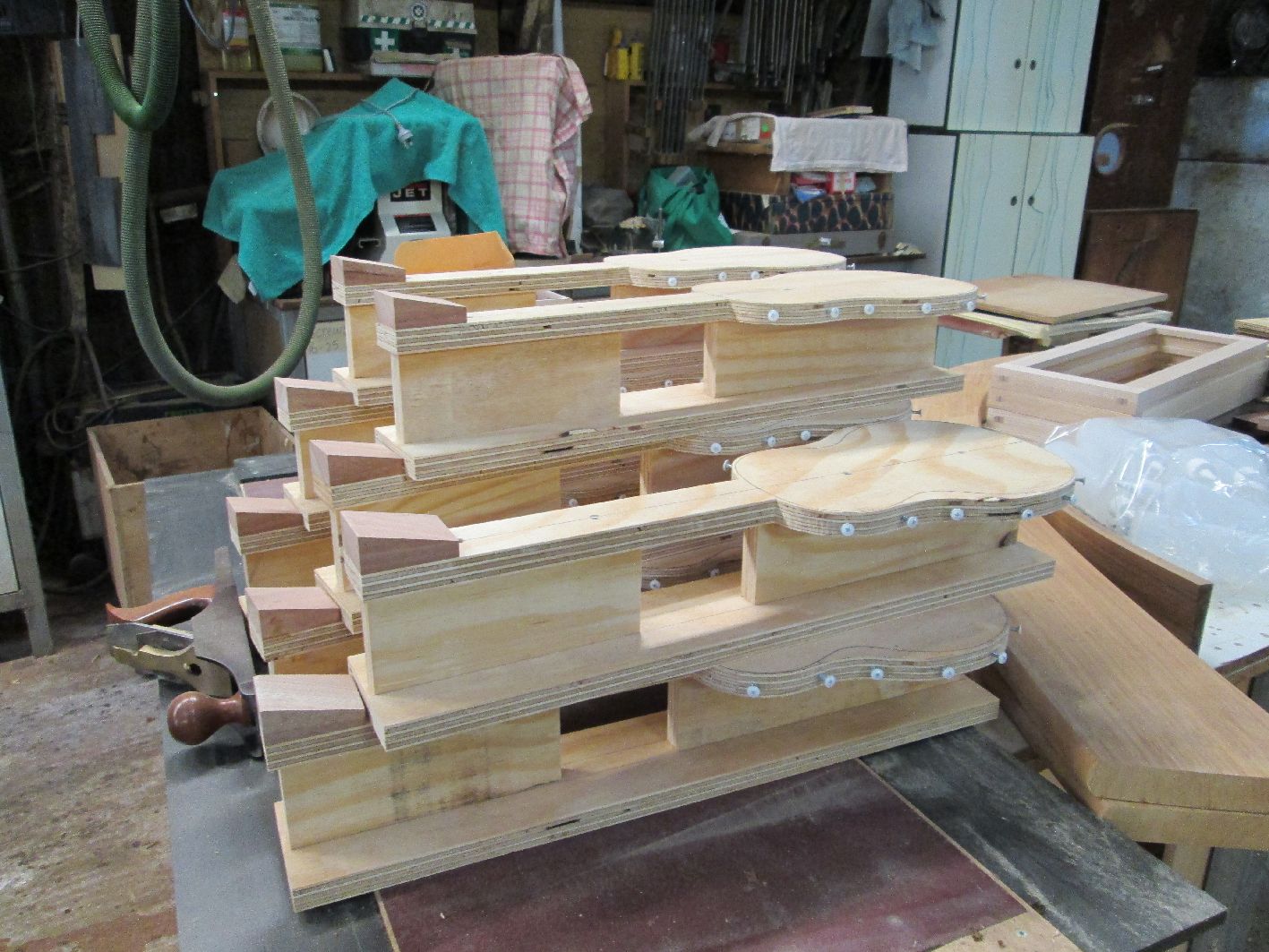

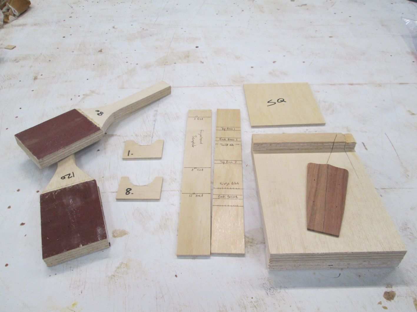

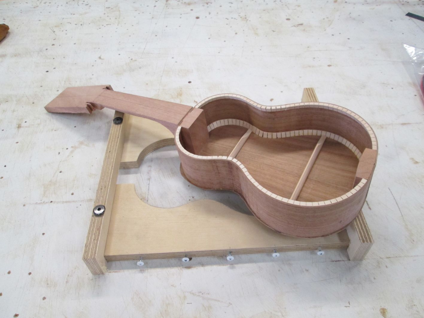

Here are a few pictures of our solera, mould, jigs and templates. The course is to build a kit so sides are bent, neck blank cut out, fingerboard slotted, bridge cut out and saddle slot cut and the instrument is then built using a bench sander, drill press, spindle sander and basic hand tools. We could do without the solera however it is nice to glue top and back bracing and keep the build all lined up nicely.

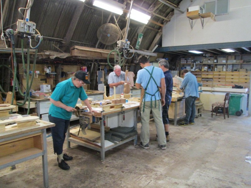

Woods used in the build are Queensland Maple for the neck blank, all back and sides are Black Wattle Acacia, Silkwood, Silver Ash, Black Wattle and Queensland Walnut tops. Fingerboards and bridge material we have Black Wattle, Gidgee, Jarra and Blackbean. Peg head we have a nice assorted box of goodies with some interesting figures and colours. We are using Sitka spruce for bracing and kerf lining. A very simple rosette and end graft of black white black purfling. Stew Mac has done well providing the Grover machine heads and we have some buffalo bone for the saddle and nut. By the end of next week we hope to have the box closed and the fingerboard fretted and glued down.

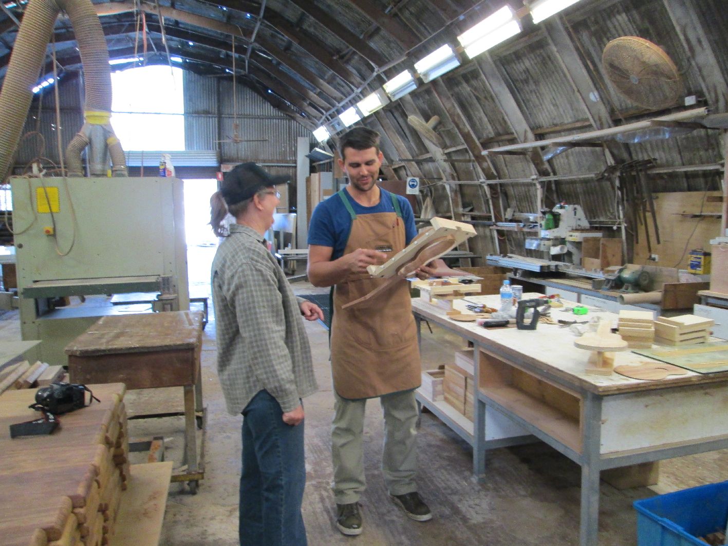

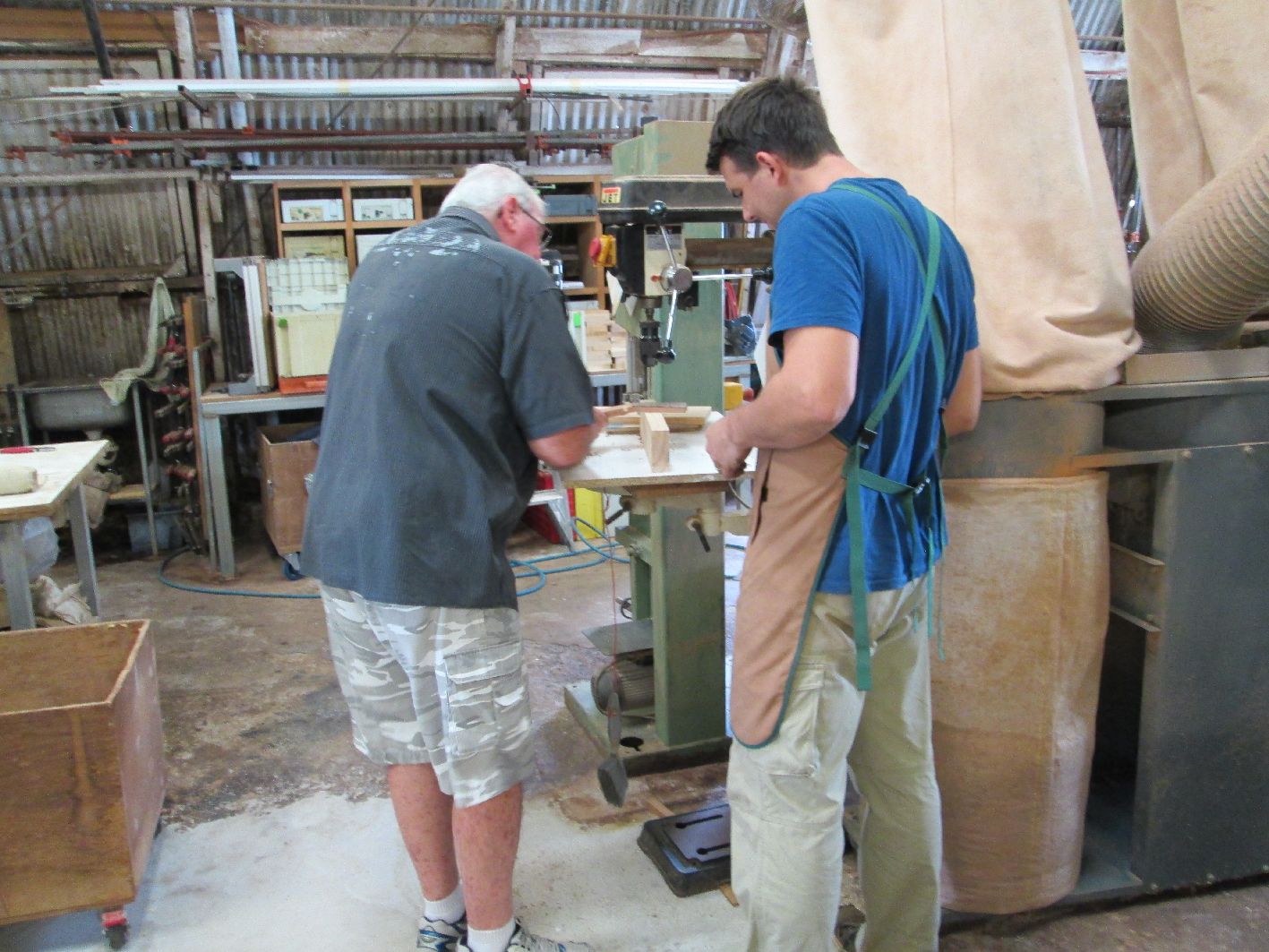

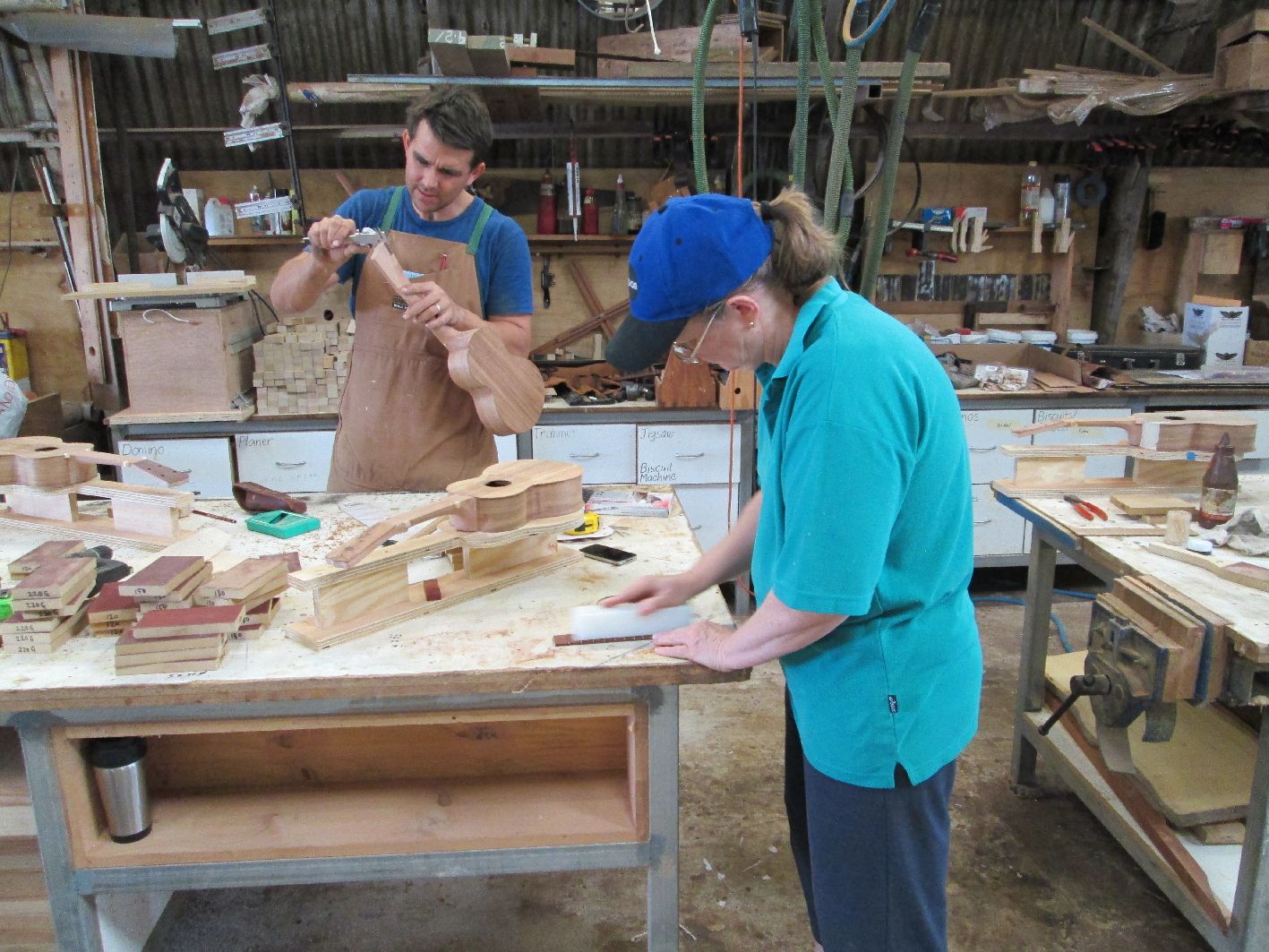

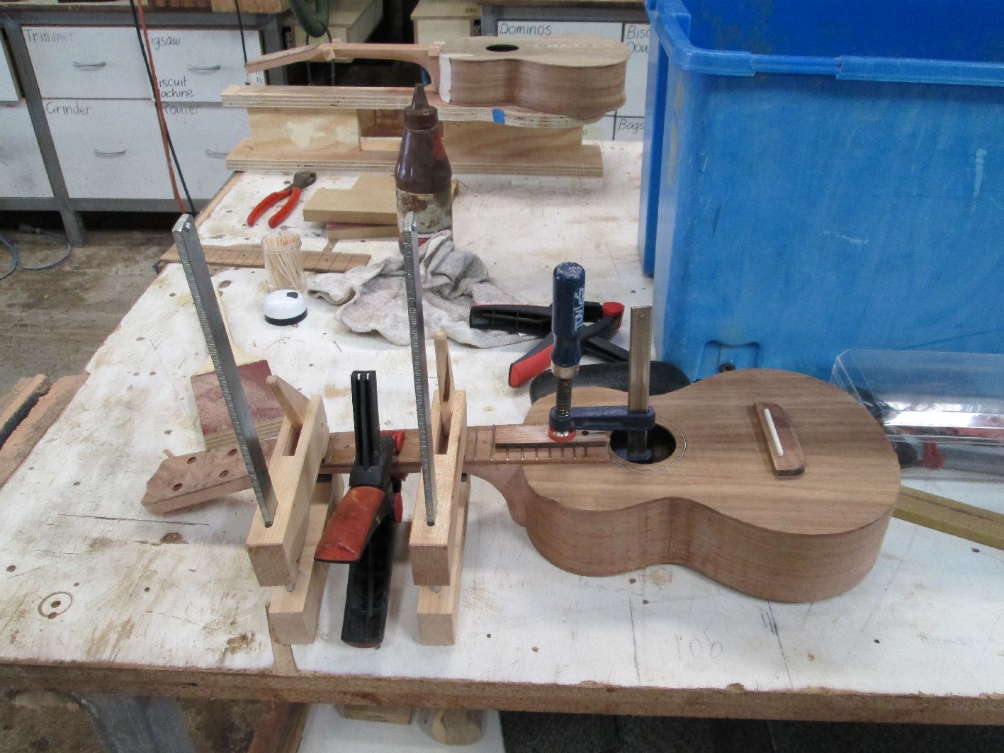

Here are a few pictures from today's four hour building session and thanks for looking.
Someone asked was there much work setting it up. Yes!!!! The next course will be a breeze.
Thanks again to Michael for his time and help.

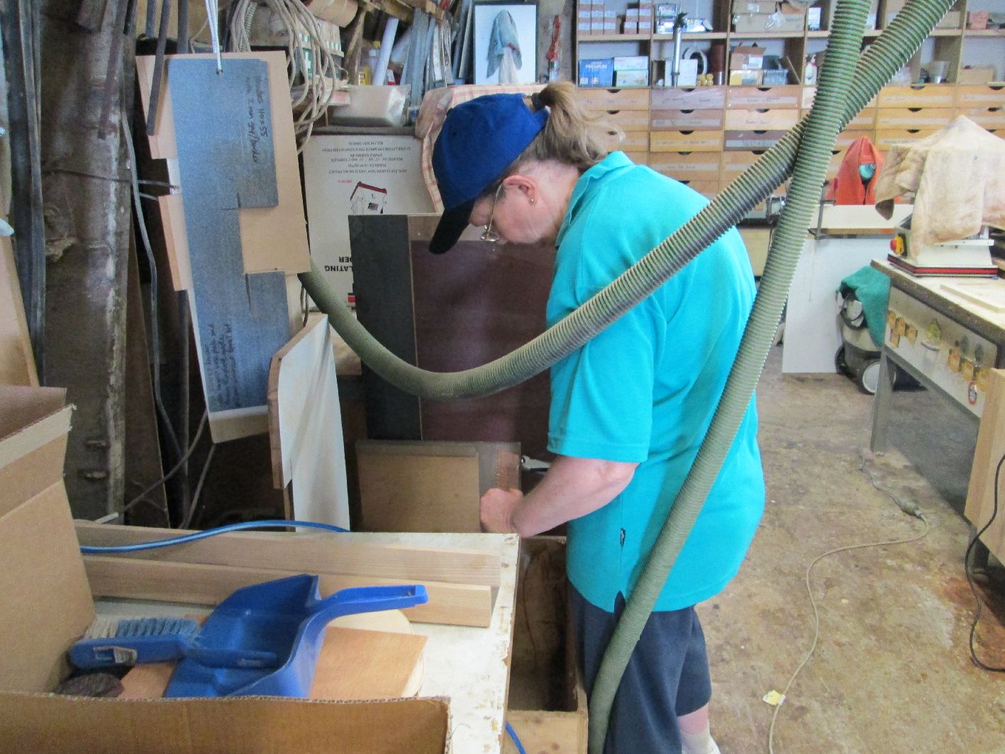

By the way Sue drilled her dot inlay holes perfectly although it looks like it was a major Job!

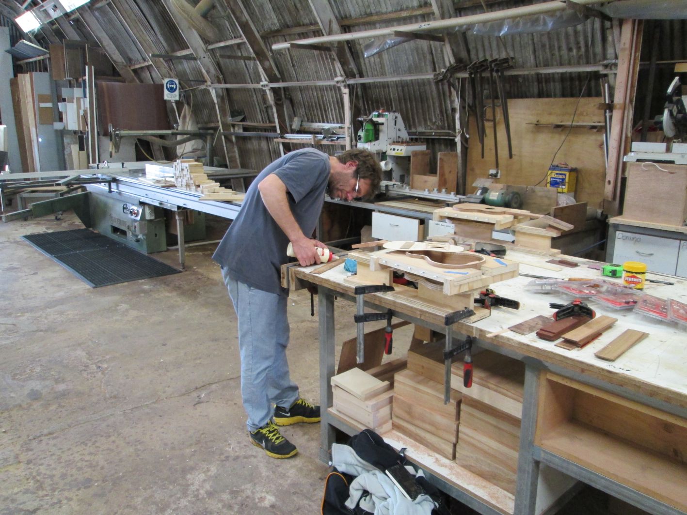

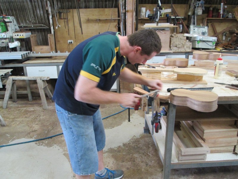

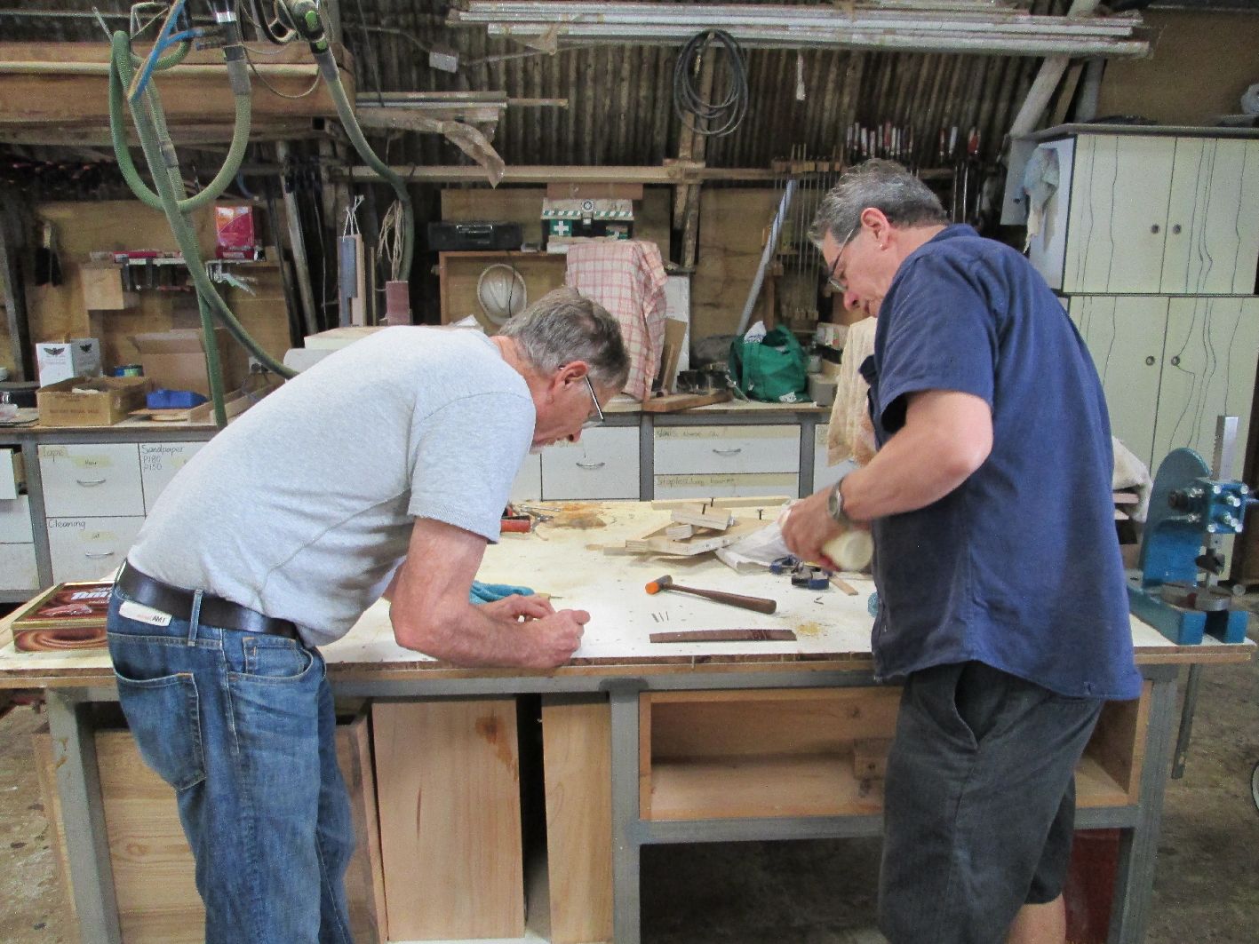

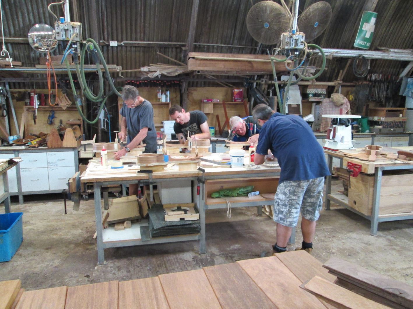

Week four and we are a little behind. The instruments should be ready for finish by the end of next weeks session. Looks like our first course is going to be six weeks duration.
We had a visit from Bob for Murray Bridge in SA to the workshop on Saturday. Great to meet you Bob who is a ANZLF forum member and thanks for lending some of the students a hand. We managed a good long chat after the building session and it was another fun day. I was worn out though!
Here are a few more pictures. We managed to close the box as it was 50% humidity around 11 am.
Good progress was made again by all!
Thanks all for your interest.

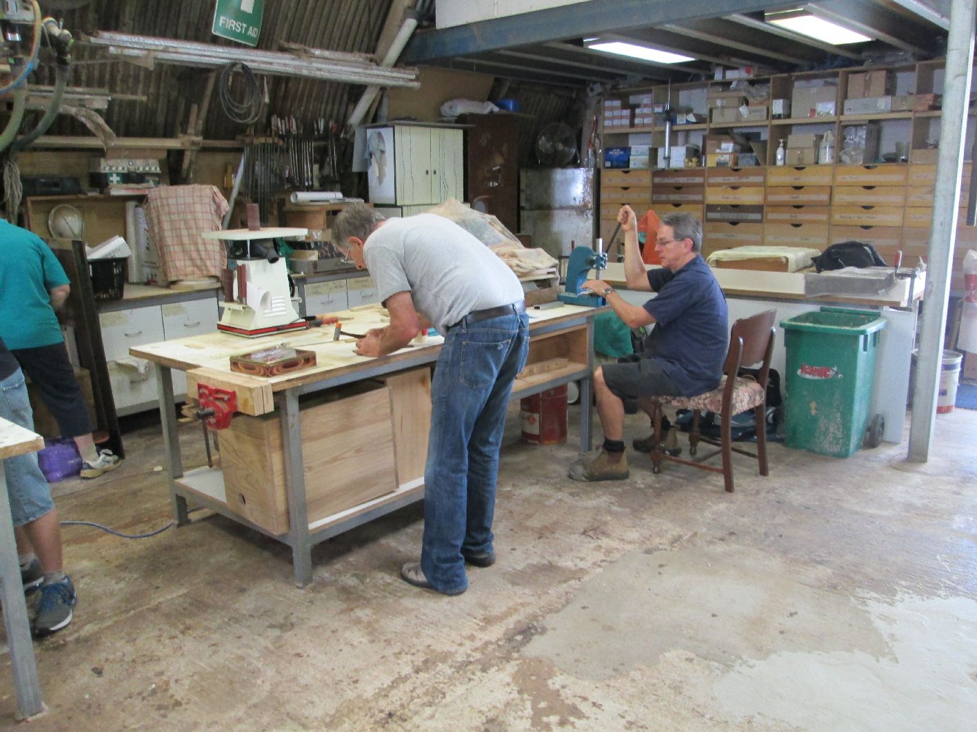

Saturday we had forum member pappygreen, Brett visit the workshop and he too was quick to lend a hand to our students. I am very lucky to have so many friends and experienced guitar builders who are interested in our course and prepared to give up their time to help out.

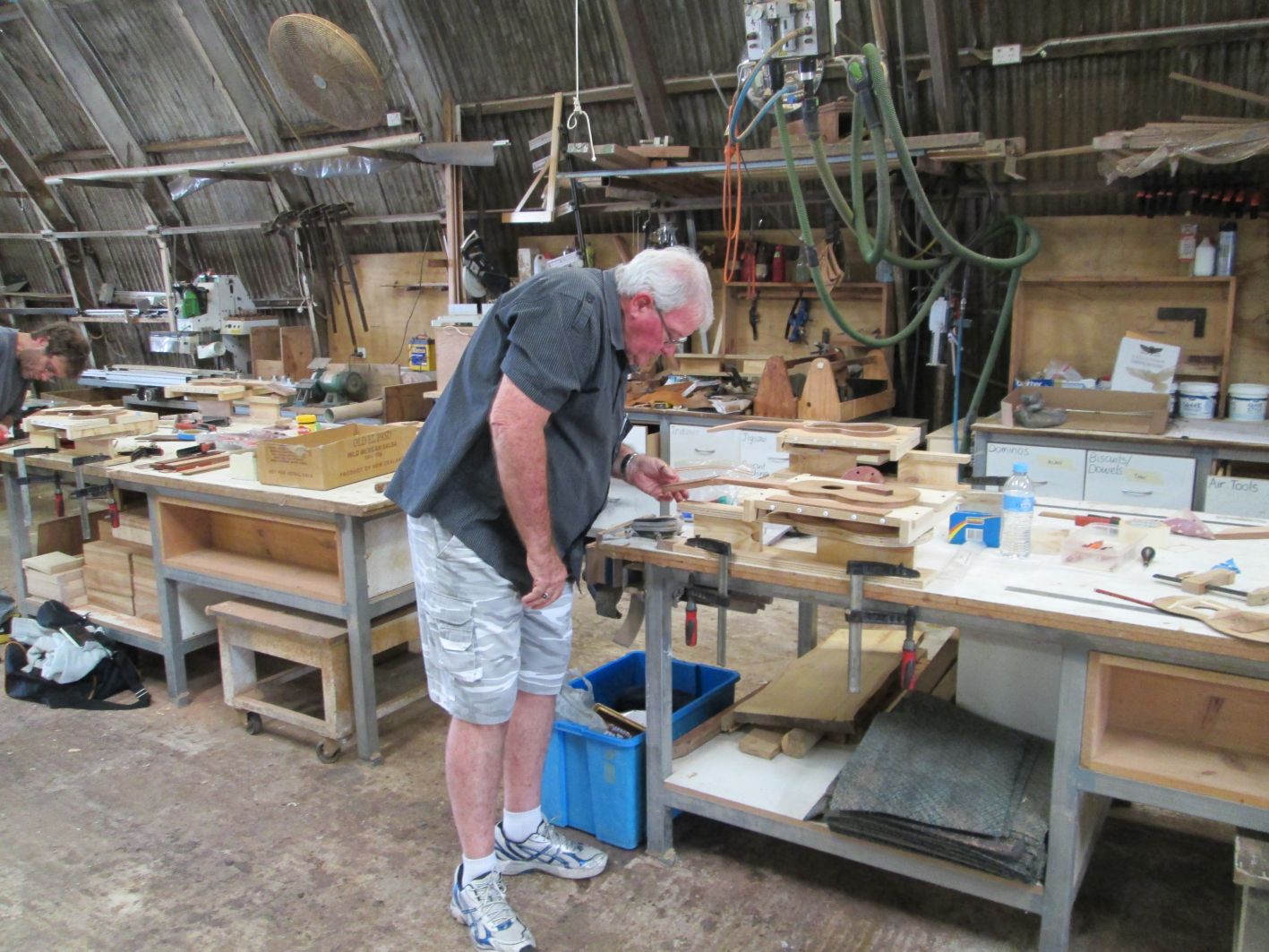

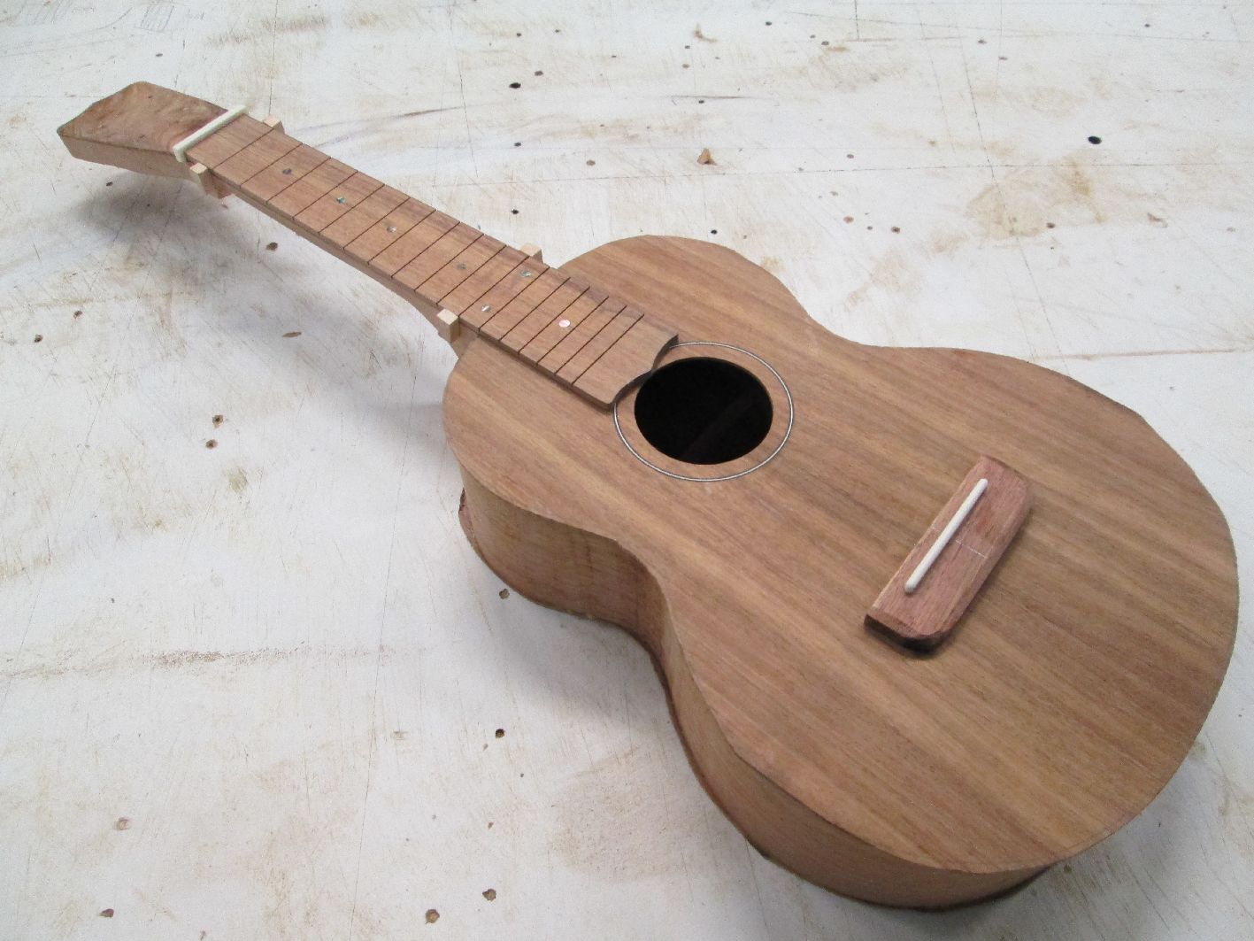

Almost finished. The students where sent home with their instruments to do a final sand during the week. We just need to mask the bridge area, apply a few coats of shellac to seal the instrument, install machine heads and setup. We were well organised today and progressed along nicely. There were a few building challenges that popped up that we had to address but nothing that could not be solved with little stress.
Some more action shots for you:
To be continued.........................
