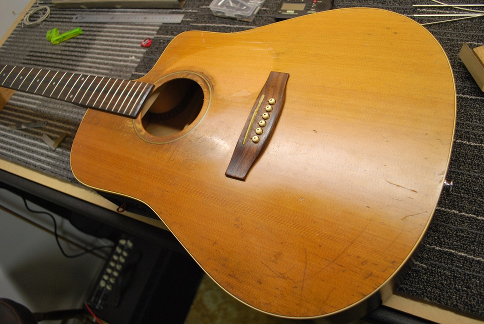

Got a costumer who brought a Seagull acoustic guitar in last week. He needed a setup and wanted a clean and refinish on his top. He wore out the soundhole to much to just cover it up with a new scratchplate, so we decided to do some little "restoration" on this one.
I didn't have any of my old scrap wood / left overs, but luckily Woodrat has been so kind to send me a few pieces of cedar! We are eternally grateful for that :cl
The plan is to:
- give the top a light sand (Seagull doesn't use heavy thick finishes), use a little water to take out small dents/scratches.
- route out the top bit of the worn out soundhole bit and glue a new piece of cedar on top (will need some custom jigs for this).
- apply a new matte finish to the top (not sure on oil or shellac. What does Seagull use?).
- There's a loose brace inside that needs reglueing.
- first 4 frets need replacement, so needs fretleveling and recrowning as well...
- New nut, as the old one is way to low...
- and finally the setup where it all started :wink:
I'll keep you all updated with photos. Please feel free to share any thoughts or comments, suggestions, likes or "DON'T DO THAT!!!", or whatever :D
Some pics on the guitar.

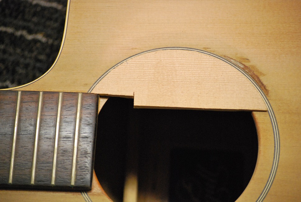

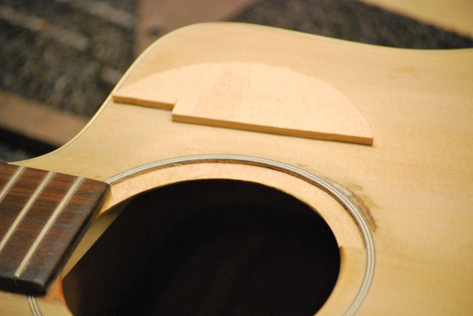

I routed out about half of the top (sorry no photo of the router setup) and cleaned out the wood between the rosette and soundhole.
Made a matching (as good as) piece of inlay (thx again Woodrat!) which will be glued soon!
It may look a bit crooked, but it's hard to take a good photo of it...
