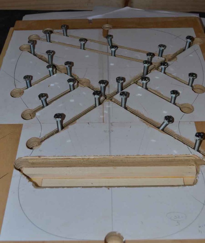

Just some food for thought!

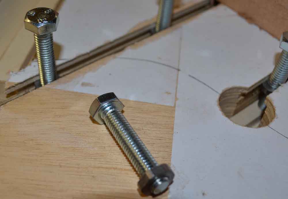

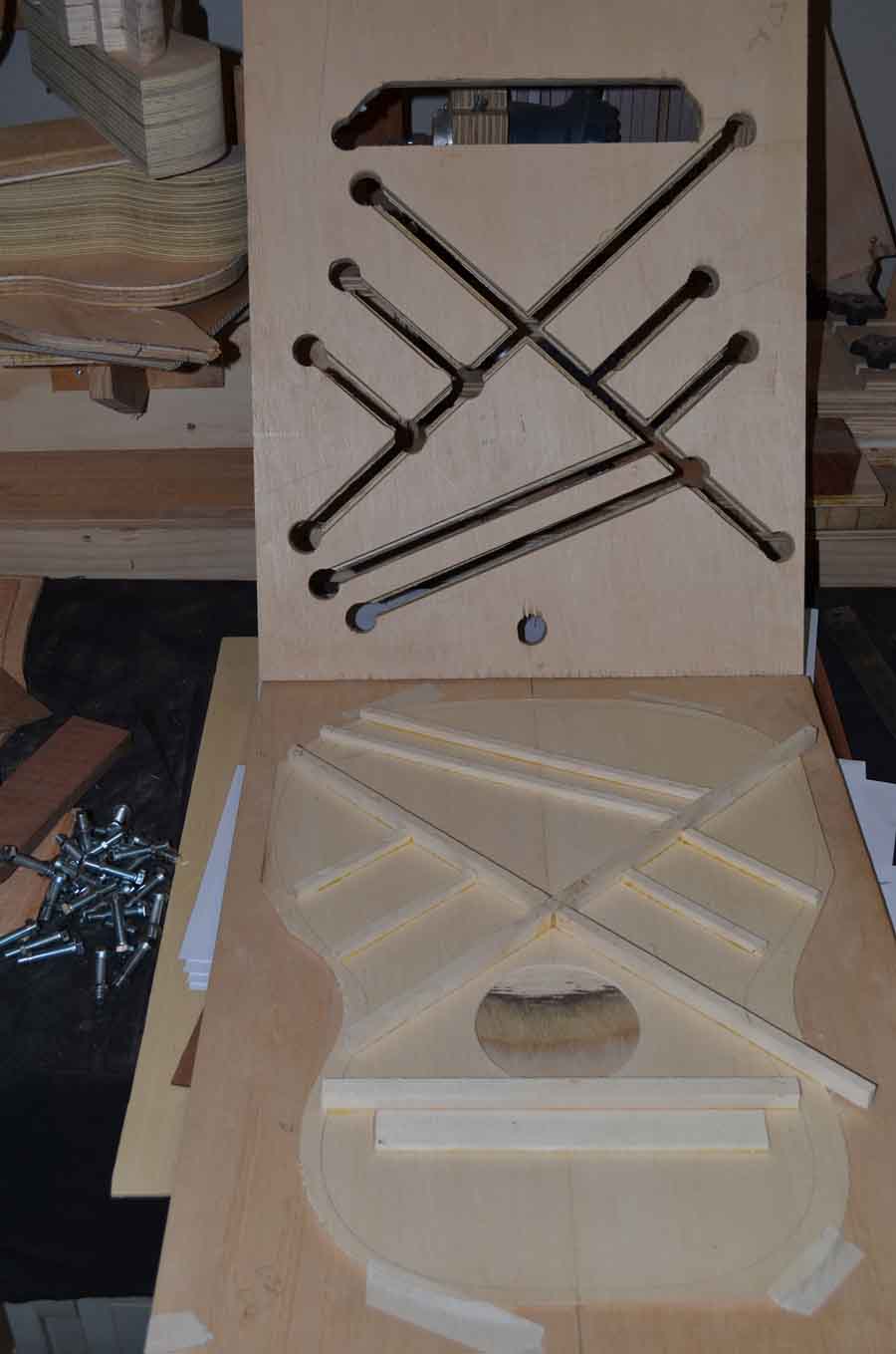

Jig assembly not completely refined but sufficient to do a test run. Alignment of braces will require some making on the sound board but maybe indexing point on the jigs be included. Initially used a t-slot cutter approach for the channels but two different straight cutters approaching the board from either side will suffice. Nuts were turned down slightly to improve channel entry. May have to include a frame that the template and workboard fit into to compensate for accumulative pressure on the template. Will keep you posted!

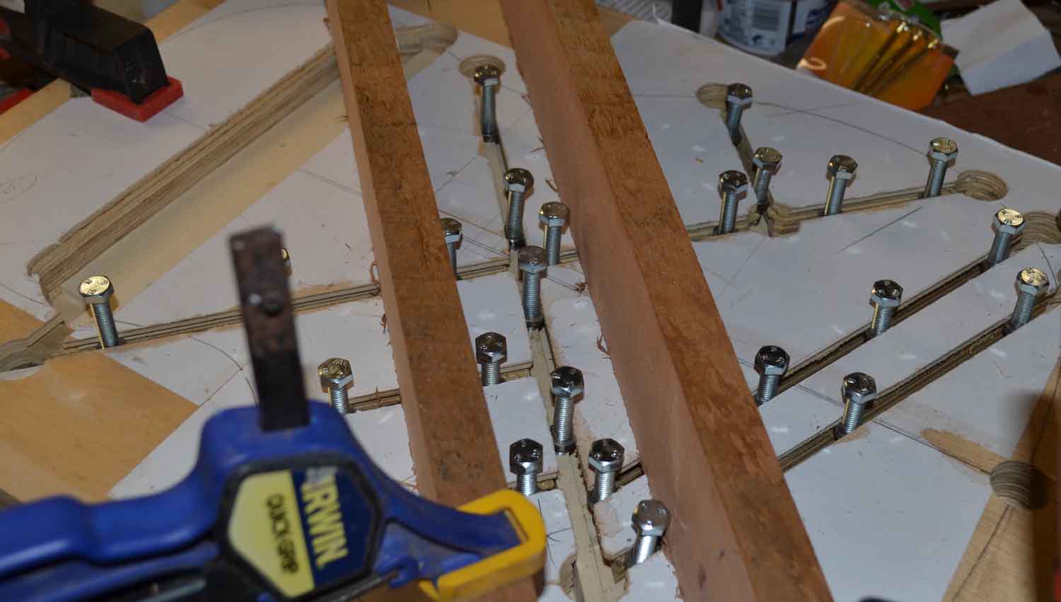

Clamps and braces removed.
Template removed

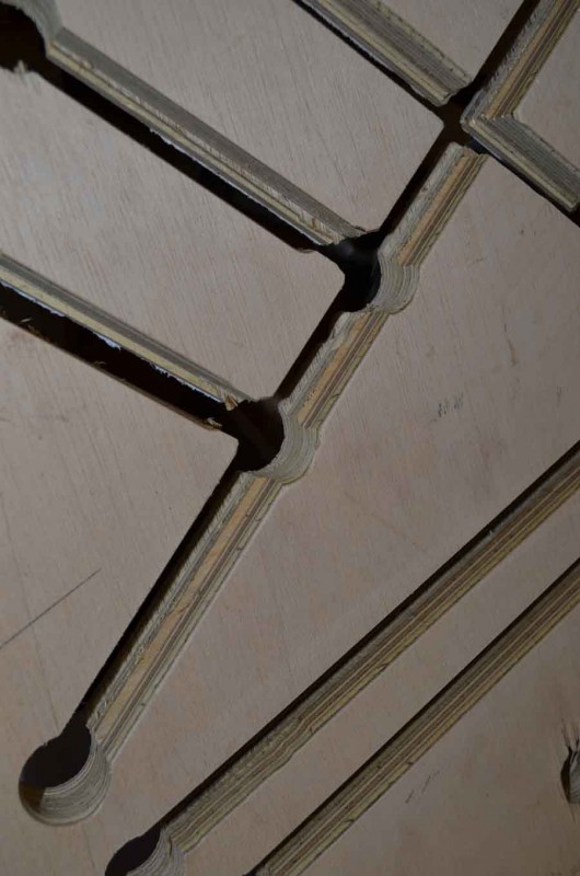

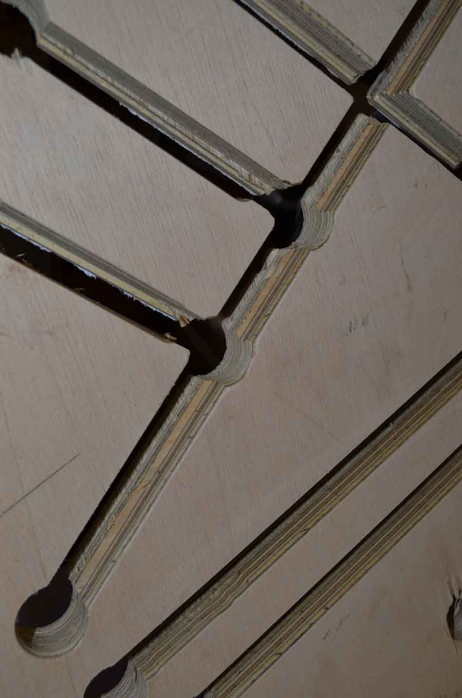

Underside of template

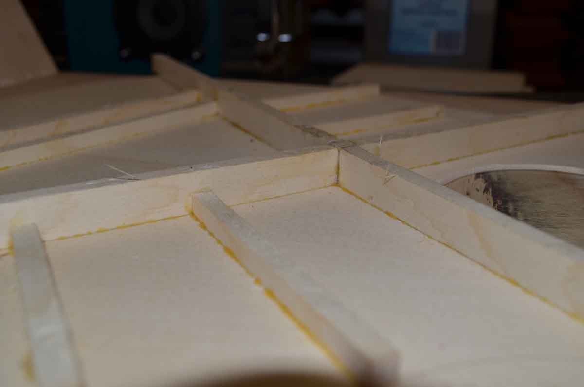

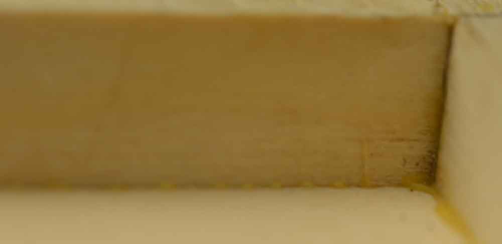

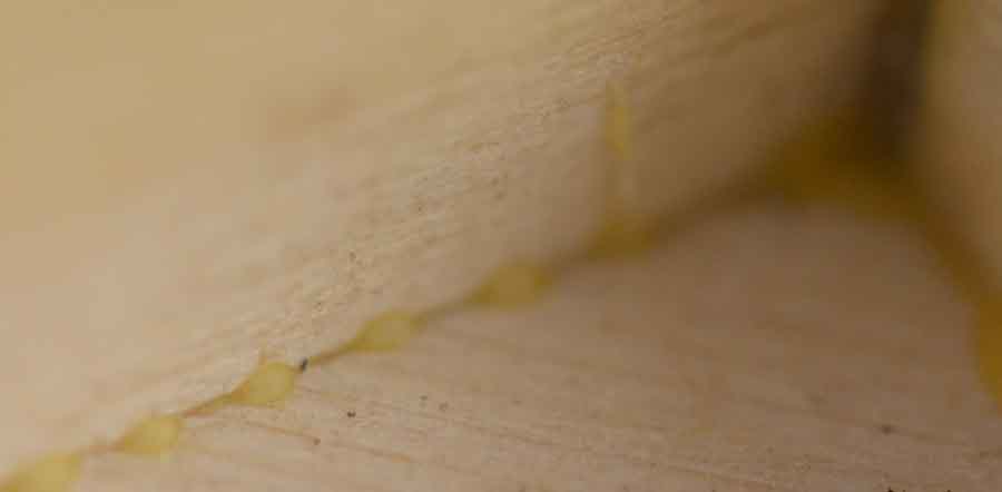

Glue line cleanup doesn't appear to be much of an issue.

I dont make acoustics, but this just seems like a really awkward way of doing things. You mention space for the jig if it's a go bar setup. What is above this jig that limits space if it was a go bar system? And cleaning dry glue is a much harder job, if the excess isnt wiped away when wet. Im sure I can see a gap under the X bar too.

Thanks Perry regarding the X Brace area. However in this case the glue joint is fine. I used my 105mm macro and got down into the contact point (~40 mm) between the brace and the sound boated.

TimS wrote:Thanks Perry regarding the X Brace area. However in this case the glue joint is fine. I used my 105mm macro and got down into the contact point (~40 mm) between the brace and the sound boated.
Looks perfect!
