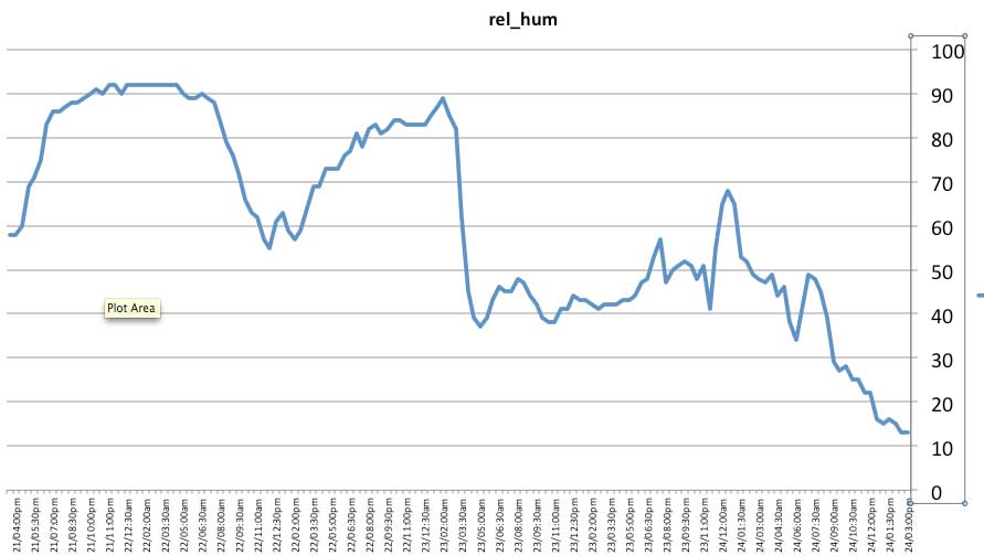

Yep it was 70% relative humidity two days ago and this afternoon 17%.
Not so good for guitar building.

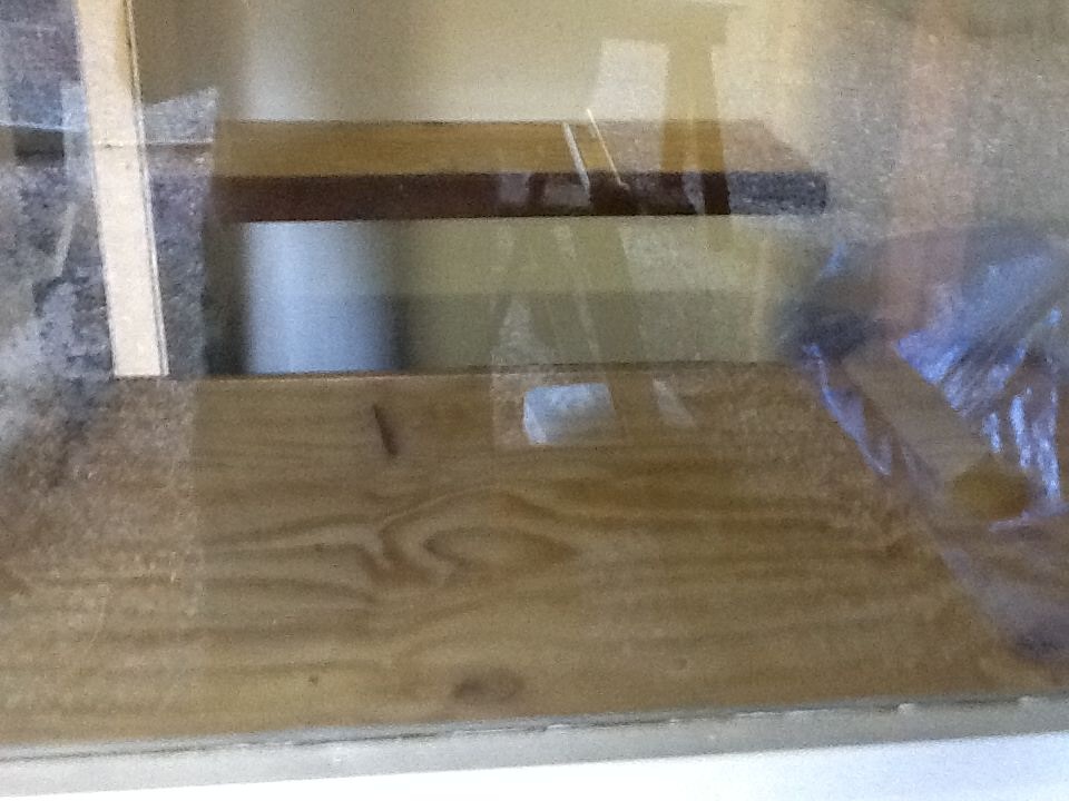

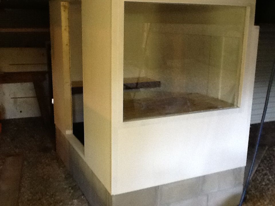

I finally built one. It's 1.2m x 2.1m. I put a bench on either end, and have a door in the centre. I can use both benches as go-bars, and a salvaged dehumidifier has kept the RH at 40-50%.
It's enough for me. I can comfortably build two or three at once, and keep all the necessary bits in the proper environment during the crucial phase. I take them out of RH-controlled environment once the box is shut....
