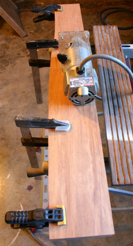

Post by colburge » Tue Jul 30, 2013 2:48 pm
christian wrote:Yeah Jim this MDF is a strange one its chipboard with 2mm veneers of some kind of MDF, its cheap and works well for jigs.
@ Martin, Nick yip we certainly plundered out natives if only they had some foresight and saved it all just for guitars it would be one super asset!!!. If you ever get the chance to see Song of the Kauri its a brilliant doco on this very subject and features Laurie Williams.
This guitar is almost ready for spraying now, so i'll keep updating it with sets of photos as frequently as possible.
Christian.
Is that a 45 degree chamfer bit is the trimmer Christian?
Col
christian
Posts: 338
Location: Bay of Islands NZ
Re: Build Thread: 000 Koru kahikatea/Heart Rimu.
Post by christian » Tue Jul 30, 2013 3:01 pm
yes a 45deg bit.
Christian.

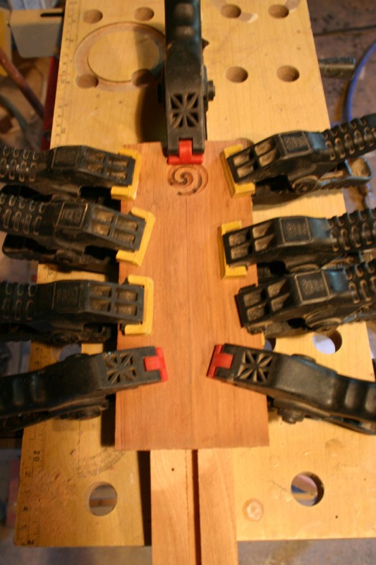

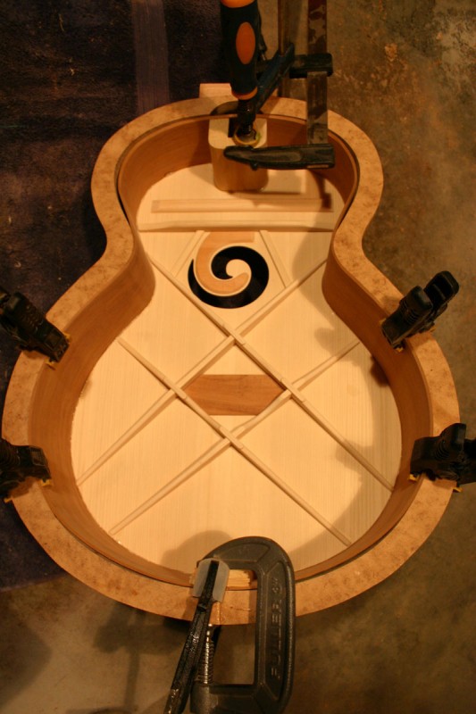

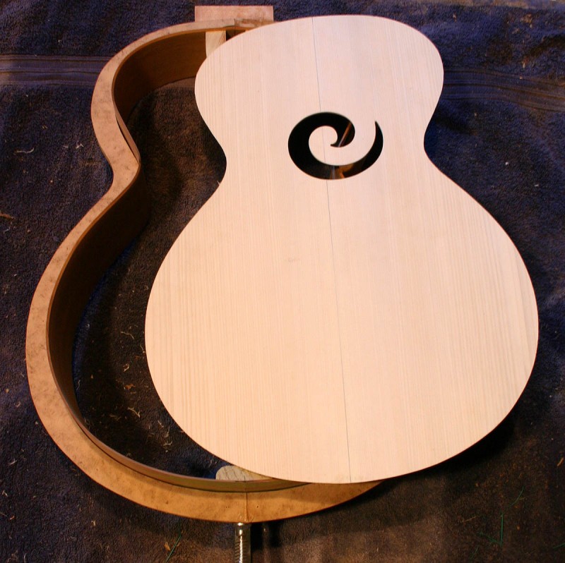

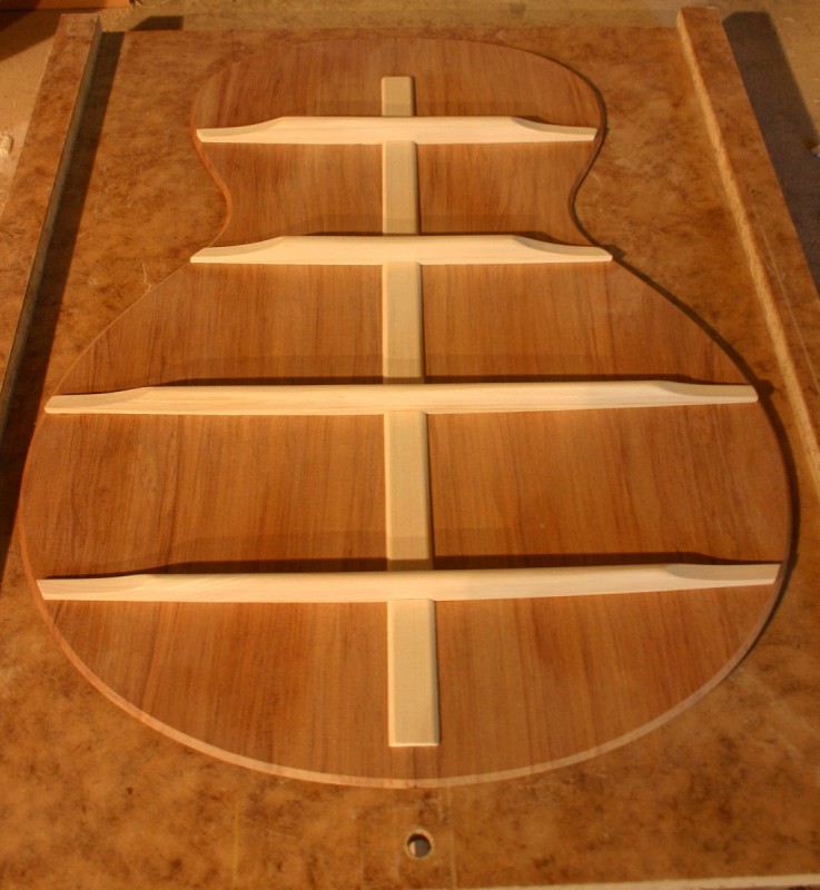

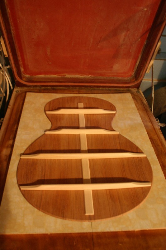

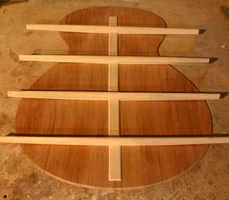

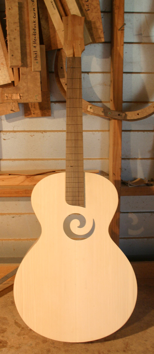

The next 10 pics are the sequence to cut out the koru soundhole and top bracing.
Christian

After seeing Steve's build this guitar is looking positively ordinary.
Still we all have our own aesthetic and mine at the moment is this clean look.

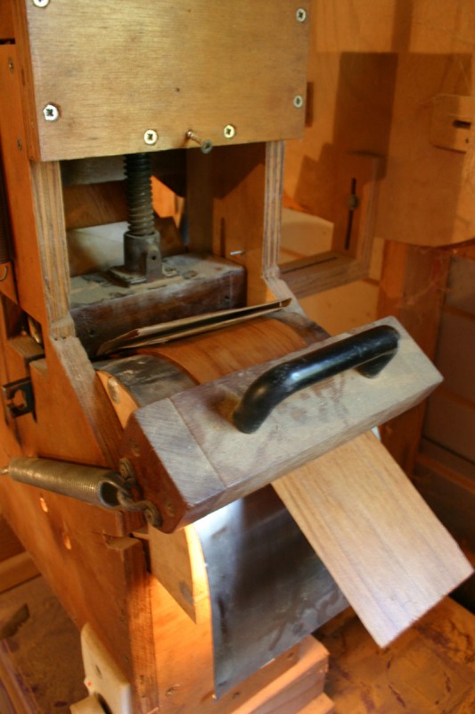

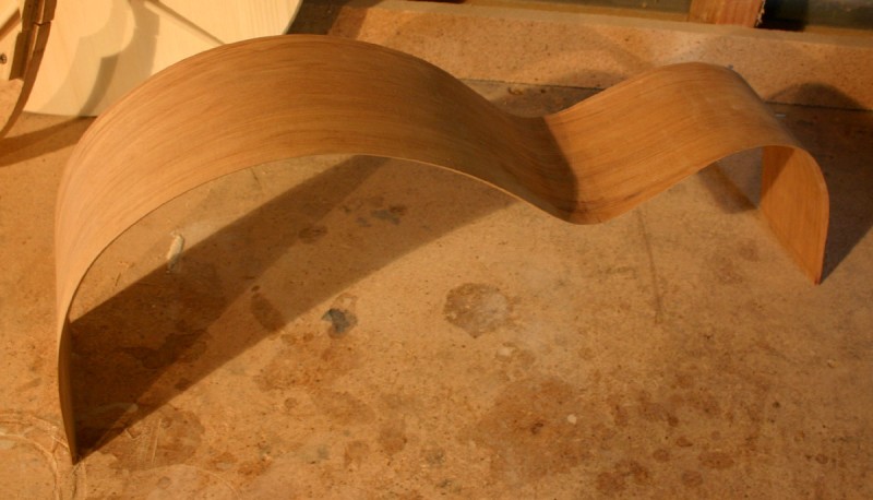

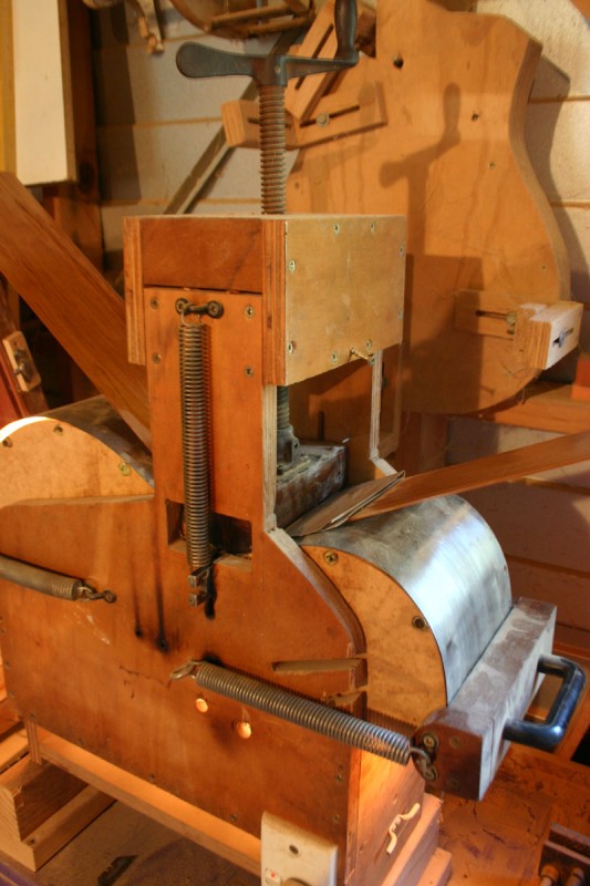

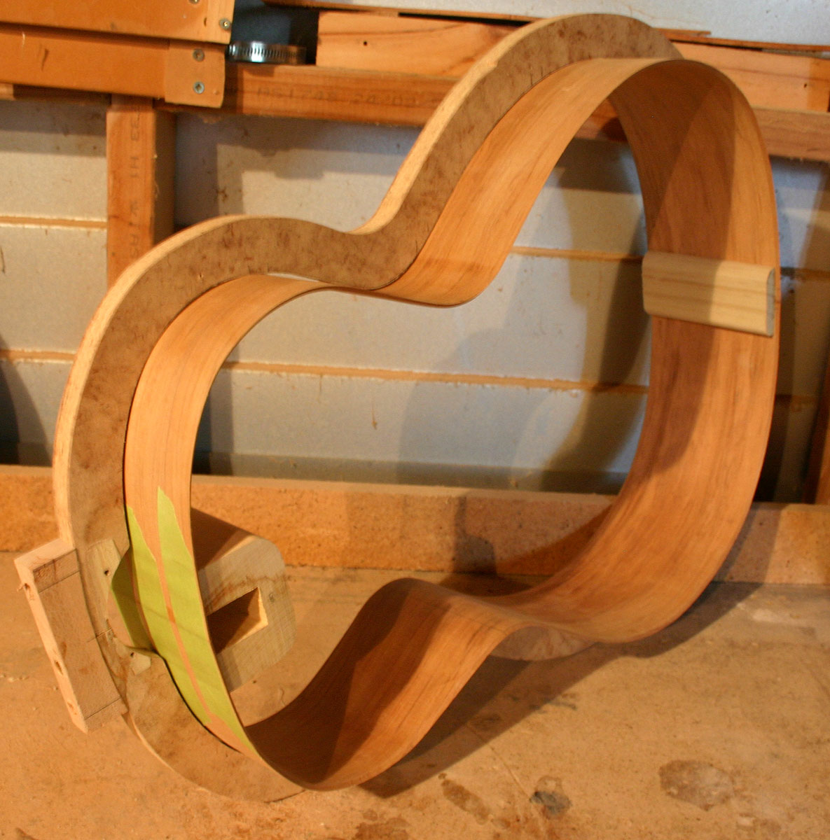

The next set of photos are of the back being braced, and the sides machined and bent on the trusty side bender.
Christian.

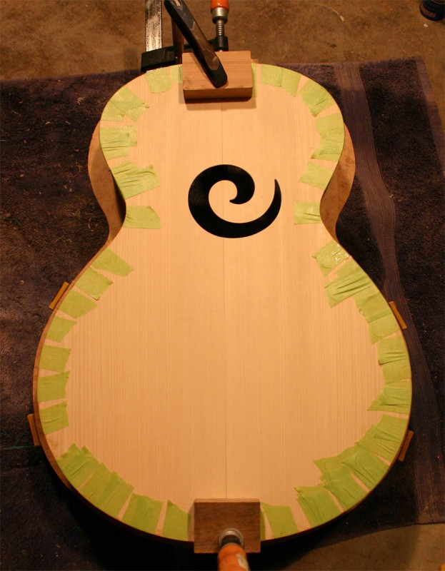

christian wrote:
Now that is the most interesting soundhole I've ever seen.
How creative! How will you trim that...if indeed you do?

Post by christian » Wed Aug 07, 2013 12:10 pm
Hi Steve,
Thanks, for the comments.
Indeed no trim on this one, pure form.

Looks great Christian. How much difference is there in the size of your top and back profiles? Would have been a pain to sort that all out, I'd guess.
I'd be keen to try the technique, but don't know if I can pull it off.
christian
Posts: 338
Post by christian » Thu Aug 08, 2013 10:57 am
Hi Nick,
I'm not sure what you mean by the difference in the profiles?. The top and back are radiused as per a normal build. the side,back and top templates are exactly the shape of the finished guitar. I start at 3mm thick for both the top and back, after mitring I thickness according to stiffness.
hope that makes sense.
Christian.

Two questions, Christian.
1. Do you add linings to the top and back? seems a really small glue area to hold a vibrating top....

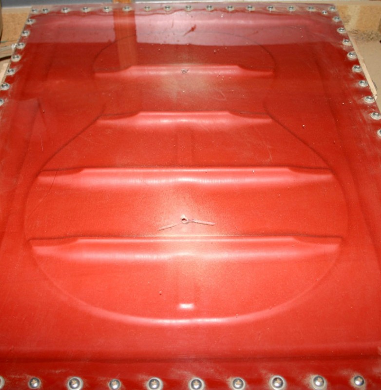

2. Is your side bender using light bulbs? And, if so, how many. I've got 4 outdoor spots at 150watts, that get hot as blazes, and I'm not using for anything. I'd have a go at a side bender if you thought that much would do the trick, tho I do love bending on a hot pipe......that may have sounded wrong. I meant a bending pipe.....

nnickusa wrote:Two questions, Christian.
Christian, it is interesting having no kerfed linings - It looks like it would go together easily but I suspect it isn't the case. Nick, I just made a small LB bender for Ukuleles and I used 540 watts, it gets damn hot and worked well to my surprise, so I think 600w will do the trick.

Post by christian » Tue Aug 13, 2013 8:08 am
Hey Nick and Col,
I do add pre bent linings they are very thin only 2.5mmx 10mm
you will find you don't really need much in the way of a lining if you don't have binding or purfling to worry about.
yip my bender has light bulbs three 150W. I found by lining the area with tin foil it heats up my steel slat super hot really quick. I only use the bender because I'm lazy, if you are competent on a hot pipe just stick with that.
Christian.

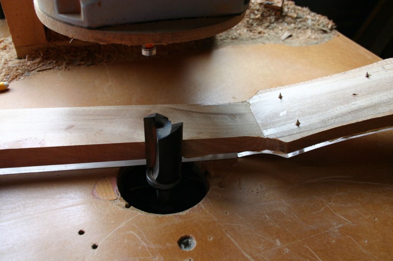

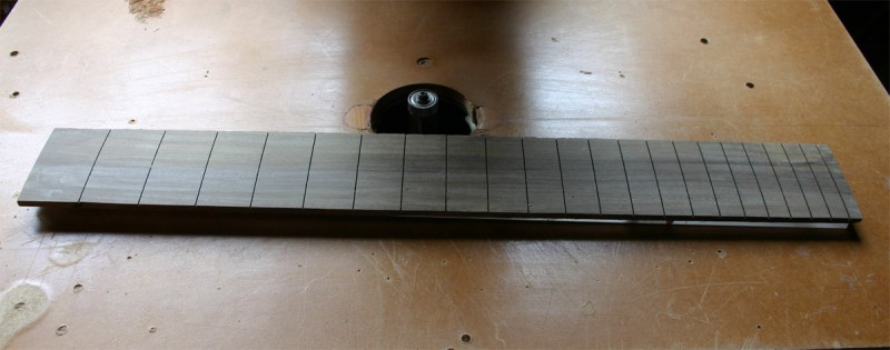

christian
Posts: 338

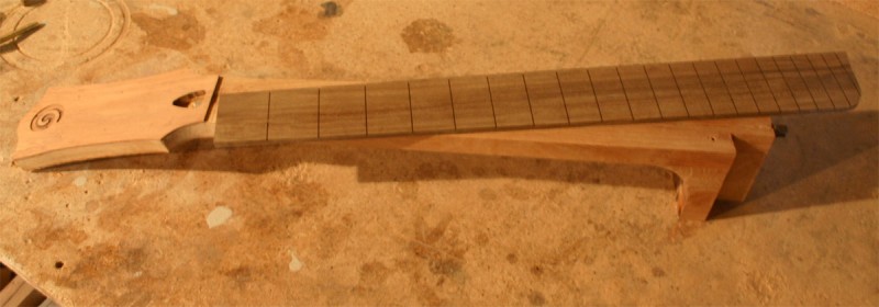

Post by christian » Sat Aug 17, 2013 7:27 am

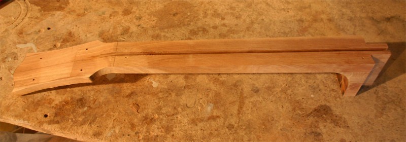

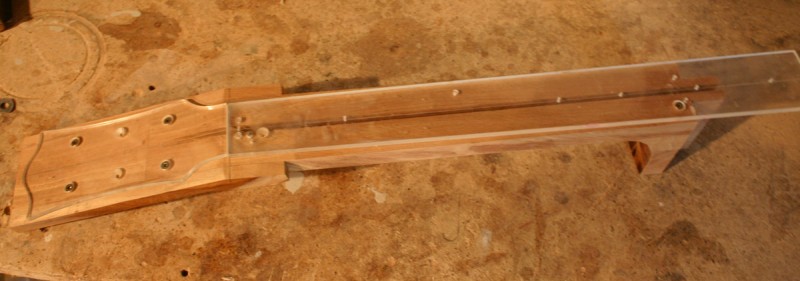

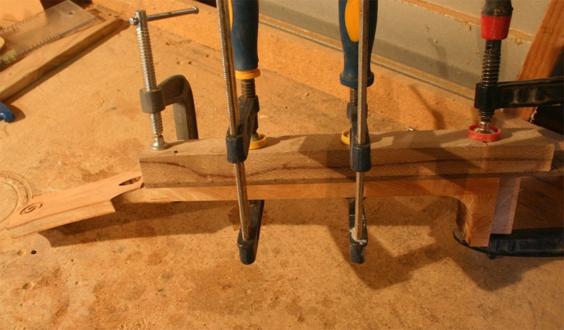

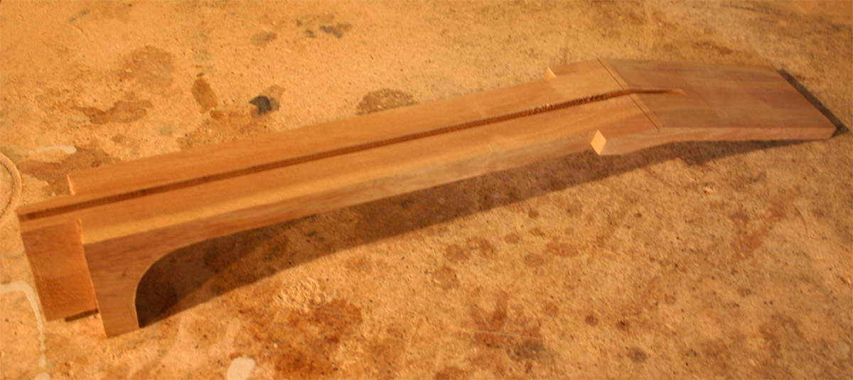

The next few pics are the shortened sequence of the Rimu neck construction and fitting.
