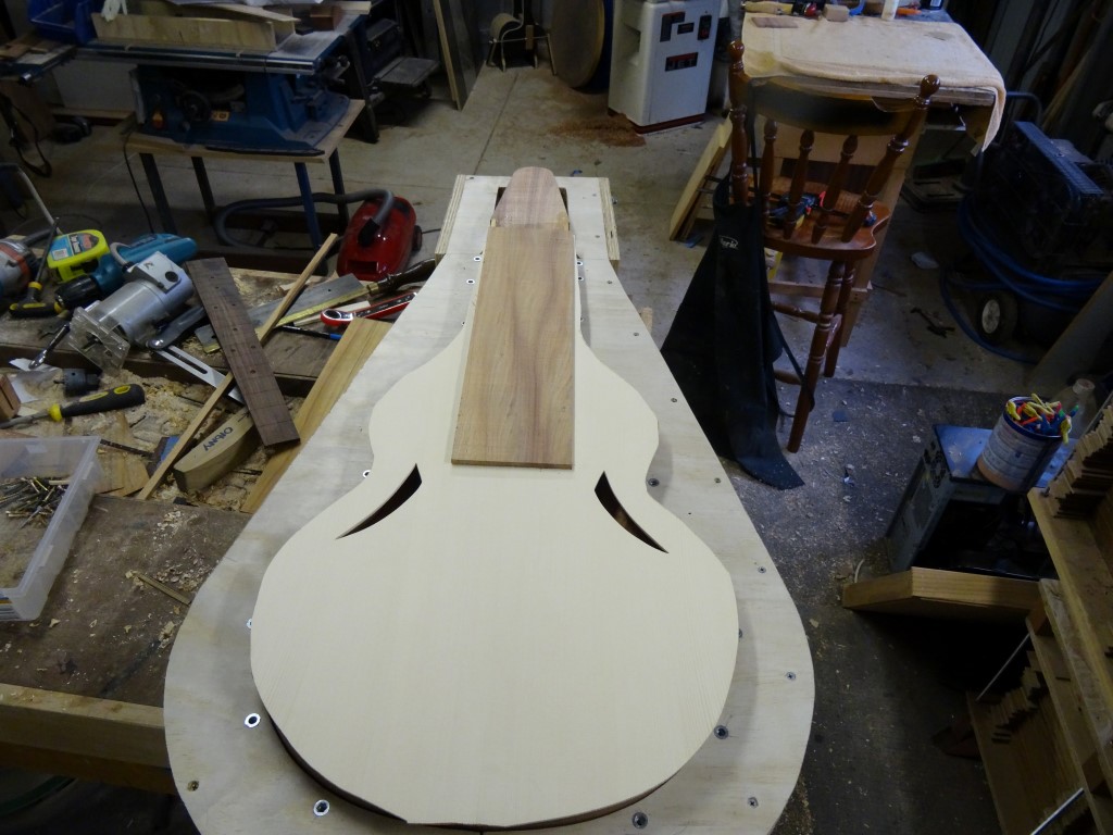

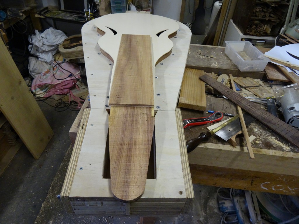

This is the first lap slide that I'm going to use something close to the bracing that the available plans advocate. ie 10mm wide. I've always thought they looked overbuilt but with close to 300 pounds per square inch on this top I think it'll need it.
The top is Euro Spruce and I've left that at 3.2mm guessing that it'll be closer to 3mm by the time it's sanded. Back and sides are going to be Blackwood with the sides at 95mm and a constant depth. So it's a bit deeper than a standard Weiss with no thinning at the tail and neck.

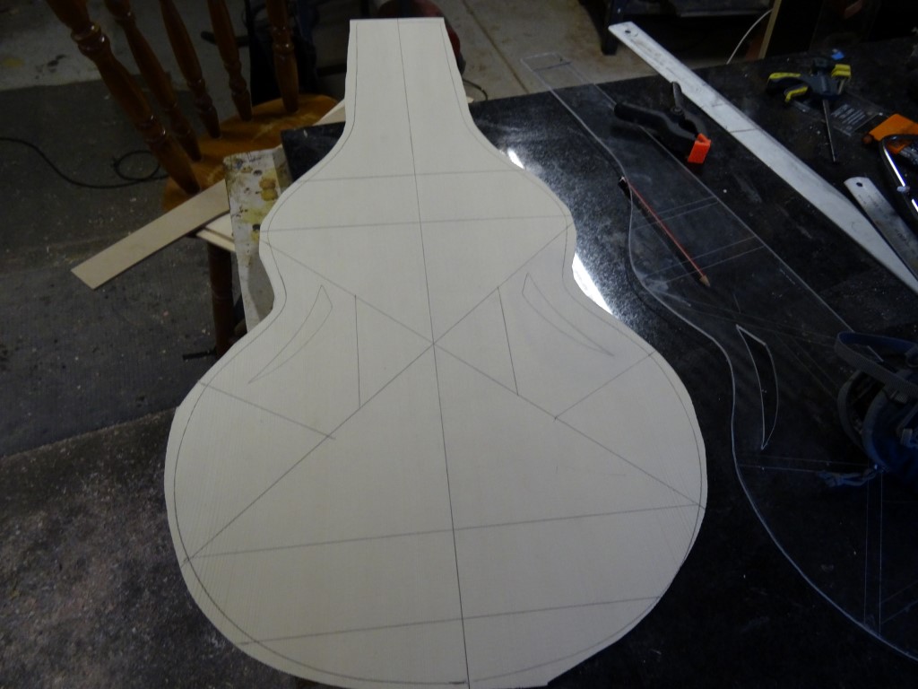

The body shape is different from a typical Weiss with a larger lower bout (40cm) and the waist in a different spot. I created the shape using a Java applet that I found a few years ago

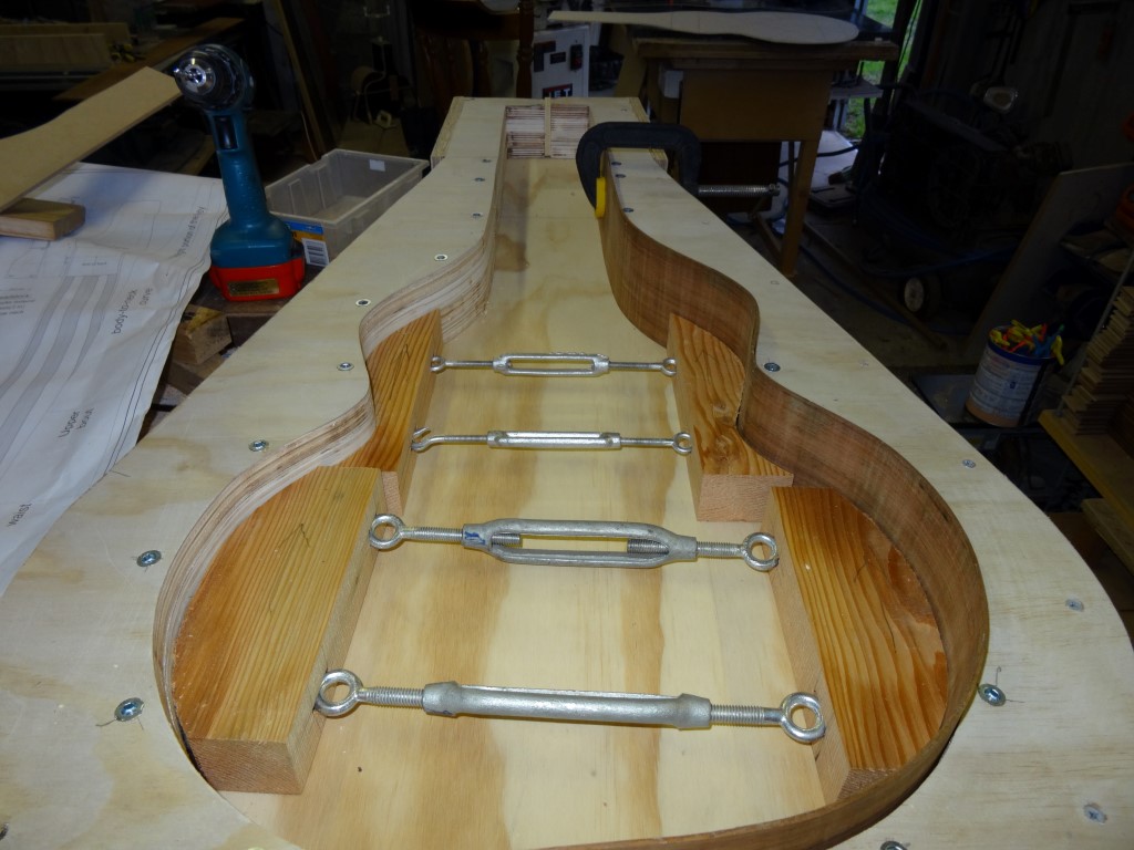

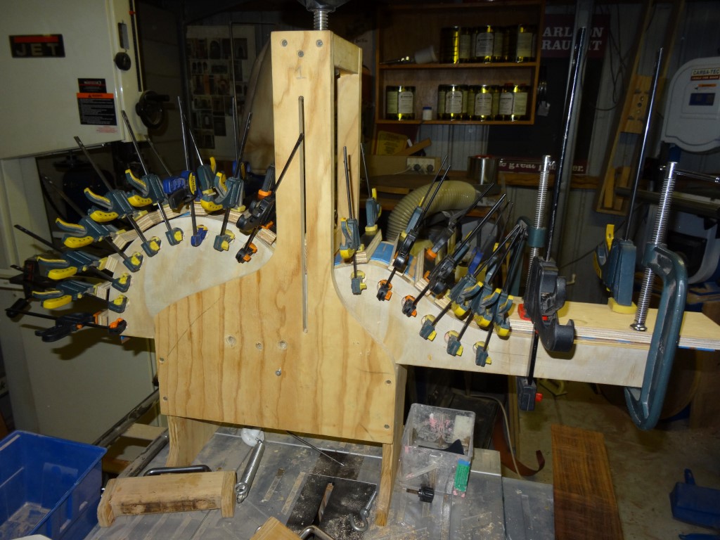

The sides are my usual laminated construction with the inner laminate at 1mm thick and the outer laminate at 1.5mm. to allow for some sanding.
Here's a few pics of where I'm at with it.
Glueing the side laminates together
Euro Spruce top @ 3.2mm

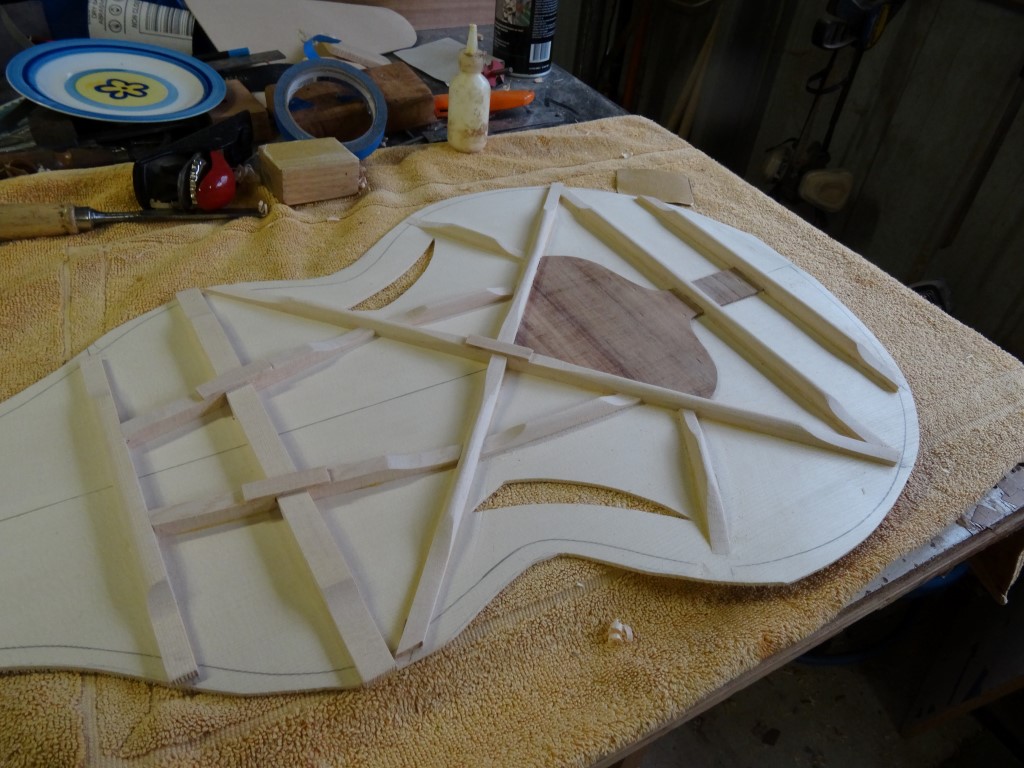

Tops done. I'm just voicing it now. It actually has a bit of sustain to it already so I'm loathe to take too much more off the braces given that the total string tension on this top will be around 320 pounds per square inch (2 sets of medium gauge strings with an .018 and an .015 for the top 2 strings)
The braces are all 10mm x 10mm with the exception of the first upper transverse brace which is 15mm x 10mm. I've taken all specs from Gwenn Lainné's plans
Christmas tree bridge plate is 2.4mm thick and the lower bout braces will be tucked into the linings.
Here's what the bracing looks like plus a few other progress shots.

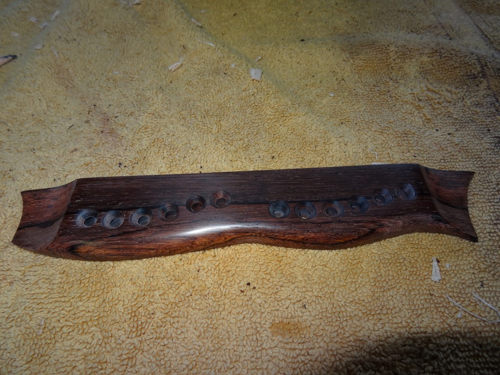

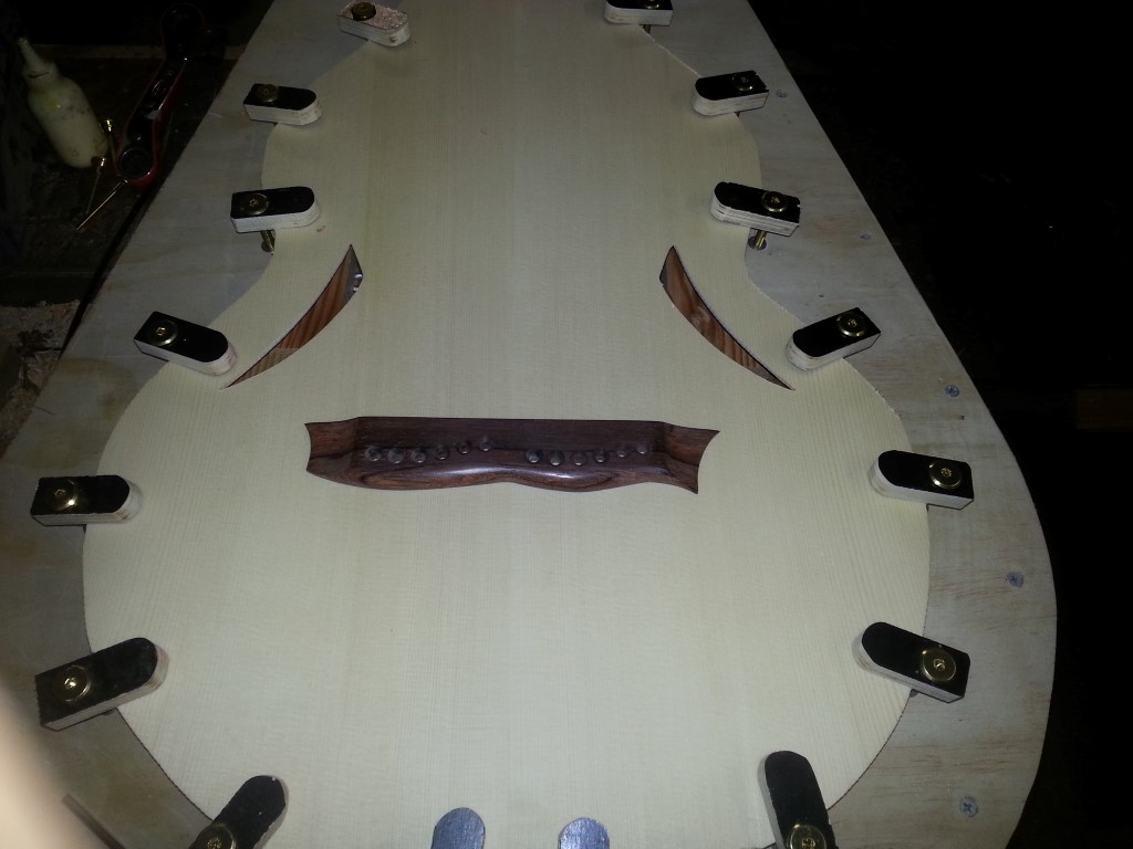

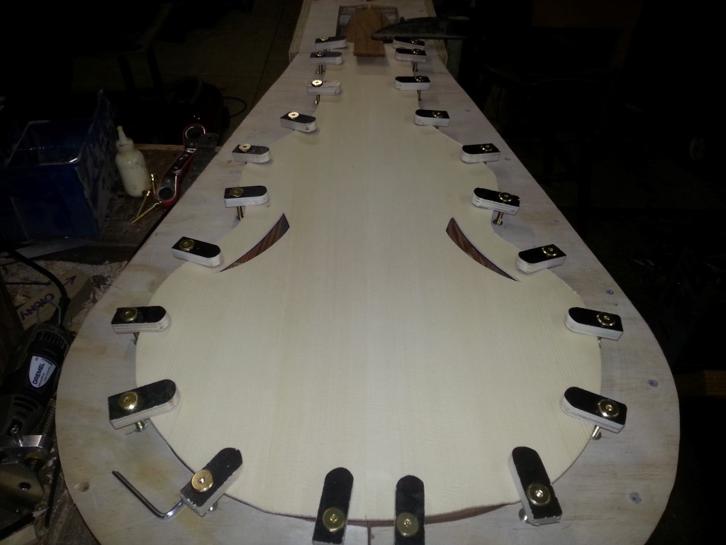

Got the bridge made and glued the top on today.
Next problem is how do I clamp the bridge on if there's no soundhole. I'm considering glueing the bridge before the back goes on by placing a block of wood under where the bridge sits and using the go-bar deck.

Re: Build log - Two sets of strings on a lap slide
Post by DarwinStrings » Mon Aug 05, 2013 8:29 pm
I can just see you playing that in a pub and some drunk looking at it trying to squint and focus that double set of strings back together.
Looks like your best option if you don't have one of those bridge clamps that suck Bob.

Ever vacuum clamp bridges? If you're setup for vacuum I'd be putting together a simple extra-wide bridge clamp so that you can locate and glue the bridge after the fretboard is in place.

I'm half set up for vacuum Richard.
I've got all the bits but haven't assembled them yet so I'll go with the go bar for this time but I'll definitely be looking at Vacuum in the future.

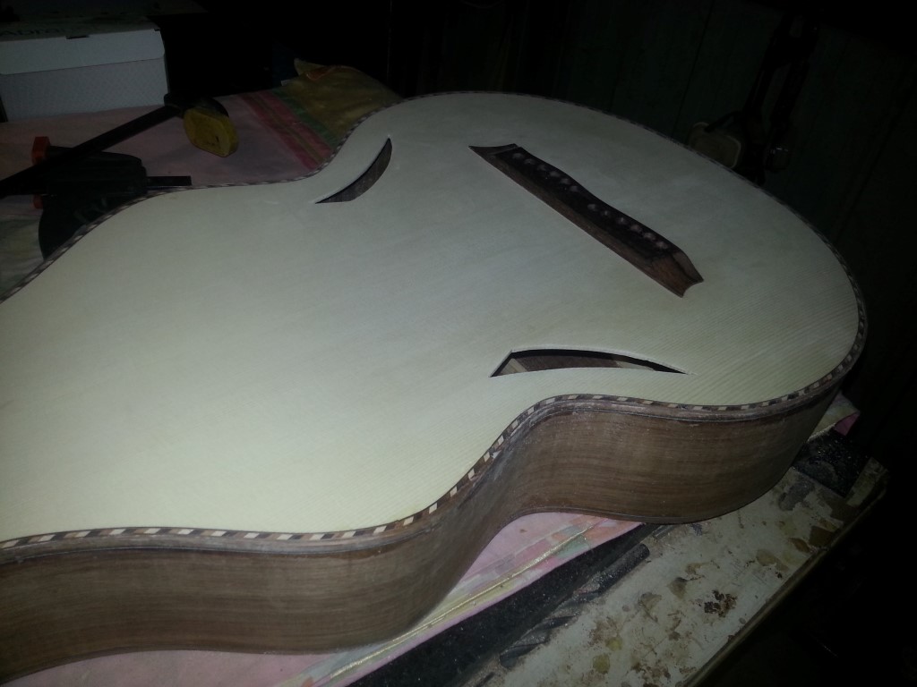

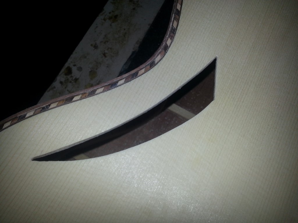

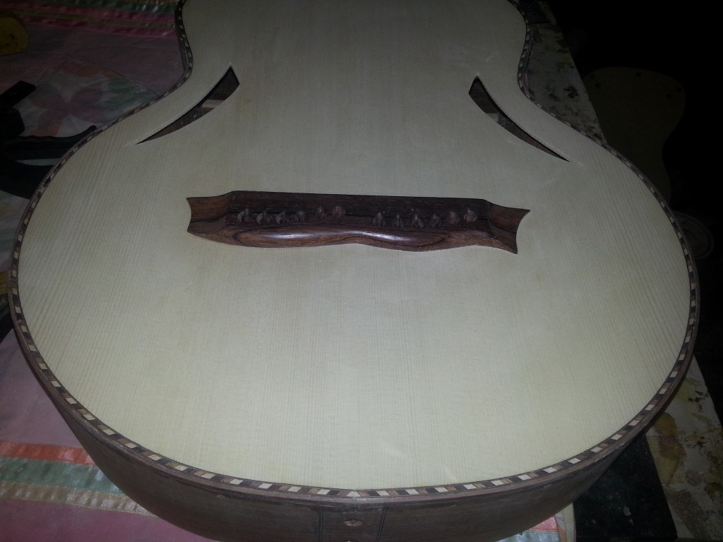

Post by Bob Connor » Thu Aug 22, 2013 6:18 pm
OK.
Got the bindings on so I'll be scraping them back tomorrow and sanding the purflings. (which are maple/koa/indian rosewood)
The only other business to be done is a backstrap on the peghead before I start pore filling with z-poxy.
I'm going to finish the top in a satin finish (Mirotone 3220 - 30%) as it'll be too hard to get a full gloss looking good around the bridge. The back and sides are some nicely figured Blackwood so I'll do them in full gloss Mirotone two pac.
Thanks for looking.

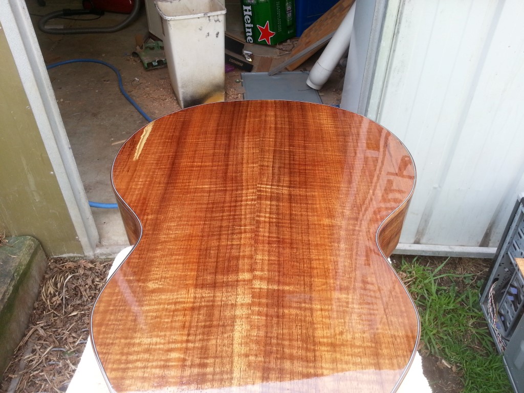

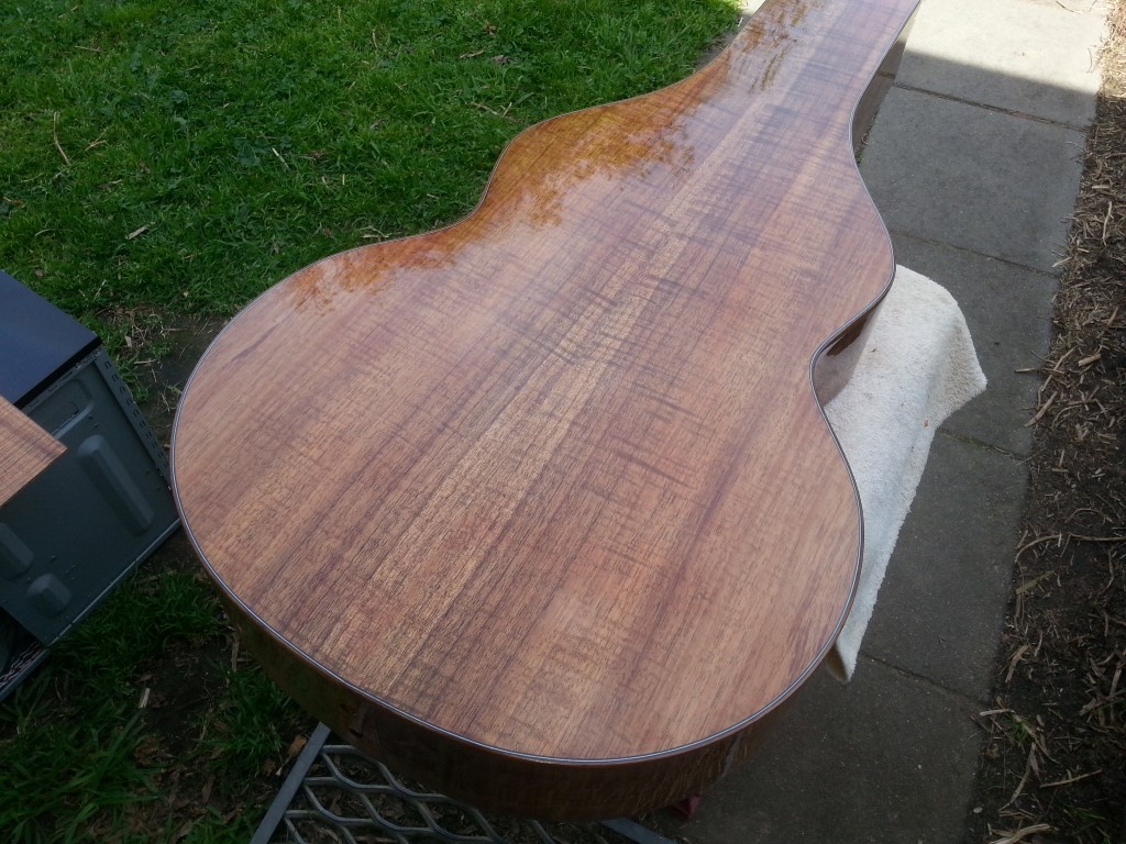

Post by Bob Connor » Sun Sep 01, 2013 3:24 pm
Got some finish on it today.
Mirotone PU5555 two pack with PU5747 hardener and a splash of 1260 thinners.
These pics are after the first coat. They got a second coat after about 45 minutes.
I'll sand it during the week and buff next weekend so I guess that's when the strings'll go on. Good luck and a fair breeze the bloody thing won't collapse. :lol:

Re: pic #2 ... How many slabs of Heineken :gui ? ... have gone into this little baby?

G'day Bob, two coats and buff the next weekend sounds pretty good, any other info on the finish, is it thin? will you still get that nice bit of ripple in the spruce?
Post by Bob Connor » Mon Sep 02, 2013 5:38 pm
I actually did the top in Mirotone 3220 (30% satin) Jim so this one will ripple through. I only used the two pack on the back, sides and fingerboard
It's the first time I've used two pack so I'm not sure what will happen. I'm just hoping I don't sand through.
I was talking to Barry Kerr at Port Fairy and he uses it so I thought we'd give it a go. It doesn't "ball up" when sanding like nitro does so there's less chance of scratches when rubbing out the finish.
He said to give it the second coat in under an hour so that it burns in.
Which is why I'm hoping for no sand throughs because any subsequent coats will sit as a separate coat.
According to the msds sheets it's
dust free in 8 minutes.
touch dry 30 minutes
sand 100 minutes
hard dry 8 hours
full cure 5-7 days
Bit better than waiting a month for nitro to cure :lol:
