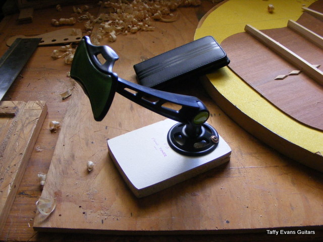

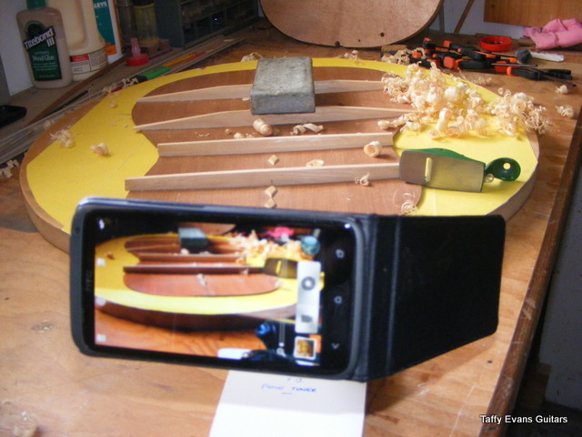

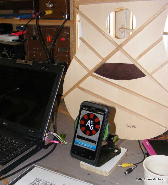

You said that you had a problem aiming your phone for filming [I haven't checked the video's yet] but I thought that this might work for you. You could mount this gadget on a mic stand or something similar.
I saw this phone holder on TV but bought this one from a $2.00 type store and of course it does not stick to anything in the car, I did not expect much for $7.00. But it's good in the workshop, I use it if I'm using the phone at times for tuning but it would work for filming too.
