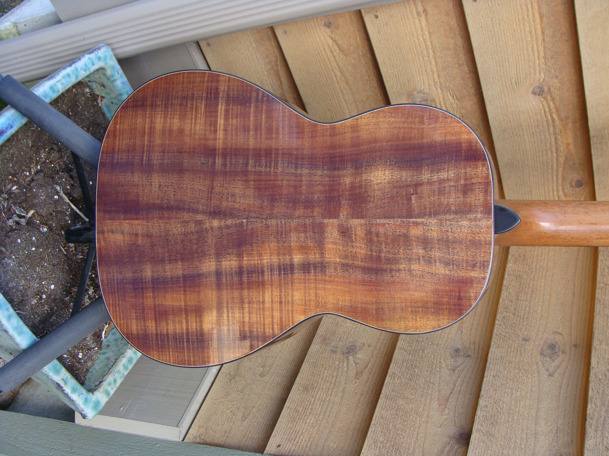

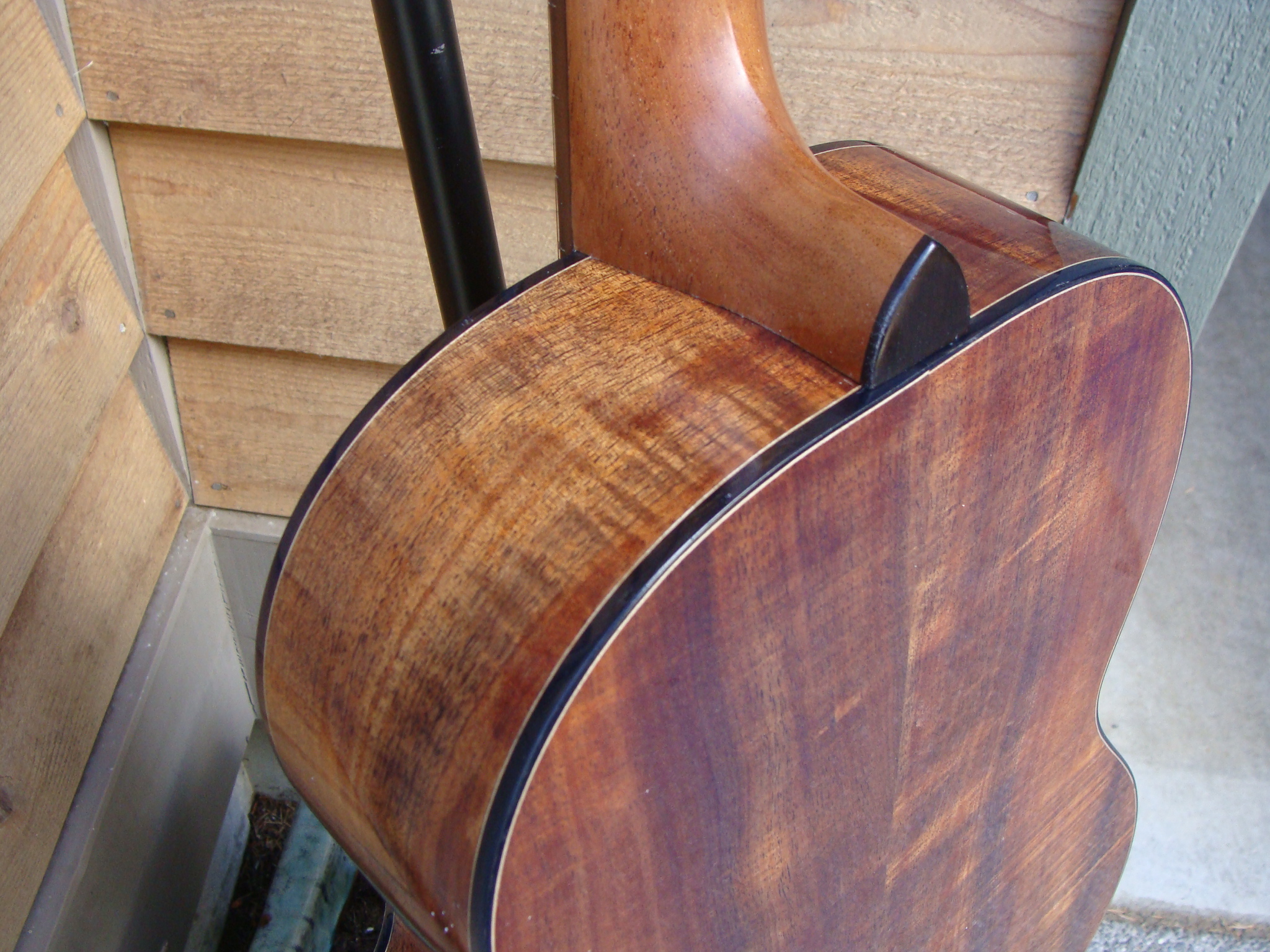

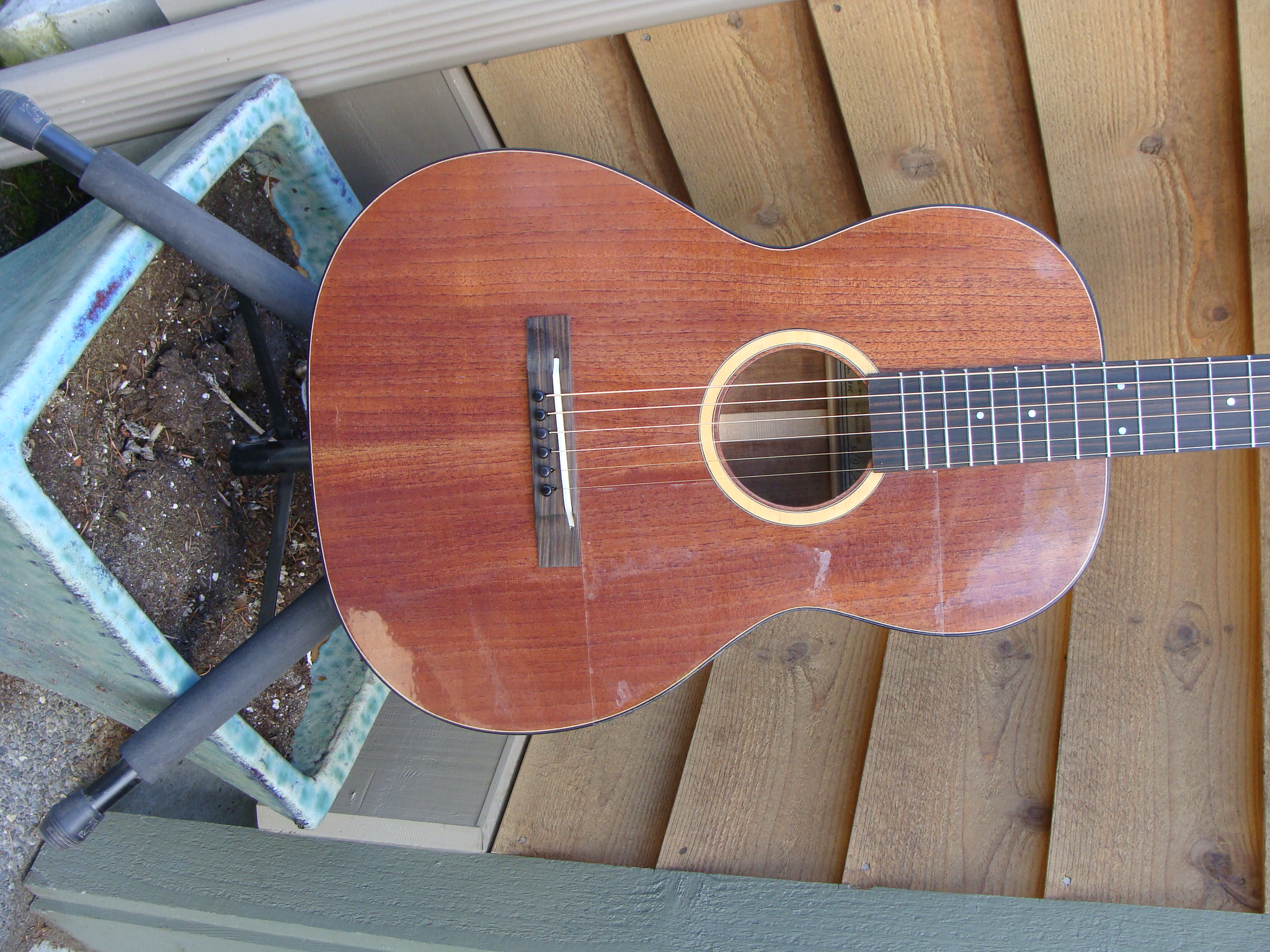

I've had great success using Australian Red Cedar (Toona) as a top paired with Tasmanian Blackwood B/S for a 00 acoustic. This guitar is about number 60 for me. It is the best sounding 00 that I've ever built. Very balanced sound, good highs and lows, great sustain, rings forever. The Blackwood/Cedar combination really seems to work well.
