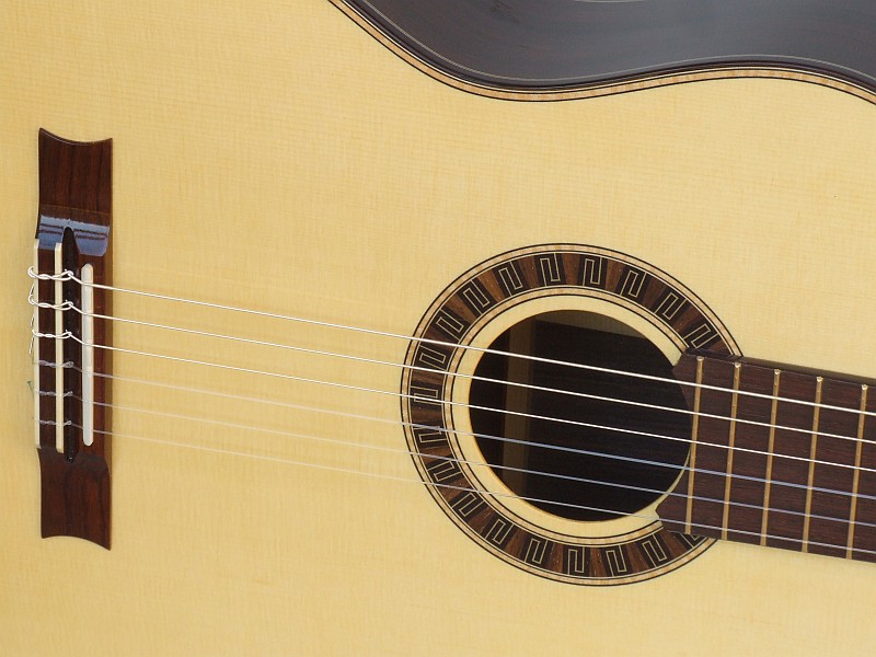

Per Jeff's mention of my nut and saddle compensation methods, some pictures showing the scheme on SS guitars are in this thread. The saddle is 5mm thick.
The bridge and saddle of one of my classicals is shown below. There is no fretboard/neck asymmetry.
