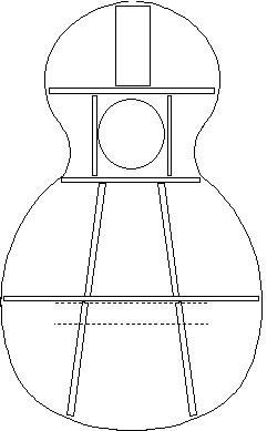

I did a rough sketch of the bracing; pretty basic, I s'pose. One back brace has let go but it looks like an easy fix.

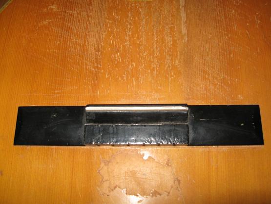

Show us the bridge, Dekka
You might get away with extra lights -10's.
Or the bridge might pull off.....
If it has no compensation slope to the saddle it wont play in tune with steels

Definitely no compensation angle on the bridge. Shaft diameter on the tuners is smaller than on a classical nylon.

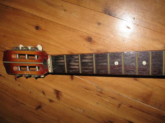

Fret-board wear suggests steel strings. Hmmm?

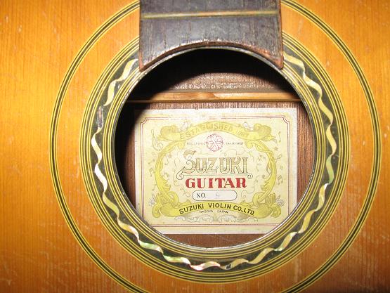

It shouldnt have steel strings on it, I know it does, but theres no compensation so it would never play in tune.
Age would be about 1980, so not super vintage

Had a quick look around and apparently the yanks split the Suzuki Violin Co in two at the end of WW2. One of these companies became the Suzuki Nagoya violin co and adopted the circular 'triple S' logo and these are well regarded for there build quality..even the laminated top models.
The Nagoya Co's first model guitars had a simple two digit sequence starting from "01" and then on to 02, 03 etc. Later models adopted an alpha prefix e.g 'W' indicated a western style or dreadnought guitar. A guess may suggest that model 09 would slot in somewhere in between the mid 60's to 70's and I say this because my own old hack has a 'W' prefix and i seem to recall that the rest of it's serial # indicates it was made in 81.
As for strings? The saddle is not compensated but apparently sales literature from that time recommends steel strings for the 09 model. I would not be surprised with that because at the time i imagine the focus for a company trying to build an export market against still strong prejudice of WW2 and the language barrier would have been on looks, price and robust reliability to try and over come the "Jap Crap" reputation that had resulted from Japan's export of sub-standard products throughout the 50's. In that, 'and' in the simple fact that many of Japan's 'modern' skilled workforce were killed in the war to leave much of the R&D in the hands of older men, many of whom may never have even heard of intonation, i reckon it's reasonable to believe that they may have overlooked that detail.

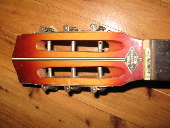

It might be a bit older than that, I think. The "Steel re-inforced neck" badge came in in the 60's, most notably on Matsumoku Gakki products like Greco, Vantage, etc. So, without further info, I'd just lump it into the 60's-early 80's range....Remember that the Japanese serial number systems were n otoriously absent until 75 or so, and never use that site guitar dater, or whatever it is, because for Jap stuff, it's ALWAYS wrong....

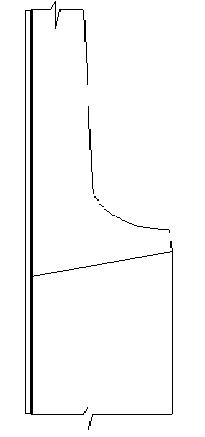

Definitely got a bridge belly issue.
With the chopped-down saddle, the gap from top to E string is 11mm. At the sound-hole the gap is 14mm.
Action at twelfth is 5mm. I reckon if I put steel strings on this as it is it'll probably fold in half!
Do you reckon I could add braces around the sound-hole and upper bout while the guitar was under tension the other way? When I place the back of the upper bout across my knee I'm able to flex the guitar to a more normal looking top.
Where the sides meet at the neck joint looks weird also; out of square. And where the sides meet at the tail block the out of squareness is repeated. The guitar was either assembled with the back 4mm further "North" than the top OR it has crept that far???
