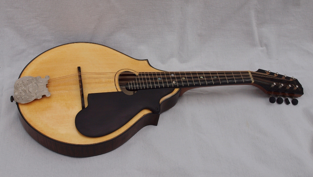

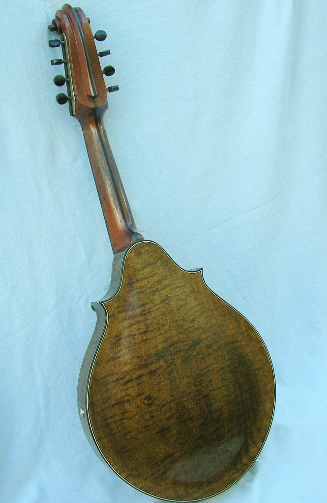

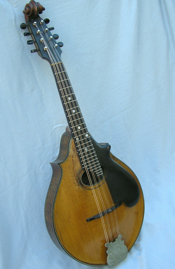

Here are a couple of pictures of the original. A bit beat up, but it sounds great.

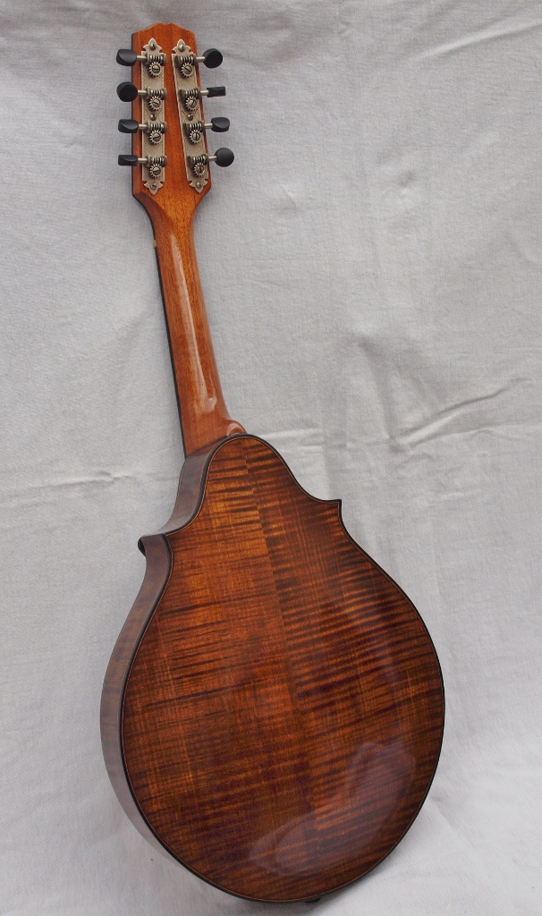

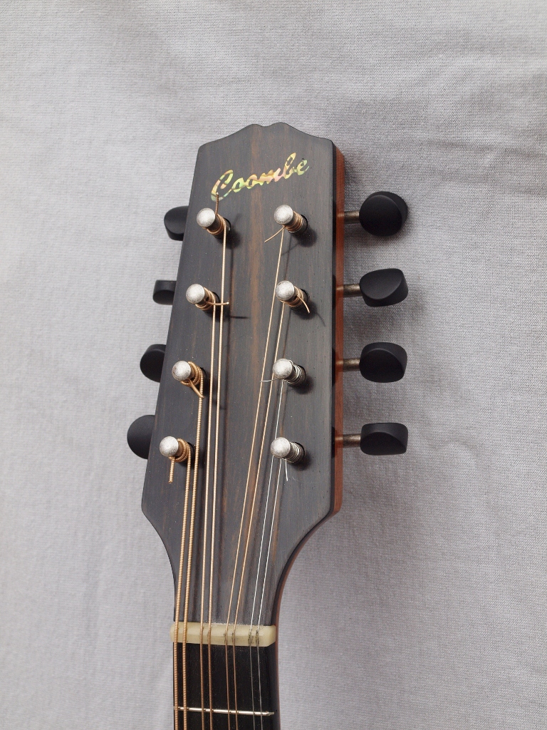

About 18 months ago I imported a 1918 type A Lyon and Healey mandolin into Australia (long story) and have been working on a mandolin based on this instrument. This mandolin is the culmination of this work. It was tempting to make an exact copy of the original, but the time and expense involved in accurately reproducing everything would have made the mandolin so expensive very few people would be able to afford to buy it. So, a few difficult decisions had to be made in order to reduce costs. The Lyon and Healy mandolins are popular particularly amongst the classical music players because of their unique sound and playability. So anything that influences sound and playability needed to be preserved and if possible improved. Thus the body, arching, graduations, neck angle and pick guard are the same as the original. The neck has a carbon fibre rod as reinforcement so the big fat neck that is on the original was slimmed down a bit. The fingerboard is radiused instead of flat. The originals were finished with an oil based varnish and then french polished and that process has been retained, although nobody knows exactly what oil varnish was used. Modern tuners will not fit the scroll headstock, so the headstock had to be simplified to save costs on custom tuners and the labour of carving the complicated scroll headstock. Likewise the tailpiece. The tailpiece is a Gibson style of tailpiece, but with a custom made cover that was beautifully made by an Australian silversmith. Thus the mandolin does have an endpin so the leg pin is not necessary and that saves the cost of getting a leg pin manufactured. The pick guard is carved from Ebony and finished with Danish oil. Bindings are Ebony, and at one stage I thought I was a masochist choosing Ebony, but I really like the end result. The top is X braced because I have always preferred the cleaner sound I get with X bracing, and that has been born out in practice because this mandolin does have a slightly cleaner sound than the original Lyon and Healy. Over all I am extremely pleased with the final result, the looks, the playability and also the sound. The sound has the sweet and delicate sound of the original, but is significantly more lively and responsive, and has more ring and sustain. It is close to being my all time favourite oval sound hole mandolin.

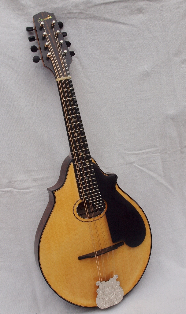

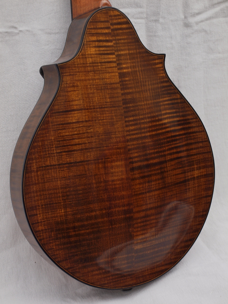

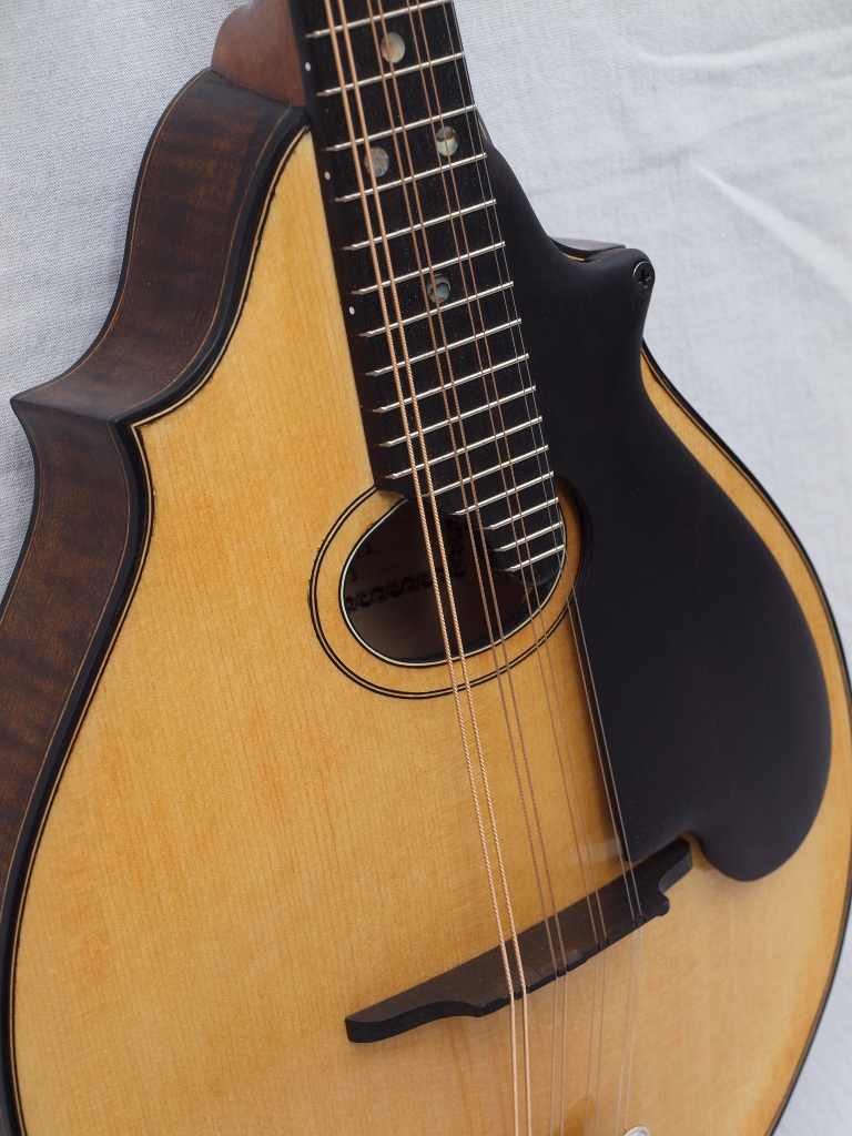

Here are some pictures

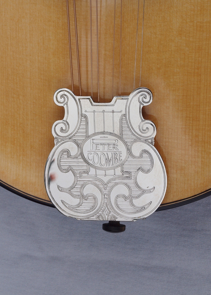

Bloody hell these are fantastic. Love the etched tailpiece...

Nice work Pete! Good vintage look as well. The only time a scroll looks right, to me, is on a fiddle. Have you beefed up the bracing to suit the 4mm top?

I prefer your headstock to the scroll of the original too.

Stunning Peter, a beautiful creation. Ditto on the comments for the headstock - much prefer yours.

No. The originals do not have beefed up bracing and time has proven them to be stable. The reason why they have not folded in is because the neck angle is quite low for an arched top mandolin (~ 1.5deg) so the bridge is around 5mm lower than the Gibsons. Thus the break angle over the bridge is lower and there is then less downwards force on the top. The body size is also smaller (thus less leverage) and the full contact bridge instead of a two footed bridge also helps. It seems to be quite stable, it stays in tune and the action height does not change as I tune it up to pitch. The Oregon X brace should be stronger than the cross brace just behind the sound hole that is on the original. It works, I (and the better half) prefer the sound of the new mandolin over the vintage L&H. I weighed it and the competed mandolin comes in at 880gm, exactly the same as the original, so I fluked it.Have you beefed up the bracing to suit the 4mm top?

Beautiful shape and colour Peter. That original headstock looks heavy.
