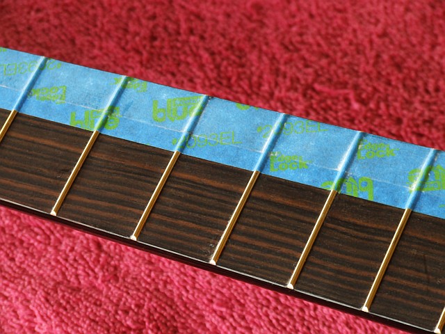

Well, that's what I used (Scotch 25mm Blue Edge-lock tape, from the local Bunnies). Worked just about perfectly. No leaks, so no need to scrape. The only (minor) down side was that it wouldn't come off in one piece (two or three), but no big deal.

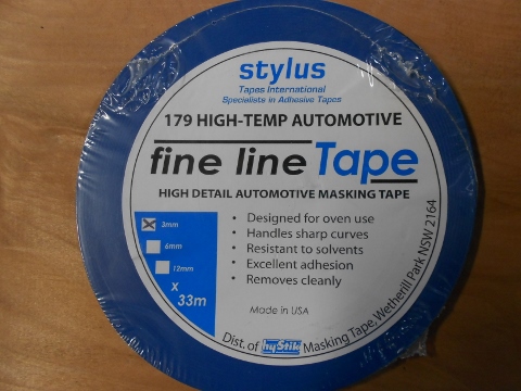

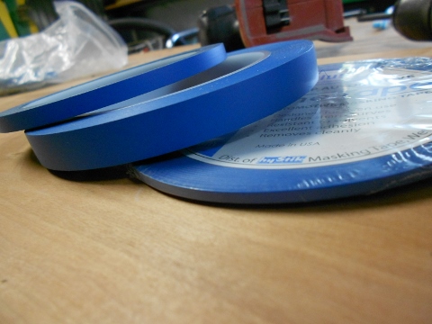

I would automotive masking tape, blue pin line tape at the edge and mask the rest with normal low tack masking tape, I will try and put some pics up tonight, it's the only way I know of that will give a perfect clean line without bleed-through under the tape.

Post by EricDownunder » Tue Oct 08, 2013 7:42 pm
These pictures should explain themselves
