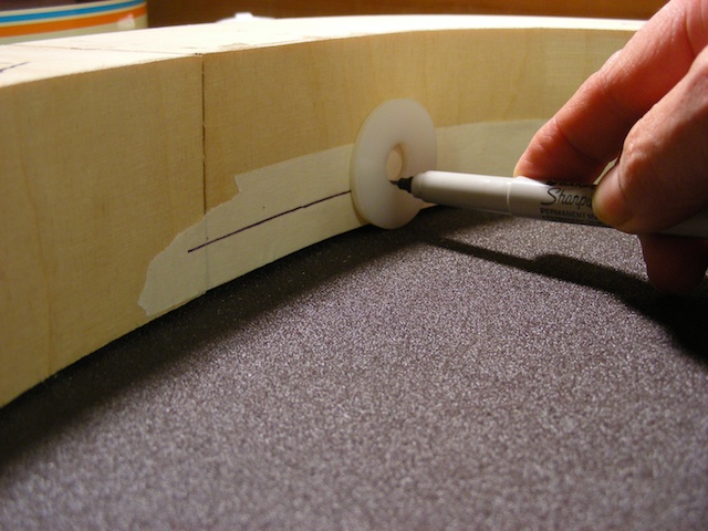

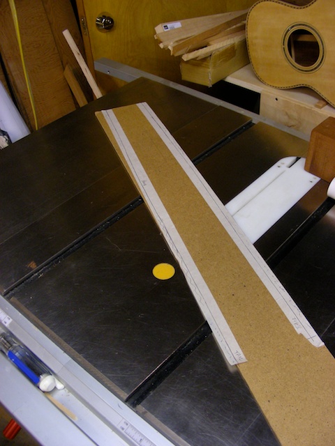

Re: Profiling sides for a Manzer Wedge styled instrument?
Bob,
Here's what I do, courtesy of Colin Symonds on the Luthier Community. Much like what jeff described.
I don't know if you're using an external form, but this methods works best that way. I use a dish so I'll refer to a dish, though it could also be a flat surface if there's to be no dome.
First, I line the perimeter of one edge of the form with masking tape wide enough to for the curve in the z-axis. Put the form on the dish and use spacers to hike it up off the dish. When I do this, without a wedge, the form ends up parallel to the dish laterally, but higher at the neck block by the amount of taper I want from neck block to tail. In this case, you'll also vary the height laterally, based on the wedge delta. Since each of the sides for a wedge instrument will be different, this would be done for each side. In guitars without a wedge, of course, you only need to do one since the side profiles would be the same unless there's a cutaway.
Cut a rough template blank, big enough that the side template can be drawn onto it. Mark the blank to show the depths you want at each end.
Then use a spacer, like a washer, that will allow you to draw a line "parallel" to the dish (or reference surface) onto the tape. I don't know if a washer would work well for a wedge, but you get the idea. Also, mark the seams from the form to indicate the length of the side.
Peel the tape off the form and stick it onto the template blank, lining up the long line on the tape with the depth marks on the template. There's one curve for one side. Repeat as needed.

Martin - I'm aware of Linda Manzer's creative commons licensing and I was intending to give credit there although the reason for doing this is totally different from what she originally intended. I will certainly be contacting her about this and send through some photos. But absolutely the idea came from her wedge design.
Great idea Jeff. I will need to do two centre lines below the profile as both sides will have to be tapered. The side closer to the player will need to start tapering from the centre of the lower bout. So I think I'll draw it and then mock it up in cardboard as Alan suggested.
Pat - that's the way I generally draw up side templates (also pinched from Colin)

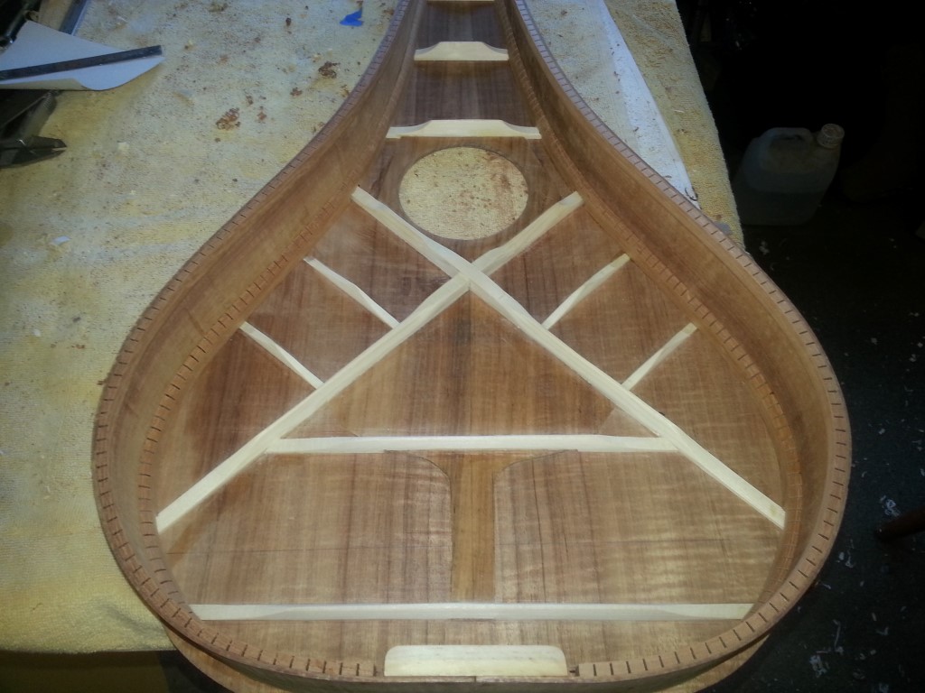

Here's progress on the first one.
The back's on now and should be binding it today.
It'll make a great reference for the wedge shape.
