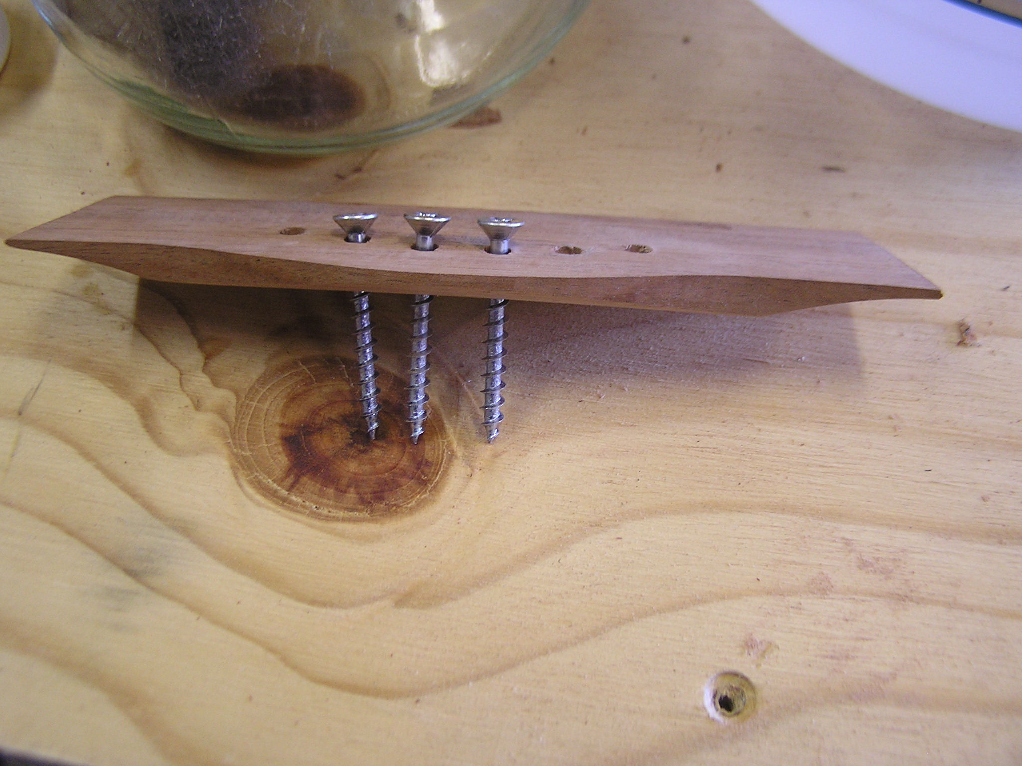

Hi All....just doing a little experiment so not really a tute so that is why I put it here. I am making a Blackwood and Red spruce OM and plan to do ebony binding and fingerboard and headplate but dont want to put an ebony bridge on because of the weight of it. So I thought that I would have a go at ebonizing one in some nice medium density blackwood that I have that should be very suitable. So I made the bridge and weighed it and it comes in at 22g compared to an ebony one that I came off another instrument which tipped the scales at 38g...so a dramatic difference in the weight of the two.

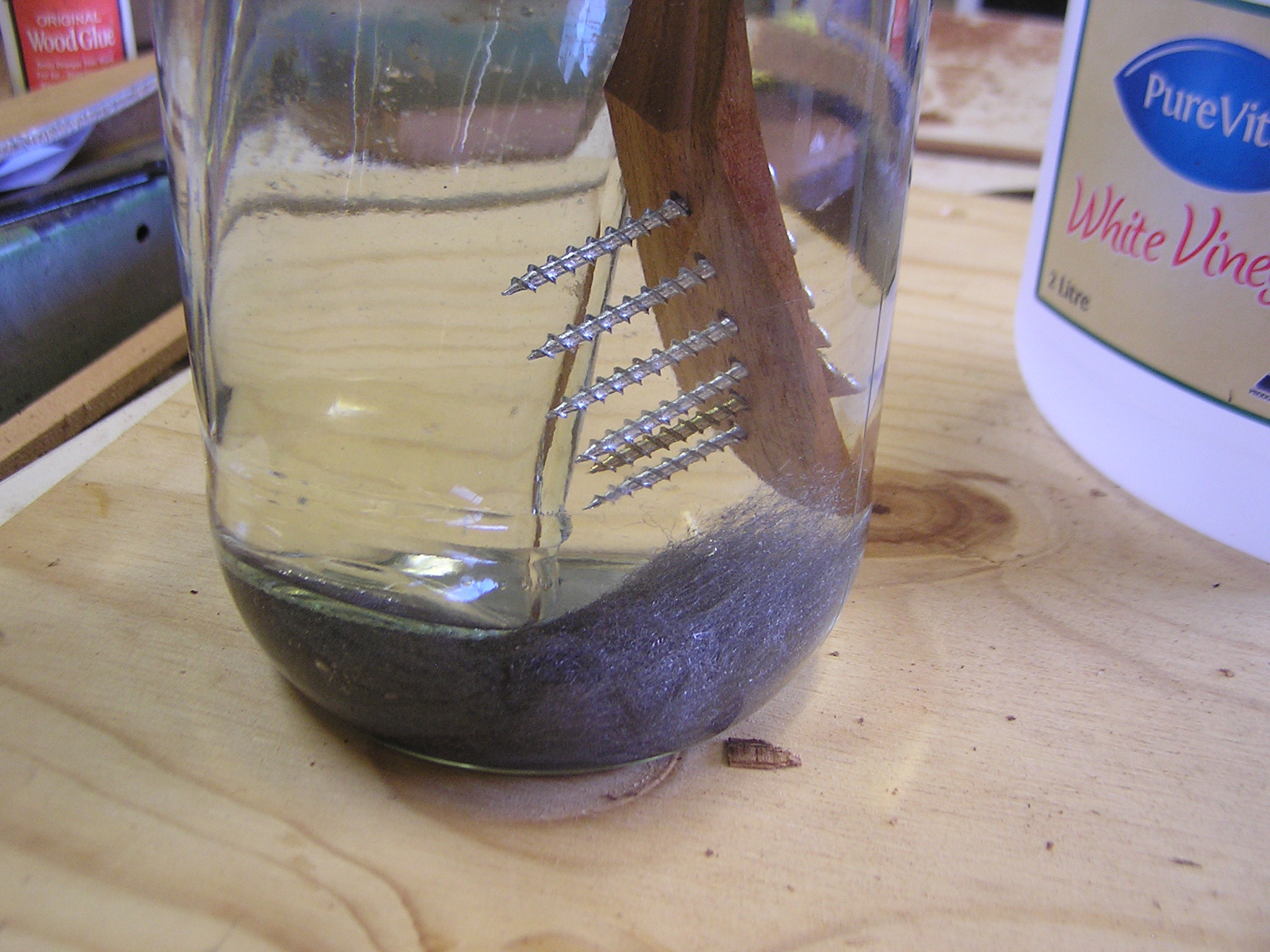

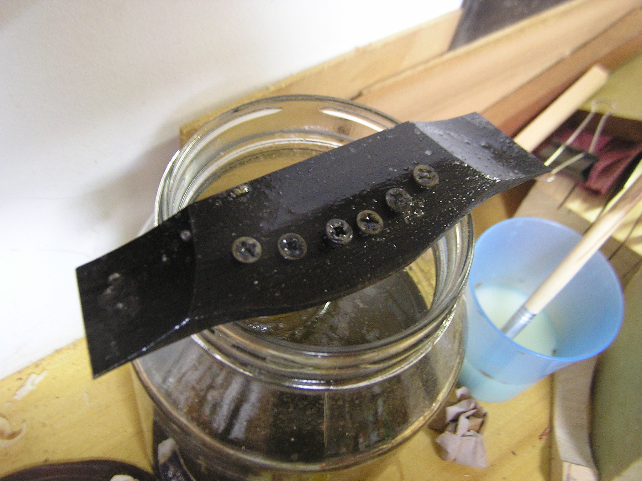

So I got a large jar to put some white vinegar into and some steel wool to provide the iron and as well filled a smaller jar with water to put in to take up some of the volume so that I do not use so much vinegar. Anyway the pictures tell the story....I weighted the bridge with some screws through the pinholes to keep it below the waterline and put it in....the picture of the black bridge is after about 5 days....
BTW...after 5 days it weighs 28g so it has picked up between 20 and 25% of its weight in water (presuming vinegar is mostly water??) so I will need to dry it quite slowly so that it does not crack...

Hi Jeremy.....It has only been in there 5 days ... when I took it out it was black but there was a sense of very very dark green about it. I hope 2 weeks will turn it proper black. I am thinking I will spray it with matte lacquer. A friend made some ebonised bindings out of red mahogany and they turned out well. Give it a go...! :)

Col, a friend did it with bindings and it went right through...I got a chisel and made a small cut under the bridge and found that it went in at least a millimeter.

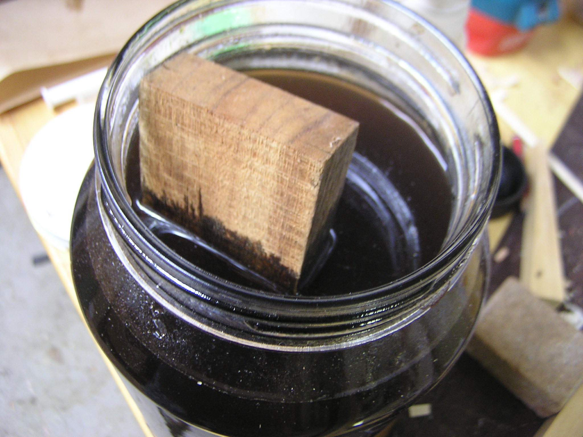

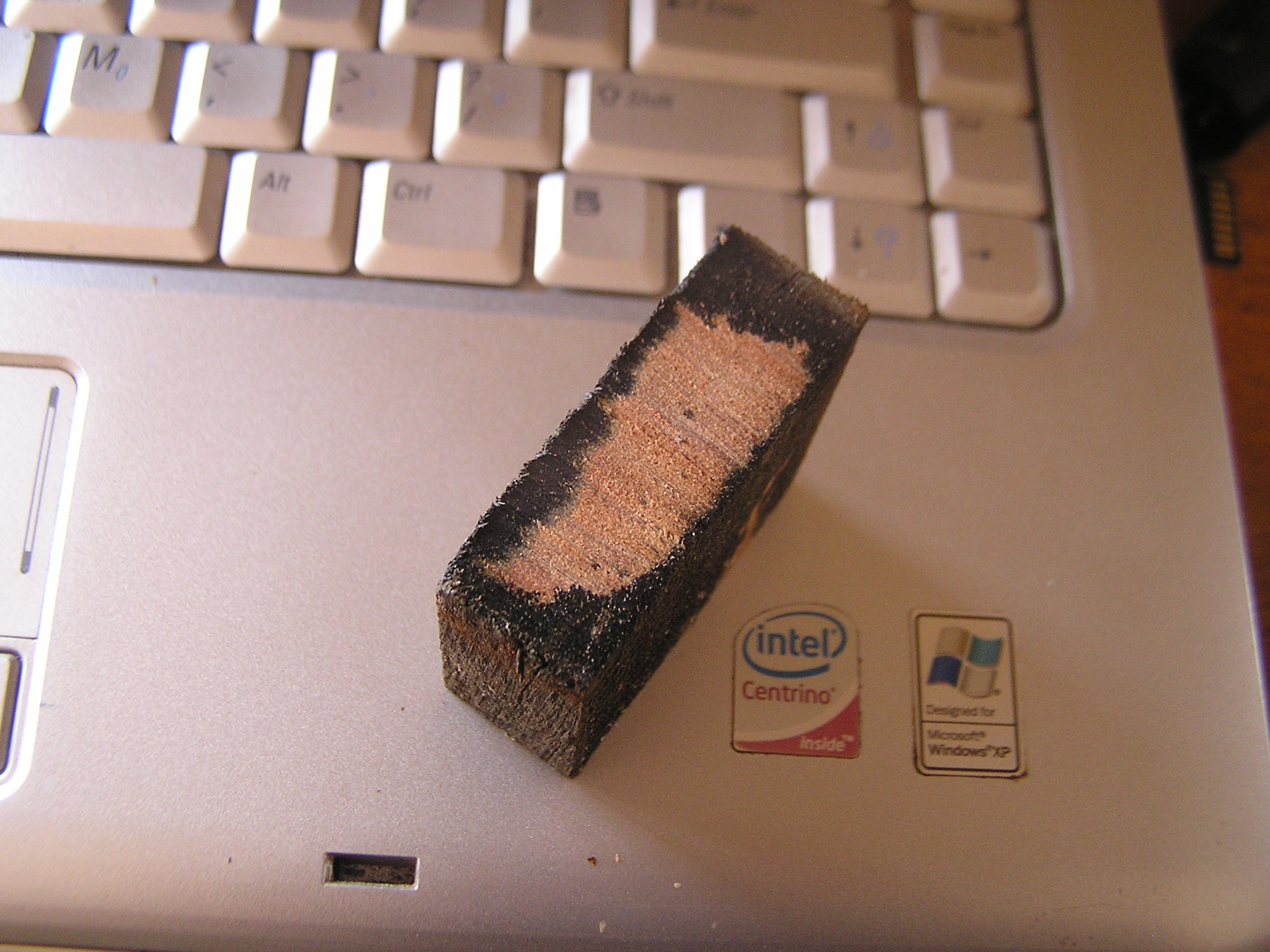

Post by woodrat » Tue Oct 29, 2013 2:15 pm
Jim this Blackwood blank has been in for about 2 weeks. As you can see it seems to penetrate fairly well. I think that several months would be the go...

woodrat wrote:Jim this Blackwood blank has been in for about 2 weeks. As you can see it seems to penetrate fairly well. I think that several months would be the go...
You experiments yielded some pretty amazing results John, thank you!
That kind of color penetration is really useful, and also is the black as black as black should be.

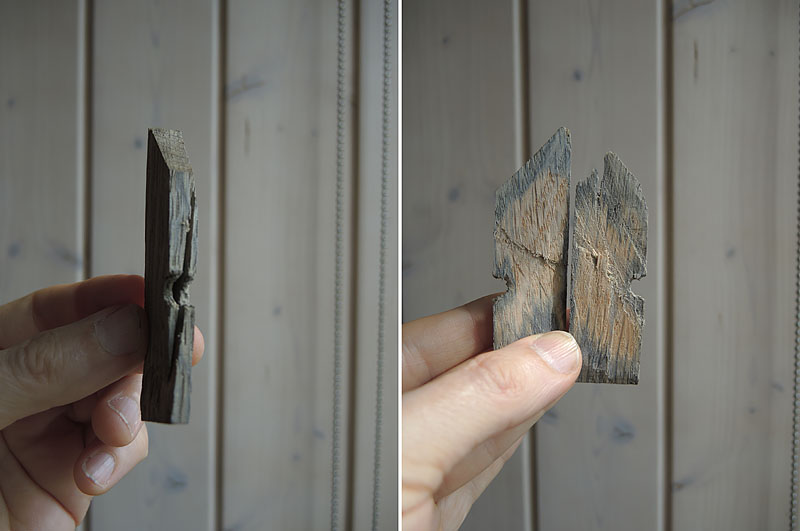

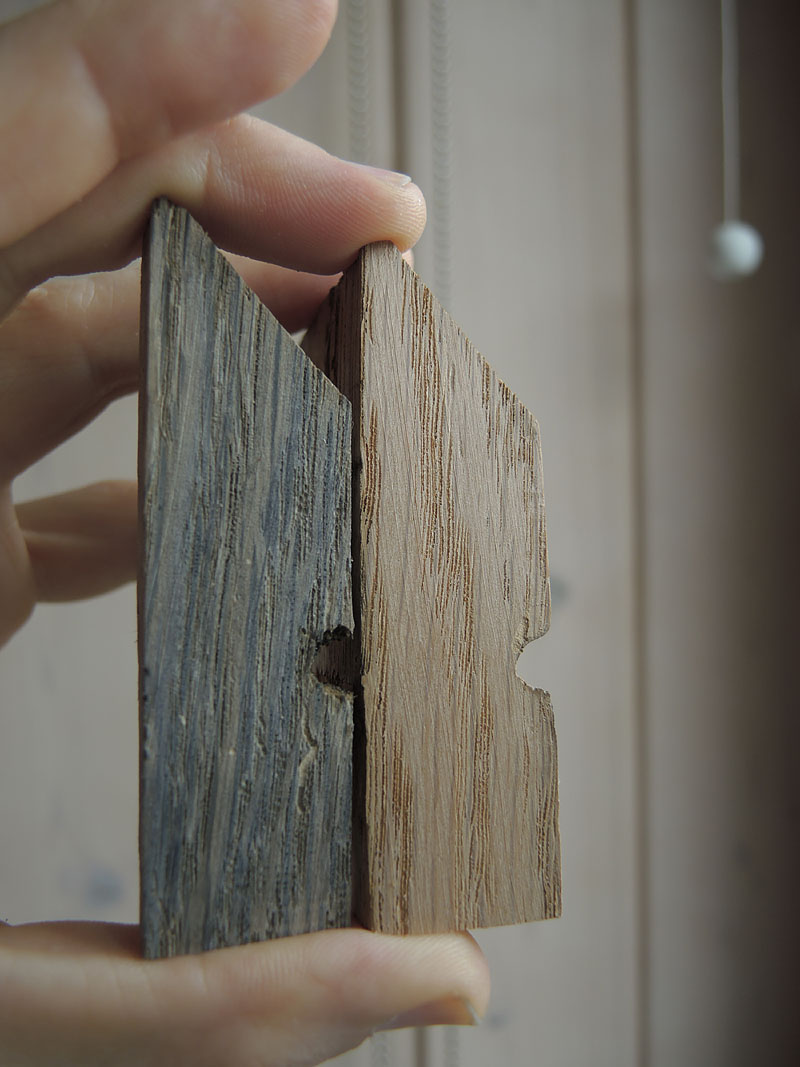

As there is no blackwood growing in the woods here around I thought oak, known to also contain tannin, could be a candidate for obtaining similar results. It turned out not to be the case. Two weeks of soaking a piece of oak in a magic brew after your receipt yielded a grey color with light greenish and dark blueish hues, and penetration was pretty poor at about 10 - 15 mm from the end grain side and 0.5 to 2.0 mm on the other surfaces.
