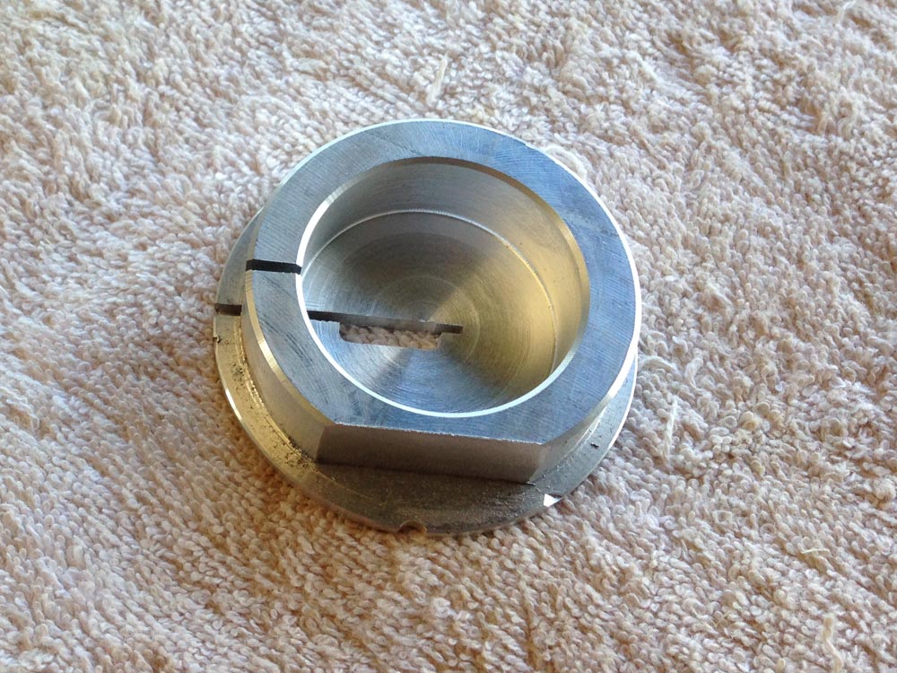

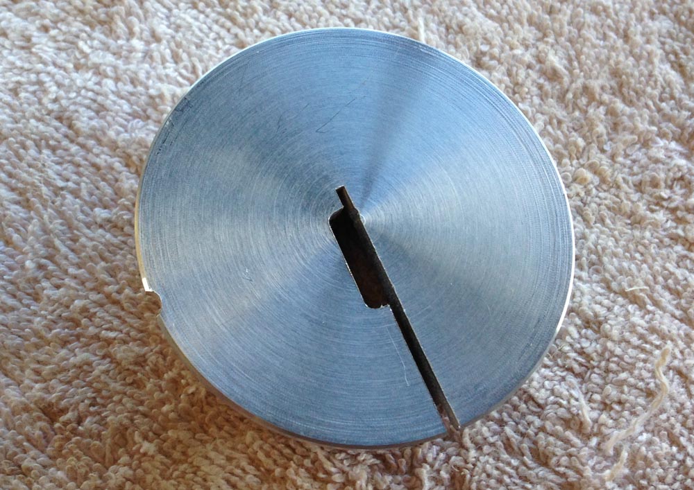

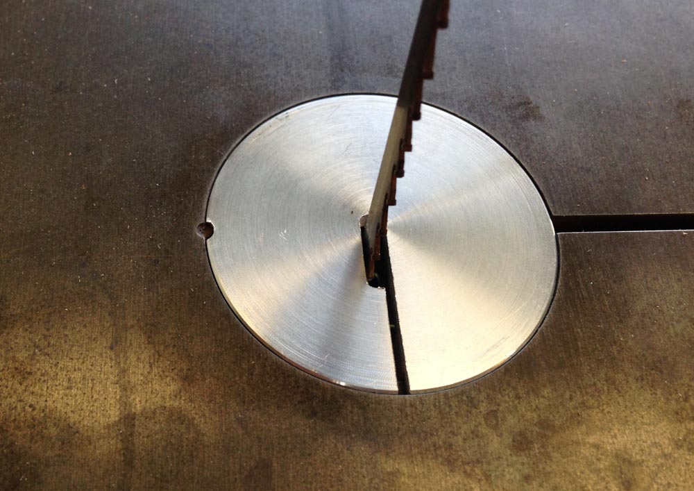

And the one in my jet was no exception. It had been replaced once by the previous owner. But this morning it just gave up on me once again. So with a bit of spare time on my hands with glue drying on various instruments, and some new kit in the shed for the lathe and milling machine, I decided it was time to make a new insert that would last.
I have a good selection of aluminium plate, so I found some appropriate size (Robust) stock and rough cut it out, then chucked it up in the lathe. A bit of flipping it back and forth to get the various diameters machined and bored. Then onto the milling machine with the slitting saw to cut the blade slot, mill the flat for the location, mill a groove for the pin. And then back to the lathe for a bit of finish on the edges etc.
Should last more than 12 months now.

Yep, those thin flimsy plastic ones really bug me. They can literally explode to bits if your blade should deign to twist into one for any reason and having a spare on hand is not always, let's face it, going to happen. At least with yours, in conjunction with the TCT blade, will only get chewed out a little if the blade should twist that much. Nice small blade clearance there too.

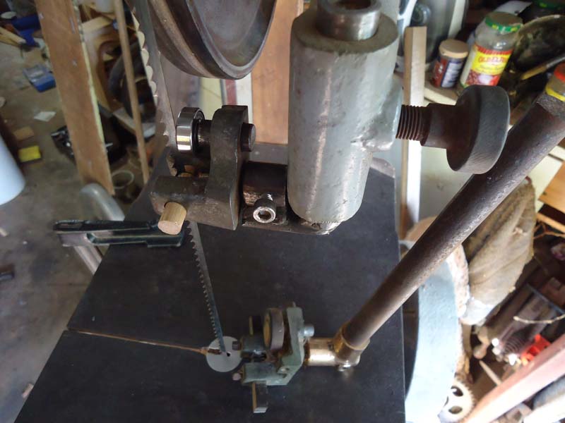

I recently did a mod on my old saw, The original top guide block only allowed a 150mm cut depth. I had a old guide off a smaller saw in my maybe useful junk pile and just had to make a mount and add a new thrust bearing (the original was a bush). With the new one I now get 200mm cut depth which is enough for the guitars I am making at the moment. Once I set it up I sliced off a 1.5mm veneer from a 190mm bit of silky oak and although the feed rate is slow with the 6mm blade the cut accuracy is spot on and smooth as.
