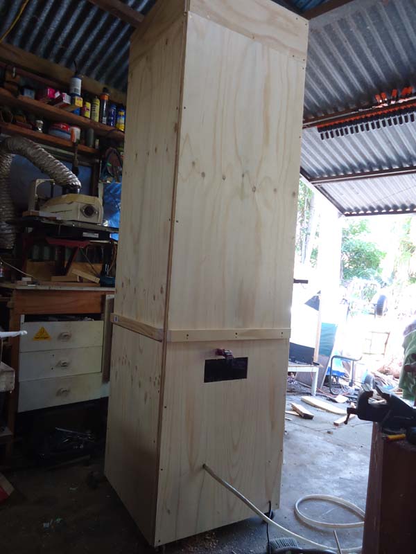

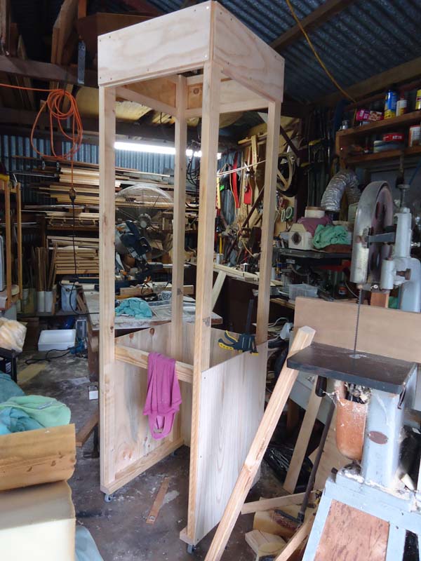

Up till now I have been using a little box with a incandescent lamp to control humidity which has been fine in the dryer times but this time of year I don't like to use it as I can't fit my whole go bar deck in it. As I don't want to stop building in the wet season and I don't have much space I thought I would put the de-humidification box and the go bar deck together. I bought a Delongi that has a humidistat, shoved it in the bottom and put the go bar deck above that. I just started it up this arvo and so far so good, it gets up to about 40 Celsius in there which is not too far above the outside temp. So the method of operation is to get everything in there I need, turn it on till I am satisfied the wood is at EMC within the cabinet then pull all four sides off the top, do the glue and go bar bit then shut it up and turn it on again. I have a window in the bottom with a hole I can poke a stick through to set the thing or check the humidity on the units read out and will also add another hygrometer just to be on the safe side.

Usually glue sessions are short, far to brief for it to be a problem (max for me is about 30 mins), sure the very outside takes up a bit reasonably quickly but it takes time to penetrate so no worries there. It is easy enough to work out when the wood has reached EMC at the cabinet set RH, you can do it by weight. My old cabinet has shown me that it works well when I deal with up to around 65% RH (I know it works cause I see the results of cross joining). This one is just more convenient as I have more control over the RH inside than the old one and this one takes a full guitar if I ever need that. The main problem that concerns me is how long the Delongi will last in such a small box but it does have a two year warranty.

The Rimu story is a bit scary Nick, I reckon I will do some tests on a few different species to see how fast they take on moisture. Even a fan blowing across the wood can keep it a little dryer I have noticed or alternatively I could work out a way to keep the Delongi blowing its dry air across the work piece while the sides are off.
I have enough space out the back of the shed to build another room which I did consider but can't be bothered and also didn't want to be working in a closed box in the wet season up here cause I would most likely melt though if it was too bad I could de-humidify as well as air con it, I have a few air cons that we don't use but I also can't throw away cause they "might come in handy some day".

I have just braced up a back and top using this box in the most humid time of year. Take them out and they curl up a bit like they should, put them back in at 40% and they go back to matching the dishes so I can finally build any time of year.
