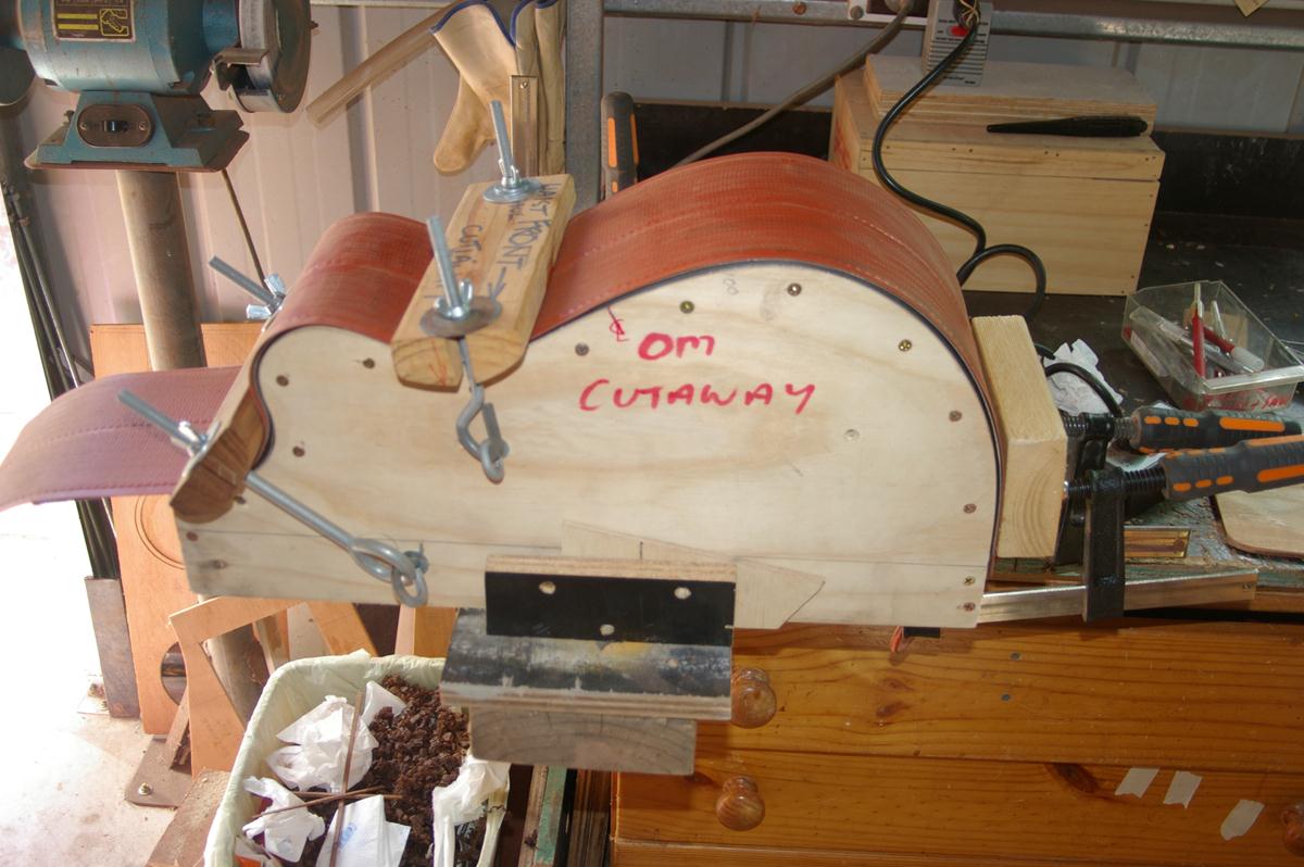

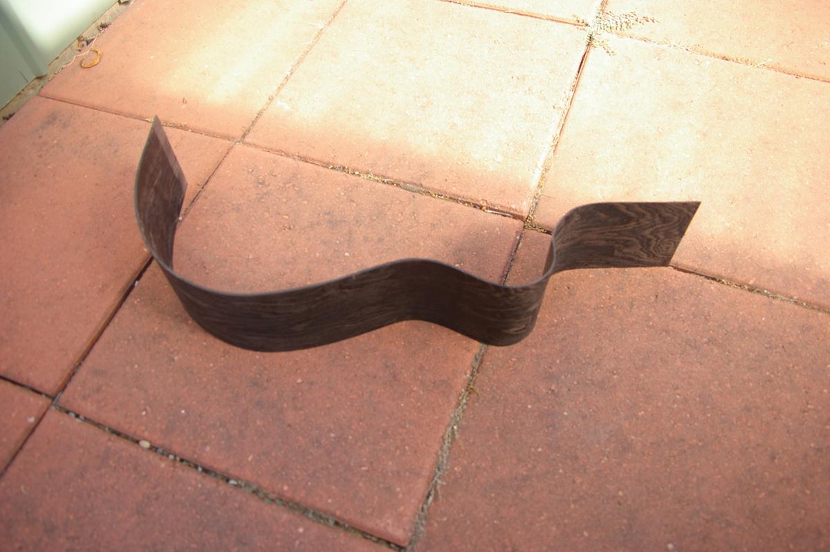

Hi Wayne....I am in the process of finishing my first guitar with the BRW that I reclaimed from the table that I brought back from the UK earlier this year. I was terrified when it came to the bending of the cutaway as the only other two BRW guitars that I have built were non cutaway ones. I bent mine on my cutaway OM form and I thinned the cutaway area from just the head side of the waist down to about 1.4-1.5mm and heated it longer than I would have for any other timber...it was really hot. I also soaked it in a trough of hot water for a while and wrapped it in brown paper and soaked that well too before loading up the bender. The bend went perfectly I am happy to say....your ABW would be similar I would expect...

Thanks Jeff and Bruce, yes i did see Bob's huon bridge, but i wasn't really convinced it was a good idea that's why i've asked the question, the customer is a huon nut, most things are ok, armrest, headstock veneer,rosette that sort of thing, i think i'll try and talk him out of it. Thanks John, i was thinking of doing the cutaway section on a pipe, i'll thin it down as you suggest and hope for the best ( customer supplied this wood so i don't want to stuff it up.) Wayne

Similar to woodrat the last cutaway I did I soaked that section in an old electric frying pan. I gave a small bend first so I could keep both ends dryer... Only done 2 cutaways to date so there may be better approaches...conditioner/supersoft?

Thanks again John and Jeff, i did as advised and thinned the side to 1.5mm from near the waist, i soaked the side in hot water with some fabric softener in it. I decided to do it on a form with the blanket instead of the pipe, everything went smoothly and i didn't hear any cracking, so it's all good. Thanks again Wayne
