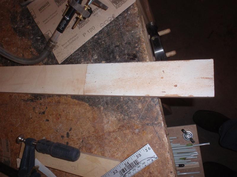

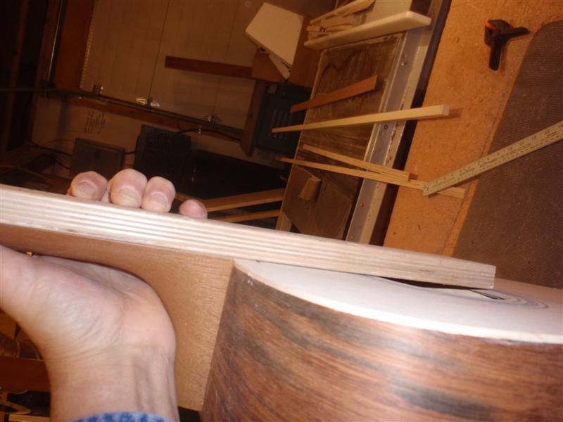

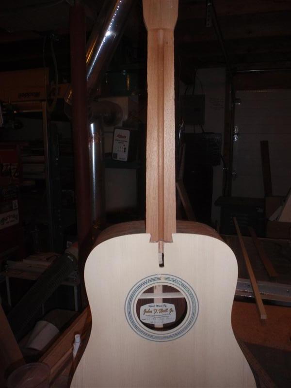

here are some pictures of the final prep of the neck
- P1010003 (Medium).JPG (55.82 KiB) Viewed 8286 times
- P1010002 (Medium).JPG (62.99 KiB) Viewed 8286 times
- P1010001 (Medium).JPG (40.27 KiB) Viewed 8286 times
Member of the board ASIA
