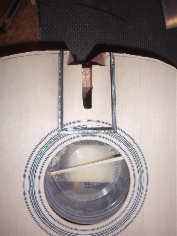

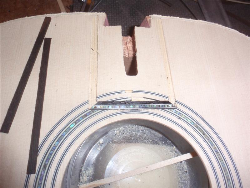

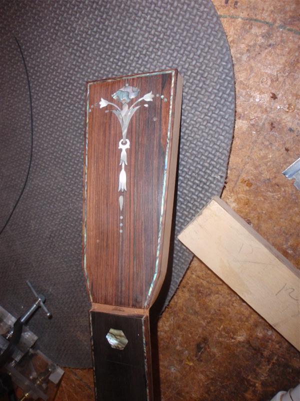

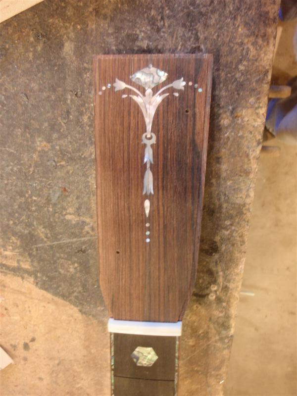

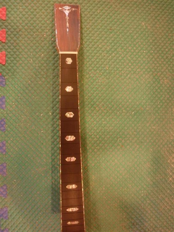

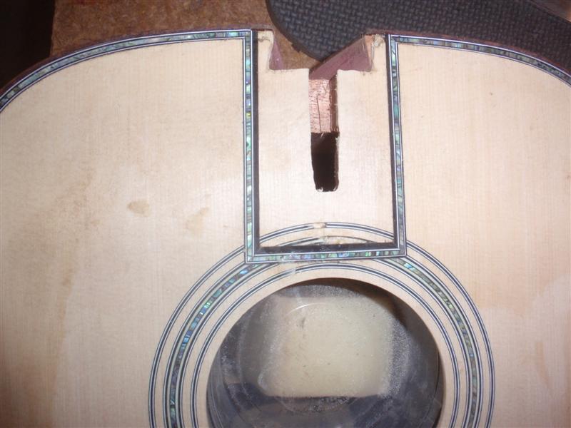

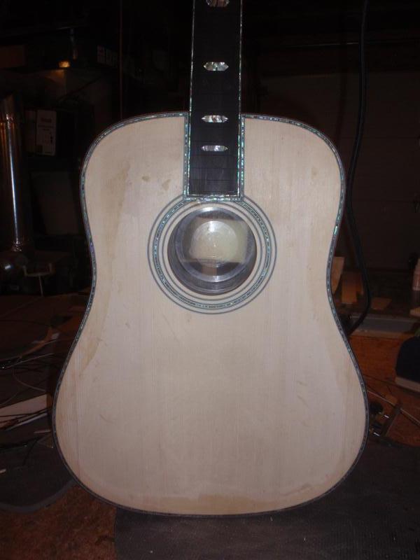

here is a 45 top and head stock Takes time but will worth the effort
when doing the top I start at the extension then I can miter into that for the rim pearl. I use a poly filler and pull that later when the glue sets to drop in the pearl.
P1010028 (Medium).JPG (41.09 KiB) Viewed 5518 times
