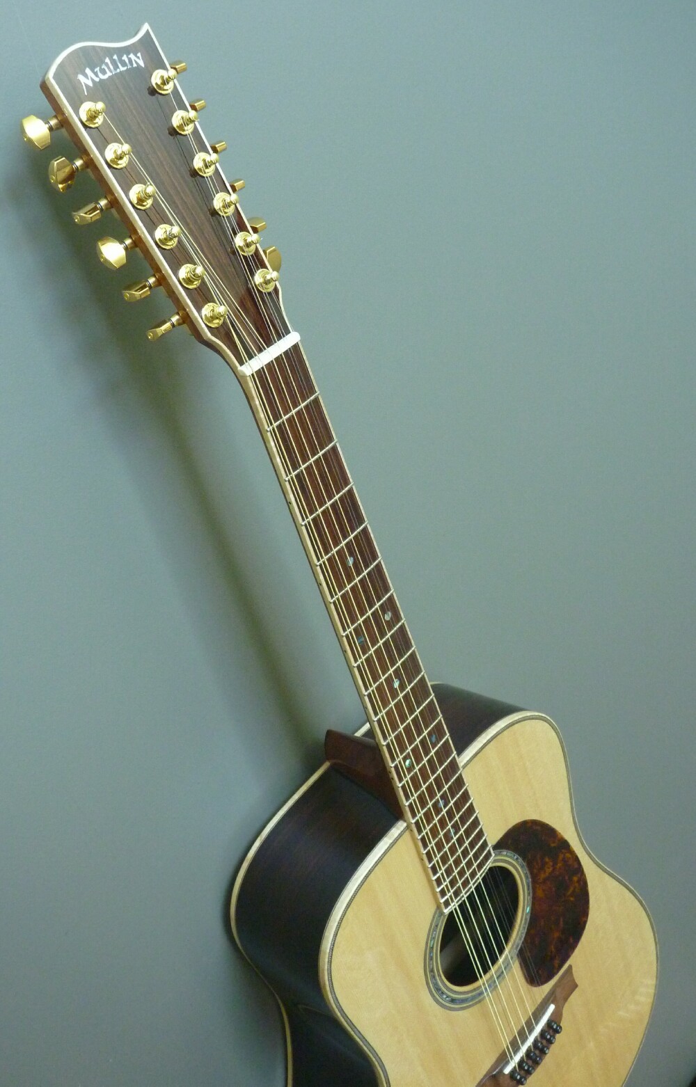

I only have one 12-string under my belt -- built for myself in 2009, intending to fix all the things I didn't like about my Martin D12-28. It was successful, but until recently no one has come looking for one (the owner of a recording studio in Nairobi played it a month or so ago and after only a few seconds asked the price -- if he buys it, I'll build another just like it).
The guitar has a flat-top -- same as my other guitars. There is always a slight doming that occurs on all my guitars under string tension, and most people would think they are built domed. I haven't made a single adjustment to that guitar since 2 days after the strings went on, and all settings have stayed exactly where they should be -- despite spending 4 months at sea in a shipping container finding its way between NZ and Kenya.
Compared to a 6-string dread, the Sitka top is 0.005-0.010" thicker (i.e., about 0.110" rather that 0.100"), the X is no more than 2 mm taller, and there is a scalloped brace across the bottom of the bridge patch -- I think that's also on the Ante's plan? That's it. It's been a cannon since day 1.
Lots of great guitars out there with flat tops -- a radius is by no means essential, even on a 12.

Hey Tim, good to see you managed to get your access problems sorted
Nice clean looking twelve string too, Rosewood B&S?
Re: 12-String top radiused?
Temporarily -- I'm currently in New Zealand for Christmas. Heading back to Nairobi mid-January, and there my access remains blockedNick wrote:Hey Tim, good to see you managed to get your access problems sorted ?
Thanks. Yes - Indian RW B&S. Fingerboard and bridge are Madagascar.Nick wrote:Nice clean looking twelve string too, Rosewood B&S?
