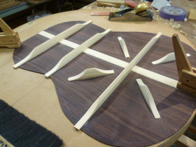

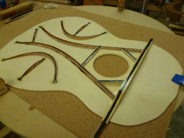

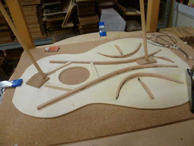

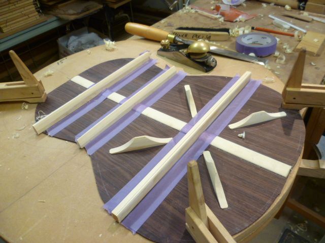

Its been a quiet time in the workshop over the last year or so mainly due to a heavy workload but also due to the earthquakes in Christchurch New Zealand and the aftermath of same. Anyway over the last few weeks I finally found time to start a new build...a falcate braced classical with bolt on/bolt down neck.

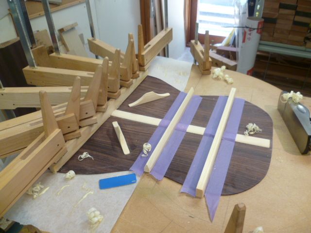

The top is Engleman from Graham Hein and its been worked down to around 2.4mm thickness after feeding tap testing data into the various formulas in Trevor Gore and Gerard Gillets books.
The top has been braced up and next job is fitting the upper transverse brace. The falcate braces are laminated from king billy pine using techniglue epoxy resin.

Post by Wayde Christie » Tue Jan 28, 2014 12:27 pm
Looking good.
Is that carbon fibre *under* the braces? I've only seen it applied to the top of the braces. Any benefit to doing it that way?
Cheers :)
Re: Classical No 13
Post by jeffhigh » Tue Jan 28, 2014 1:20 pm
Under and over is the "Traditional" approach as per Trevor's book.

Re: Classical No 13
Post by Trevor Gore » Tue Jan 28, 2014 4:46 pm
It's "traditional" in that that is how Smallman did it from the '80's onwards. It was definitely needed in his designs as he used very thin tops and balsa for bracing, so the vast majority of the stiffness was provided by the CF.
In the designs I use, the height of the braces is still ~3 times the thickness of the top panel, so all the CF is still well off the neutral axis and so still does useful work.

The heatwave continues here in Adelaide. I got the wall fan cranked up in the workshop which made things bearable despite the 37 degree heat in the shop. Bracing of the top is complete and the back bracing is 95% complete. The upper back brace didn't glue down properly on first attempt so I ended up chiseling it off and installing a new brace.

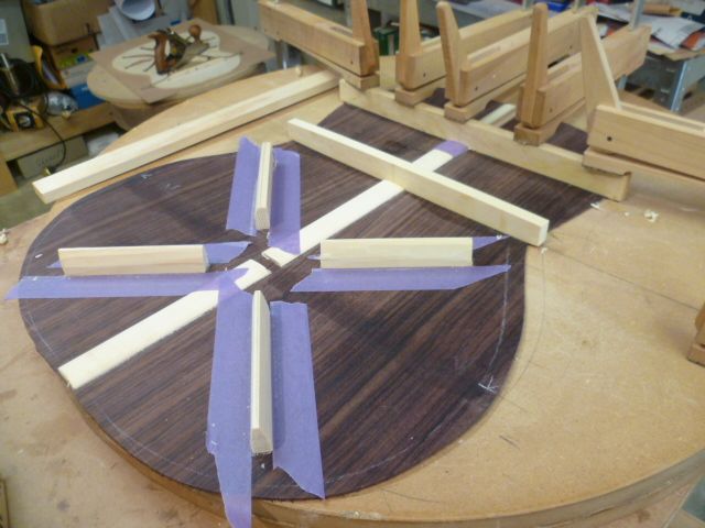

Post by kiwigeo » Sun Feb 09, 2014 12:47 pm

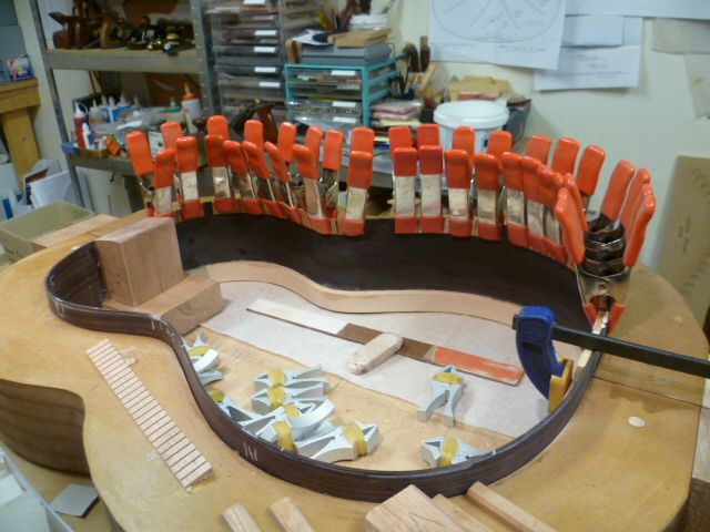

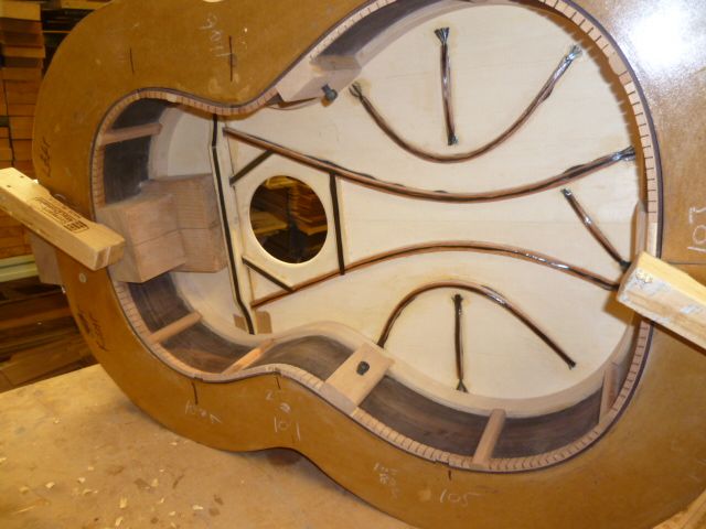

The hear continues here with a bushfire burning not far from my place most of yesterday. The car was packed and we were ready to head for the local refuge before they finally got the fire under control. Progress on the guitar has been slow but steady. The back has been braced up, the head and tail blocks have been glued in and the solid laminated upper linings made up.

Re: Classical No 13
Post by kiwigeo » Tue Feb 11, 2014 12:58 pm
A bit more progress over the last couple of days. Solid top linings glued in along with tailblock splint.

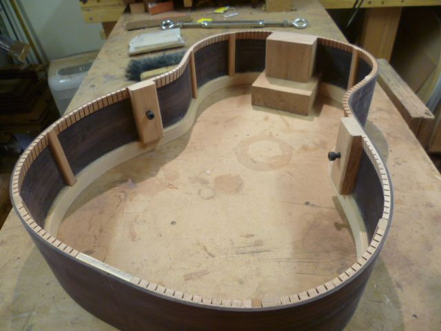

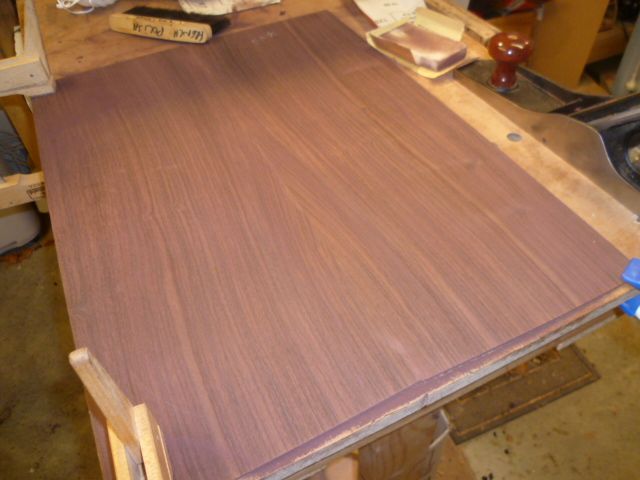

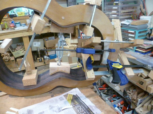

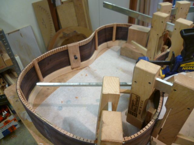

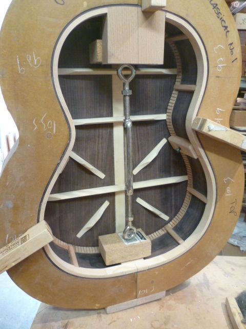

Post by kiwigeo » Sun Feb 16, 2014 9:42 pm

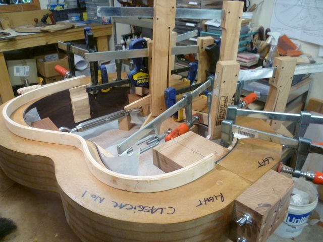

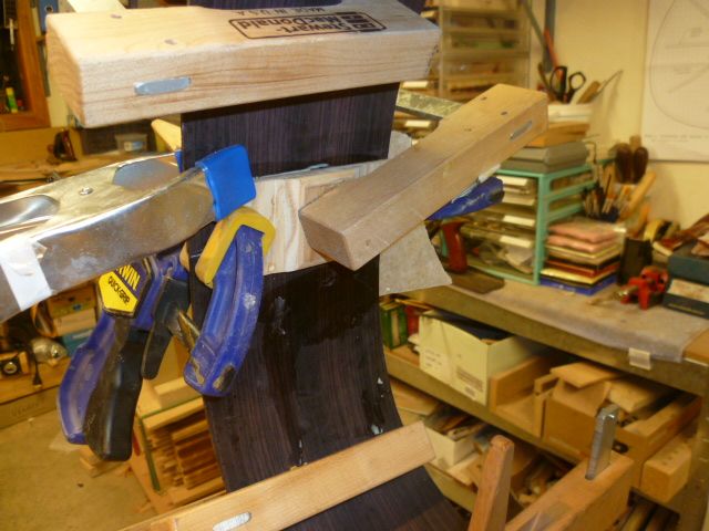

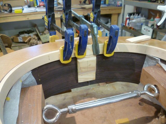

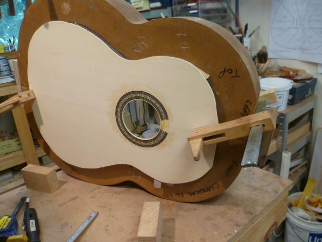

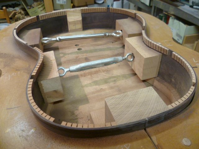

More progress on the classical:

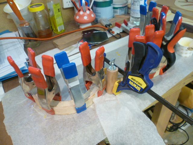

Tailblock lining splice.

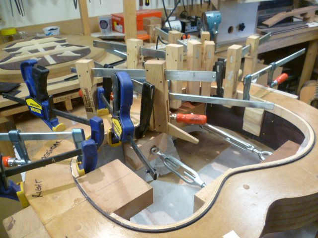

Gluning in lower (kerfed) linings.

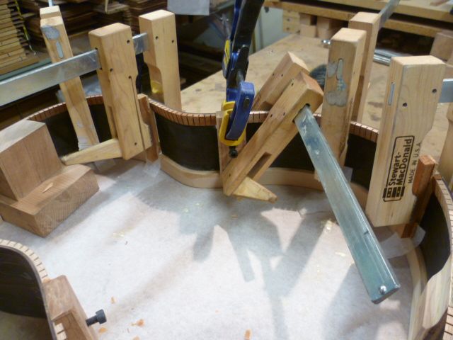

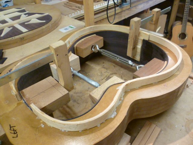

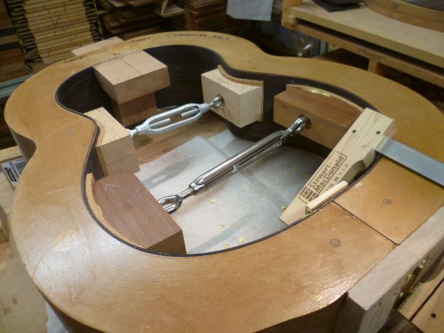

Side splints glued in. The special clamping cauls make the side "bellow out" slightly.

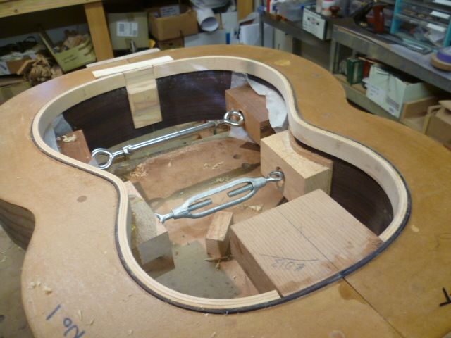

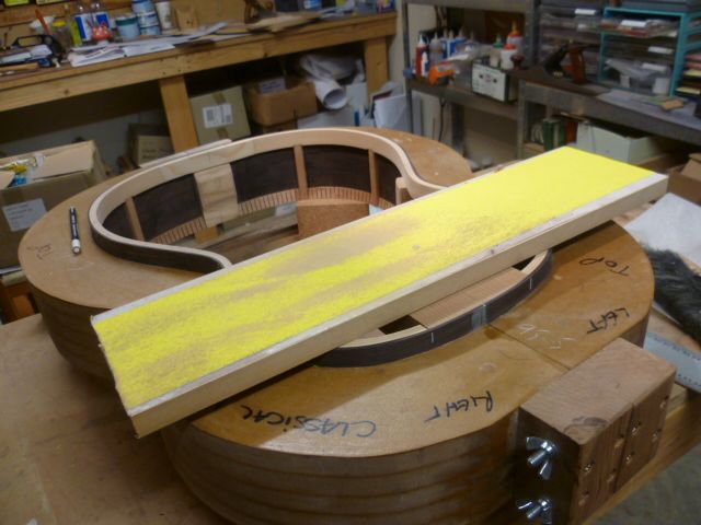

Back linings sanded to 15' radius ready for fitting of the back (top is 25' radius).
Test fit of the back.
Test fit of the top and fine tuning of the head block.

Post by auscab » Mon Feb 17, 2014 12:21 am
25 ' radius on the back , what radius will it have on the front ?
And the sanding with the yellow paper on the flat board , that just gets the flat treatment down to the sound hole ? is that right ?

Post by kiwigeo » Mon Feb 17, 2014 9:19 am
auscab wrote:25 ' radius on the back , what radius will it have on the front ?
Whoops my gaff...back is 15' and top is 25' radius. Good pick up there Rob! :oops:
Yes the upper bout between the neck and transverse brace (= soundhole) is flat.

I have not read much on classical building , I skipped through one book quickly , So I thought you will be telling me something I did not know.
When you radius the sides for the top, and then flatten the upper bout , how do you know when it is flattened enough ? does it have to match the UT brace in flatness?
Posts: 10865
Re: Classical No 13
Post by kiwigeo » Mon Feb 17, 2014 4:16 pm
auscab wrote:I have not read much on classical building , I skipped through one book quickly , So I thought you will be telling me something I did not know.
Rob,
This instrument has a bolt on/bolt down neck. On top of the neck block is another block of wood onto which the upper fretboard bolts down to. The surface of this block is flat.
Ill be using a large caul when I glue the top down so this will ensure upper bout north of the UTB is flat.
I know the neck block is flat enough when I can lay a straight edge across upper bout and it touches the sides and top of neck block with no gaps.

Ive got the books , but I will ask one more cause I'm lazy but interested right now .
The Neck block is not cut at 90 degrees is it ? It has a relief angle of 5 degrees ? or is it 2 degrees ?
