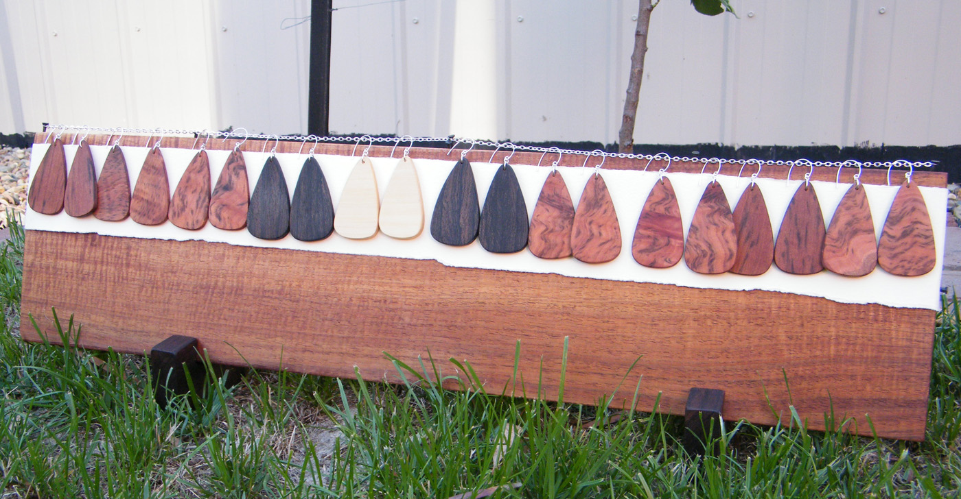

I've moved back to sealing the "knick knacks" with Shellac as per Markus's suggestion. It is a tricky thing to find a solution for as shellac is not ideal outside. Don't really want to go down the epoxy/ polyurethane road either.
That and I somehow managed to get a nasty rash from the Organoil vapour.
30 down, 30 to go - My Scraps box is getting emptier

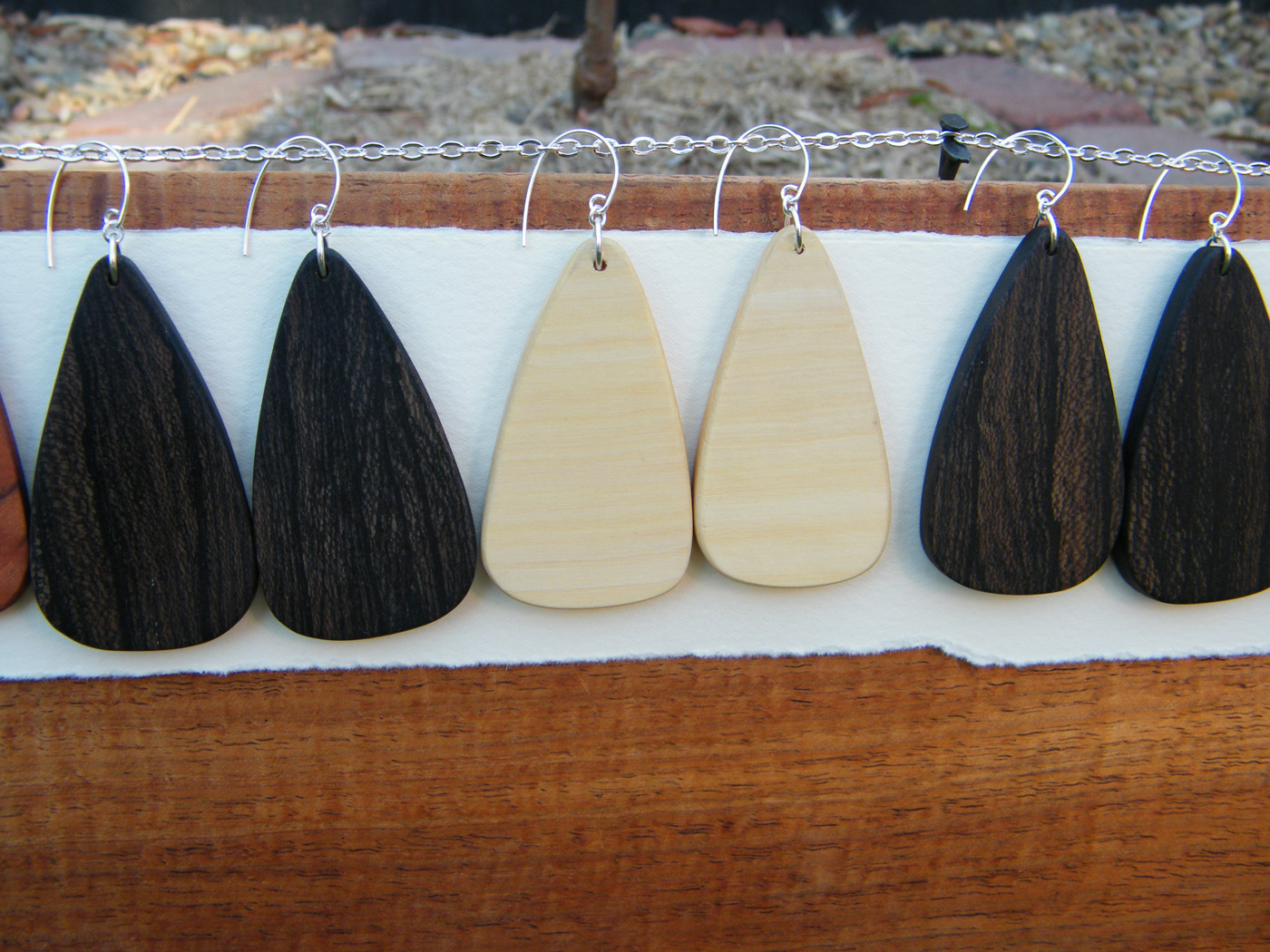

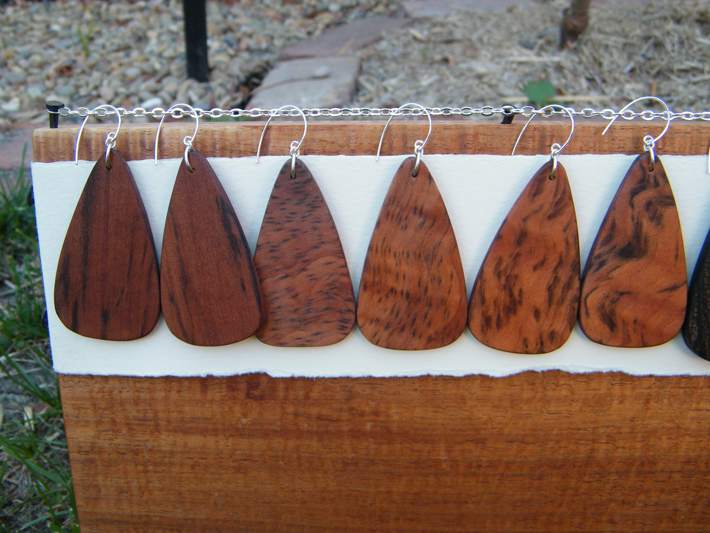

Cool Little Pendant Markus and those kazoos are great!,
I had a crack with blonde shellac earlier and just decided it was not going the way I had planned and was far too fiddly, so sanded off the shellac and oiled the pieces as I had the previous 30 pairs.
Turns out I am not allergic to the tung oil but two weeks of 30+ hours of repetitive hand sanding causes a nasty armpit rash...whoops....thankfully there is talcum powder...

Thanks Stu. Yes, shellacing little pieces is fiddly. Question is now if using violin oil varnish would be even fiddlier.
Glad that tung oil worked for you.
30 hours sanding in less than an year? I believe that such a thing never happened to me.
Cool line-up of pendants, and it is nice how the pairs are clearly defined by the figure in the wood, even if apparently not (or not always) bookmatched. BTW, what wood are the "white" ones made of?
