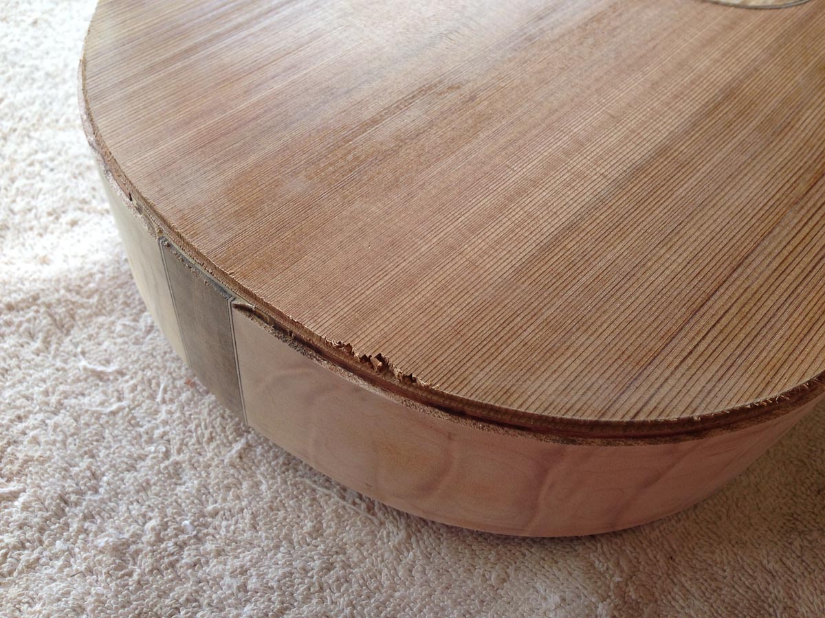

This tenor has been giving me fits with little things that just are fighting me and testing my patience and skill, with this one the latest.
I had routed the binding ledges with no worries at all, with the only thing left being a small skim around the top and back for the rebate for the purfling strip when on the last few centimetres this happened.

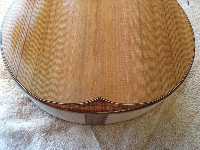

So take a deep breath, walk away and boil the jug for a cup of tea.....still not to happy let me tell you. Come back for another look and scratch my head, get worked up some more and have to walk away again. Contemplate having to replace the top and not really wanting to go down that path. So then started thinking inlay. But what sort of inlay that doesn't look like it was put there to hide some stuff up, and what goes with my Art Deco styling?
Google searches brought up all sorts of designs, but all of them too complicated to seriously consider for inlay into Western Red Cedar, and then how was I to make it look like a design element that was planned from the start.
I ended up walking through my shed a few times, and then out of the corner of my eye I saw the other 4 instruments that I have hanging in the dry room waiting to be buffed out.....and the heel cap that I use with a bit of a pointed scallop. Which I ended up using a couple of years ago to cover up another stuff up with a router. And then it hit me...........

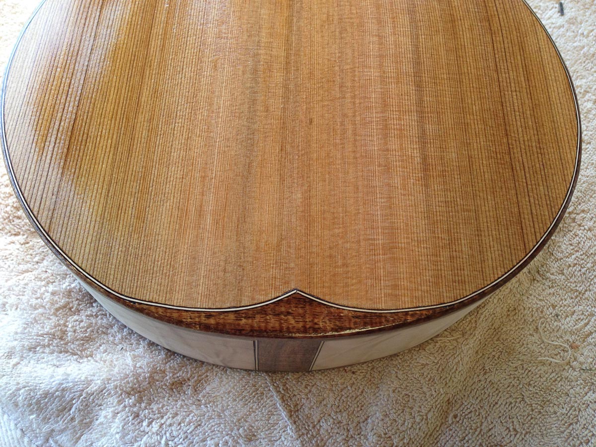

And this is what I ended up with. And pretty pleased with it too.
looks like a bum........a really nice bum
excellent fix

Nice save Allen.....only a master would think of your solution.

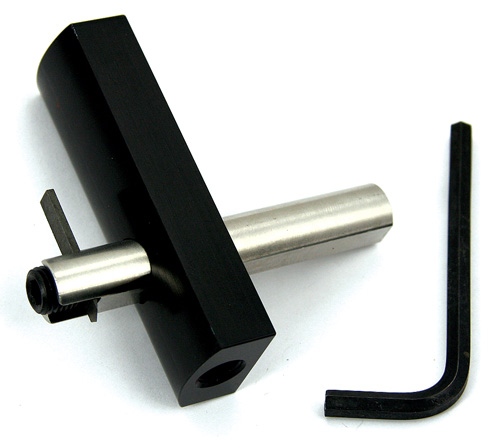

Not sure if you already do this but Ive started laying in a cut with my Schneider Gramil prior to my binding/purfling channel cuts and it seems to have reduced tear out and it also leaves a nice clean cut.

HI Allen, yep been there done that and rectified it the same way, now I use the gramil process, after 30 odd years of getting through the job with out it.

That inlay with purfling has ended up looking very nice Allen, and like Martin said the Schneider grammil is a pretty handy tool as well.

My Schnieder gramil was one of my first tool purchases many years ago but it s sat on my window sill for many years until I discovered what a great little tool it is.

For those of you not familiar with a Schneider gramil:

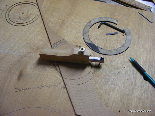

Post by Taffy Evans » Mon Mar 10, 2014 12:23 pm
And here's my circle/shape following 'Gramil' utilising parts from the the one shown above.

A bit cheeky and a brilliant save that looks part of the plan!
Nice work

Looks good Allen. great save.
