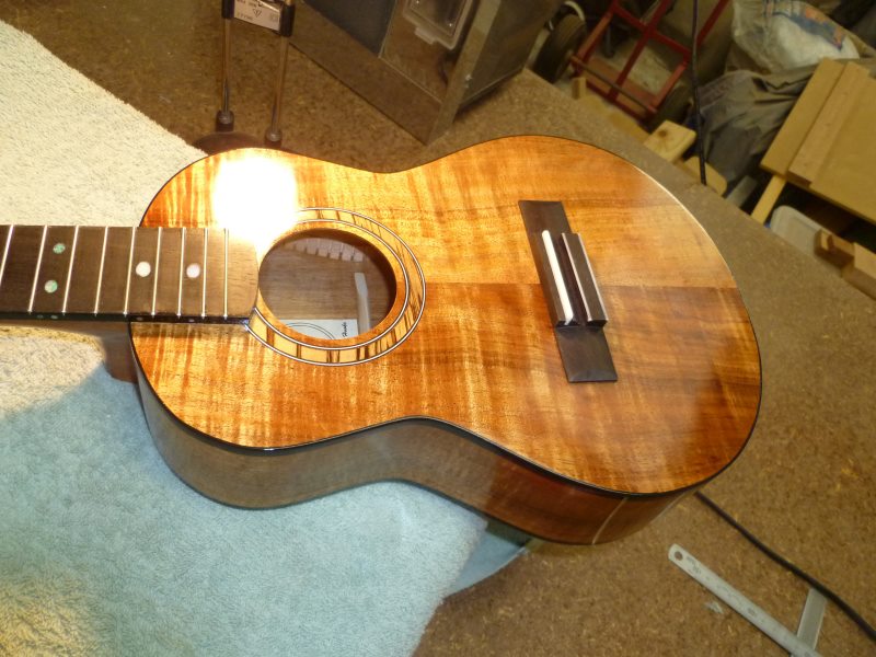

Here are 2 ukes I recently finished with 8 coats of Tru Oil.
- P1040076.jpg (81.33 KiB) Viewed 46834 times
- P1040014.jpg (94 KiB) Viewed 46834 times

They look great! Did you pore fill these? What was your process?hooked wrote:Here are 2 ukes I recently finished with 8 coats of Tru Oil.
Jeremy D
Re: Wipe-on finish for acoustic guitar
Jeremy,
Yes I gave them a coat of thinned (20% turps) Feast Watson Sander Sealer. I usually stop at eight coats of Tru Oil but I have a Uke that I'm now up to 11 coats and can confirm what others have said. It just gets better the more coats you apply. My method of applying Tru Oil is to apply it sparingly and wipe off as much as possible and don't play with it. I invert the bottle once onto a rag and that is enough for a back/soundboard. Might take a little more on a guitar. I also apply the sander sealer the same way. Wipe on, rub in wipe off. I have also used Timber Mate as a very good pore filler.
Daryl
