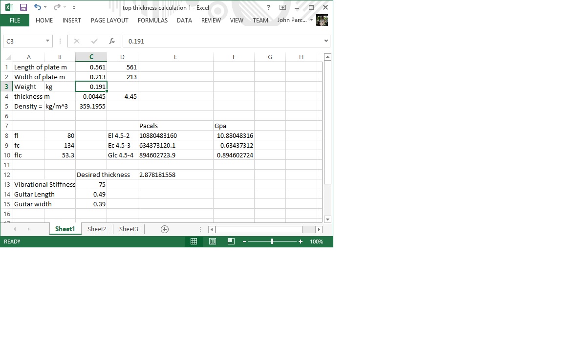

John your plate thickness calcs look ok.....I plugged same inputs into my spreadsheet and got 2.7mm as target thickness. Close enough.
Cheers Martin

Thanks Martin, I am not sure why there is the small difference, maybe the way I entered the formulas into excel.

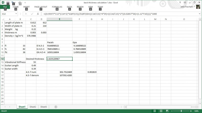

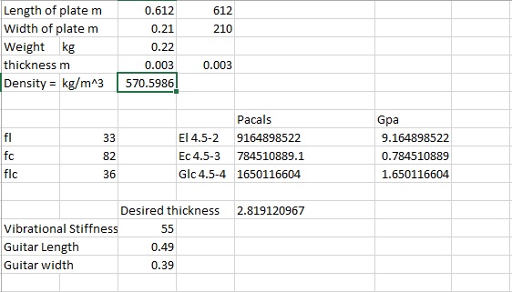

Here are the thickness calculations I got for the back. I really had to thin the plate to get all of the saw marks; I ended up right at 3 mm for the tap test. The thickness basically came out to 2.8 mm, so right or wrong it is at least a normal thickness.
back calculations.jpg (57.09 KiB) Viewed 40632 times

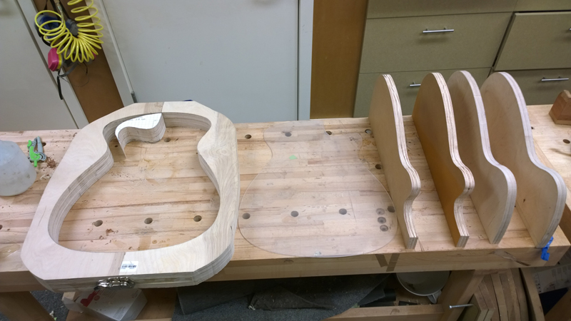

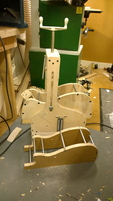

I made some progress of my bending forms. I decided to also make a cutaway form. I have a cutaway clamp on my fox style bender. I need to get some pipes to finish them off. I also need to wait for my 10 foot radish dish of that I can profiles the sides.
In the mean time I decided to see how it is bending spruce is for the tighter of the two falcate braces. I first tested a scrap 1.7mm strip of spruce I had. I was able to bend it no problem so I cut and thicknessed a few wider strips. I sprayed them with super soft II and bend them. I do not think it lasts very long, otherwise I will have soft braces. I will see in a week or so.
I am really excited about the lutz top and the Australian Blackwood back and sides.

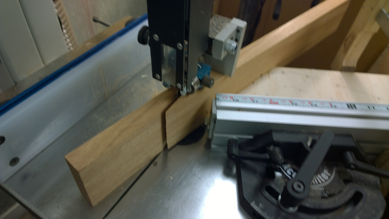

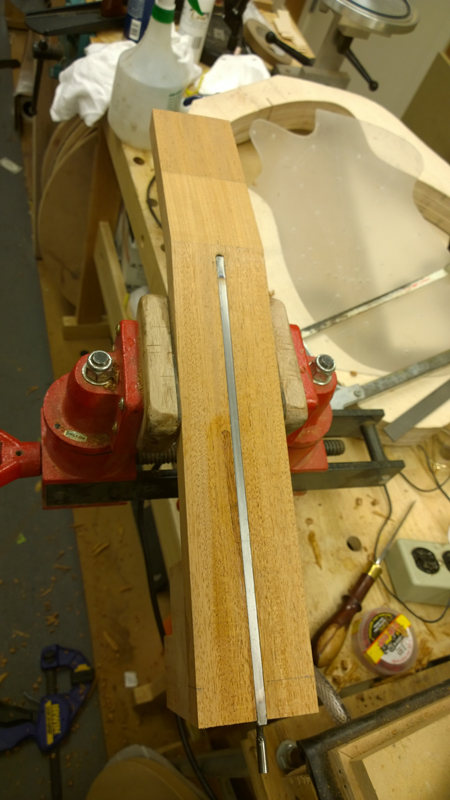

I have been working my way up toward the more interesting aspects of this guitar. Building jigs and forms is not my favorite thing and if there are templates, bending forms and molds available I will happy give the fine people who make them my business. Like the harp ukulele I made I am in the situation where I need to make the entire set of templates, molds and bending forms. Thank goodness for the copying shop, I made copies of the plans, cut them up, glued them to the plywood or Plexiglas and went to work with my band saw and sanders.
This last week I made my first scarf joint neck blank. I have been cutting necks out of single pieces of wood. I have sort of been scared of the joint as I can not cut a straight line on the band saw. Luckily my kids bought me a miter guide for my band saw. I could not cut a 15° with it but I cut some plywood at a 45 degree angle allowing to set and hold my scarf angle. It actually worked and I got a clean cut. Here are pictures of the process, including my bone headed screw up.
First I used my jointer plan to square the wood,
Then I cut a 45° angle to use as a guide for the miter. Just to be sure I made a test scarf cut on some scrap plywood
Not sure what I was afraid of the cut when as good as it could on the bandsaw and I just need ot to do a little clean up. I lined up the cut angled pieces and clamp them with a sacrificial piece of MDF, and planed the gluing surface of the joints clean and flat

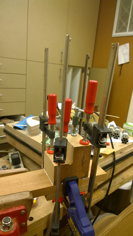

I used my shooting board and some clamps to hold the joint in place and really glued it with some heavy duty clamps.
I had a big block for the heal so I cut it into two heel blanks. Here again I planed the surfaces flat and used some real clamps to glue the heel on the neck.
Here is where the bone head maneuver came in to play. I very carefully set up the router table for a truss rod slot right up the center of the neck blank. Then proceed to start the route before tightening the router table fence. Oh well. I cut a strip of mahogany planed it and shaped it to fit in the miss-cut slot. It fit in so nicely that I just wicked in some CA. I reset the table a made a proper slot. No one will see this fix, unless they are changing the fret board in the future for a repair.
Image.
I also installed an extra amboyna rosette I made as an option for a previous guitar.

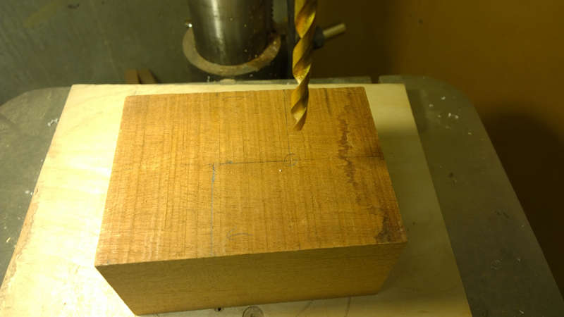

To insure proper bridge and sound hole alignment, and given that I need to drill the peg holes early in the bracing process. I used the template to drill some of the peg holes and the center of the rosette.
I did not do any fancy measurements I just used the router and it fine adjustment to sneak up of the slot I need for the rosette and a couple of thin bwb purflings.
All and all uneventful

kiwigeo wrote:I plugged same inputs into my spreadsheet and got 2.7mm as target thickness.
johnparchem wrote:Thanks Martin, I am not sure why there is the small difference, maybe the way I entered the formulas into excel.
Hi John, I'm a bit late with this, but hopefully not too late, and hopefully it is not a false alarm! I also plugged you data in my spreadsheet and get 2.72 for the top, and then... 2.52 for the back. Your results for density, El, Ec and Glc are exactly the same as those my spreadsheet spits out, so the mistake must sit in the programming of Equ. 4.5-7, either in my and Martin's, or in your spreadsheet.
T0 obtain your top thickness result I have to adjust the vibrational stiffness parameter to 79.5 (instead of 75), and for the back I have to adjust it to 61.5 (instead of 55).

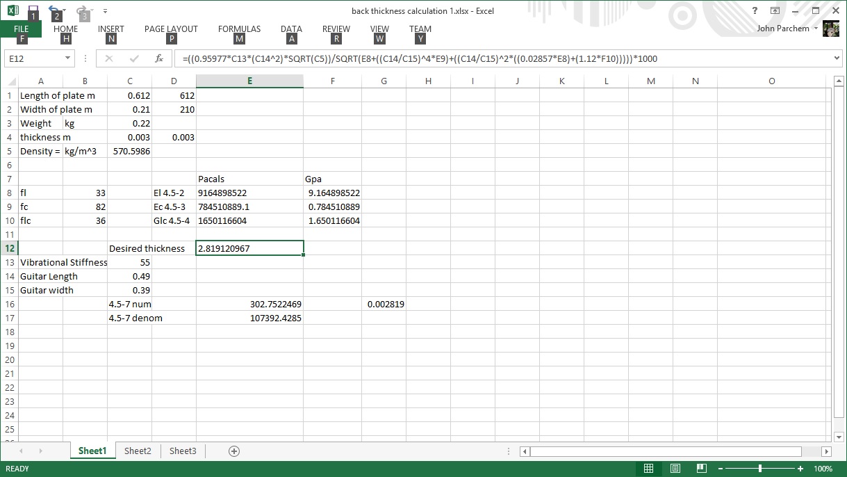

Thank you, for the check. Not too late at all. I will go back and re-code equation Equ. 4.5-7. it really help knowing that density, El, Ec and Glc are exactly the same to isolate the problem. I did go over the equation again and it looks correct as far as I can see. Here is the equation I have that matches spreadsheets in my earlier post. I am really heavy on parentheses not trusting order of operation.
=((0.95977*C13*(C14^2)*SQRT(C5))/SQRT(E8+((C14/C15)^4*E9)+((C14/C15)^2*((0.02857*E8)+(1.12*F10)))))*1000

Re: Build thread for first Gore SS from the plans in the boo
Post by charangohabsburg » Wed Apr 02, 2014 2:41 am
Yes there are some unnecessary parenthesis, but this should not hurt. The rest looks fine too. You could try to use (xyz)^0.5 instead of SQRT(xyz).
P.S.
...and then double check with a pocket calculator, pencil and a piece of paper, which is what I had done when setting up my spreadsheet. :wink:

Thanks, I tried (xyx)^.5 and I tried separate calculations for all of the products in the denominator.
I think a calculator will be my next go.

Post by johnparchem » Wed Apr 02, 2014 6:38 am
Thanks for the help, taking the time to run the numbers. It turned out I was using Gpa instead of Pascals for Glc.
When I did the partial products for the denominator I noticed a product too small to make a difference.
Now I get 2.71 mm for the top and 2.61 for the back!
Now I can get an active back.
Post by charangohabsburg » Wed Apr 02, 2014 8:42 am
That one seems to be fixed. Well done! 8)
I hadn't looked up which data (cells) you run through the formula. A very common mistake to use a wrong cell though, a simple typo I guess.
The idea to use ^0.5 instead of sqrt came because I remember having gotten strange results with Excel's SQRT function handling very large and very small numbers two decades ago or so, which was when I stopped using it. I even forgot it existed!
johnparchem wrote:Now I get 2.71 mm for the top and 2.61 for the back!
Is 2.61 for the back another typo?
I get 2.71706 for your top and 2.51852 for your back (with the data you provided in the beginning, of course).

charangohabsburg wrote:That one seems to be fixed. Well done! 8)
Hmm I get 2.71705951 for the top so we are at a very insignificant rounding difference
Just cut and pasted my fixed top equation into my back spreadsheet that had my fix but with other changes and I got 2.5185. Now I will call it good!
Thanks again,

Post by charangohabsburg » Wed Apr 02, 2014 10:09 am
johnparchem wrote: [...] and I got 2.5185. Now I will call it good!
...or if it is wrong, at least we made the same mistakes! :mrgreen:

Post by johnparchem » Thu Apr 03, 2014 10:36 am
Thanks to Markus, see above I found I had a small error in my equation for plate thickness. My error basically took the diagonal stiffness measurement out of the equation give me a slightly thicker plate.
So now my top plate target is 2.7 mm and my back (I want an active back) number is 2.5 mm. It did not make much difference on the top but it did make nearly a 10% difference on the back.

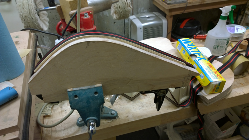

While preparing my primary braces for gluing I planed one lower then I the target height. I finished one brace, was starting on the other and got distracted and planed down the finished brace. Oh well. I got to try a new way to laminate these braces. I sliced and thickness three long 25mm by 1.7 mm german spruce strips. As before I bend them with my iron and a mist of water to close to the correct bend. This time though I used the inside cut out material from my mold to make a brace mold and used a strap clamp to pull the strips together. This technique was in the Gore\Gilet Build book.
I waxed the mold and strap with paste wax but ultimately I also used wax paper when I laminated the strips with System 3 structural epoxy. The result was a perfectly shaped brace with no spring back.
I cut the 25 mm braces into two braces and used a plane to take them down to just a bit more than 7mm. The 7 mm is my target height for the brace before I shape them.
I laid out the braces and the bridge plate on the top in my modified 32' Radius dish I drilled four index holes in the dish so that I can use them to index the top, the bridge plate and the braces during glue up.
With every thing in place I marked where I need rebates in the primary braces. Also I tested out using thinned Teflon strips to center the braces between the peg holes.
No excuses now I needed to take epoxy to my relatively clean top. I got every thing I was going to need close to my go bar deck. This included a piece of carbon fabric I cut for under the bridge plate and three (one extra) fibers or yarns from the weave of the carbon fiber for under the braces.
I mixed up a cup of West System 105\106 epoxy for the glue up. I used a brush to wet the top along the brace path and the area marked for the bridge plate. I applied epoxy to the strips just enough to wet them and laid them down in the center of the brace locations.
Sorry for the lack of pictures I has epoxy on my gloves. I also applied epoxy to the carbon fabric shaped for the bridge plate and put that down. I used a pointer to push open the fabric and inserted my 3/16 pins I am using for indexing. I pushed the bridge plate and followed with the two braces. Go-bars on every thing, my spacer strips between the braces and the index pins . So now I either have a complete mess or tomorrow I will have a top with epoxied primary braces.
While waiting for the epoxy to cure. I finished my two side bending molds. I again used what is probably a common technique but one I got from the build book to drill the holes close to edge of my bending form.

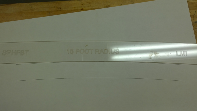

Then back to the go-bar deck. I have gotten pretty neat with with LMI glue but I am a mess with this epoxy. Maybe if I did not use my gloved fingers as squeegees for the fibers I would be a bit neater. While gluing down one of the falcate braces I did need to lift it, remove excess epoxy and relay it as a bit of the carbon squirted out. The was no problem gluing all the braces seen in the working time of the epoxy.

Here is my top with the carbon fiber on the finished braces and gluing down the forgotten brace. I go back and look at the pictures in the book and Trevor's epoxy work with the carbon sure looks cleaner than mine.
Next I need to build a gluing caul for the UTB. This design knocks a bit of curve to make the neck angle work out. The book list out a procedure to make it. I think I will draw it in my cad program and print it out.
