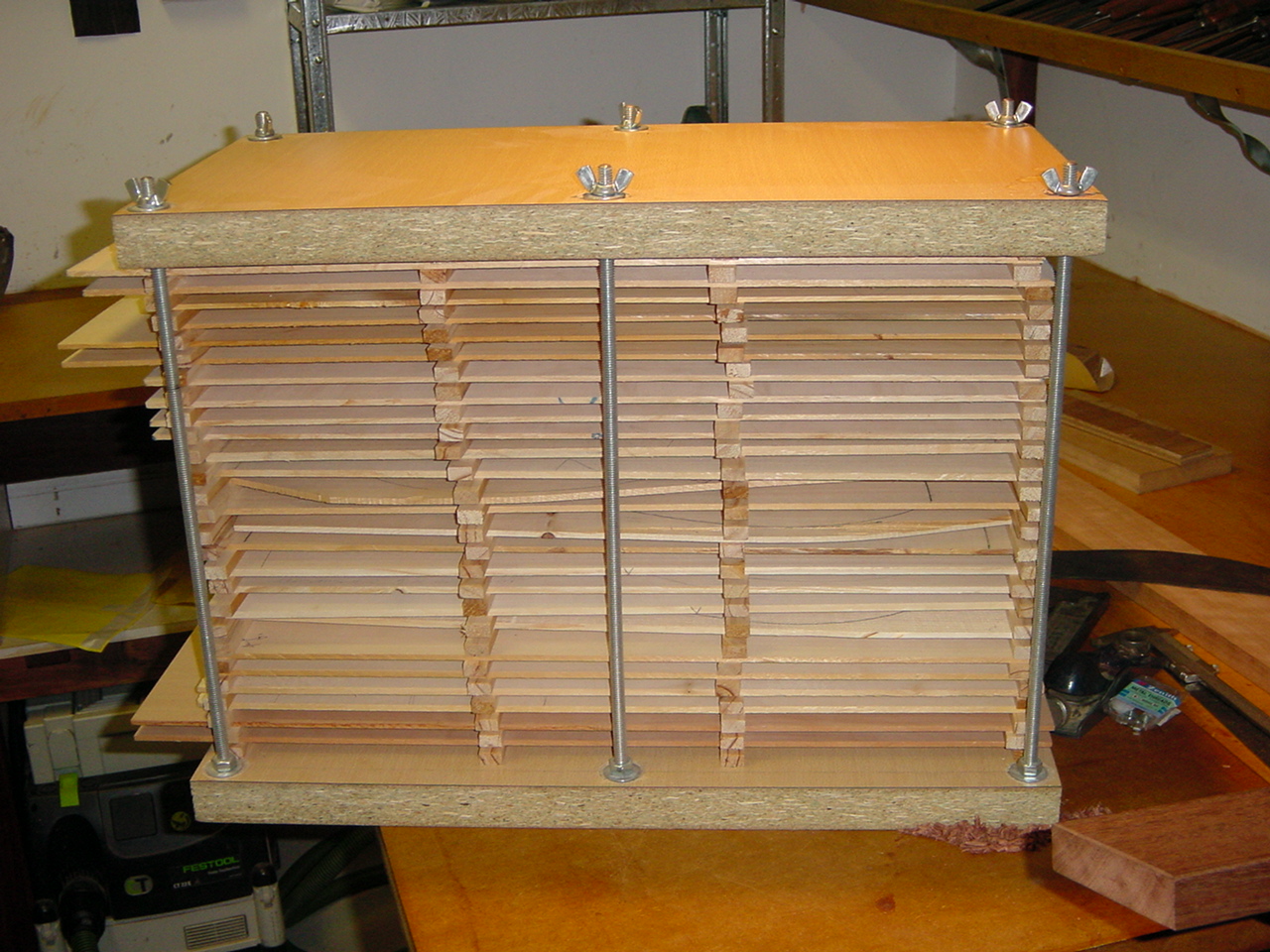

Resaw your wood into back and side sets while it's still 'wet'. Then sticker it out in a press with 19mm sticks running an oscillating fan on low over the stacks. At first you need to unpack the stacks to move and rotate the stickers every couple of days to prevent mold growing between them and the wood below. But they do dry out pretty fast that way.

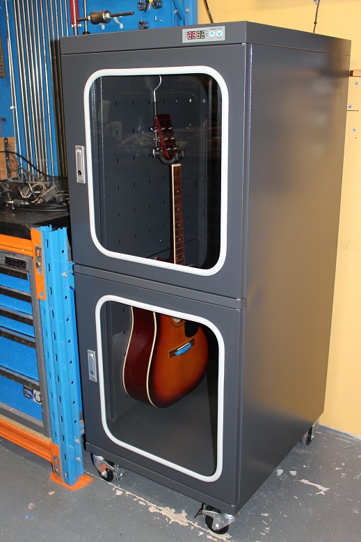

I buy a lot of stuff from china, because simply I cannot make it as cheap as they can or more importantly do not have the time to setup a machine / jig or process.
So china suppliers got back to me today, they can supply me to my door in 3 weeks one of the following, also the inside of the dryer is big enough to hang a guitar inside (may be handy for repairs)
Machine one, humidity controlled cabinet 1-20 percent relative 40 watts an hr power consumption
or
Machine two, humidity controlled cabinet 20-60 percent relative, 20 watts an hr power consumption
Both cabinets can display the temperature but are not temperature controlled.
or if I get a temperature controlled unit, the price triples, so I am thinking maybe I could rig up some heat lamps inside or just light globes to warm the air up for drying
I like the 20-60 percent unit because I can use that for rehumidifyng guitars in a controlled environment, we are always rehumidifying guitars 2-5 a week in an uncontrolled environment at the momment just via tricks of the trade, but would it be suitable for removing moisture from the rough machined wood. ??, or should I go the 1-20 percent unit

Re: Wood drying ovens
Thanks everyone for the replys
One of the issues with commercial business with employees is work safe Australia, so everything has to be built to a code and wired to a code.
So for this reason I bought a medium humidity cabinet from overseas, it's big enough to hold a guitar and controls humidity between 20-60 percent dependant on what you select
I just have to be able to raise the heat in the cabinet, so hoping when it arrives, that I'll just be able to fit some heat bulbs to achieve this, fingers crossed
Newest arrival, Humidity controlled enviroment, put a guitar in for a test run, I just need to put a heating circuit in, Im guessing a light bulb controlled by a temp control unit
Then it can become a small style dryer for tree trunks for making drum shells and hopefully clarinets
