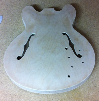

Got a customer doing a guitar building course and he is doing a 12 string jazz,
He has cut the F holes after shaping the top and before attaching to the cutaway section
Current progress
Current progress
- IMG_0152.JPG (42.04 KiB) Viewed 6471 times
