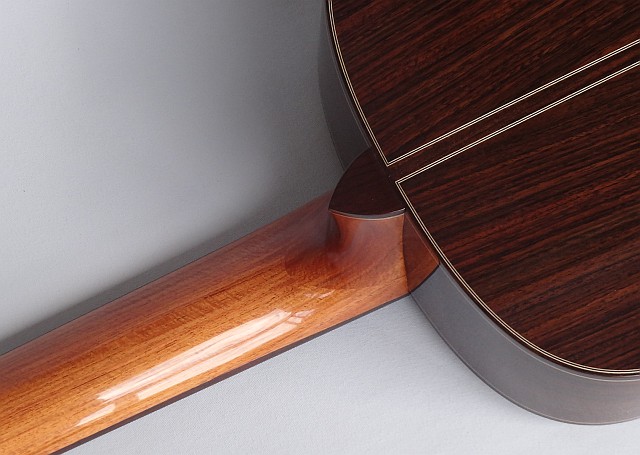

I put the back strip in this guitar after the box was closed. Flexible straight edge, good double stick tape, a laminate trimmer with an adjustable fence and a steady hand. Start with a cut (bit size) narrower than the intended inlay, because if any cut wanders, it will be the first. So use, say a 3mm bit and work to, say, an 8-9mm slot, at ~1.5mm deep. The centre should match the binding (rosewood, by the look of it) and then the BWB either side, mitred into the back purfling. Once you have a good parallel channel for the inlay, size the rosewood so that it is a tight fit in the channel with the purfling. You can try to match the channel to the centre strip width, but that means you need really good control of your routing (difficult with the compound curves). You should finish up something like this:
Back strip.jpg (66.85 KiB) Viewed 26478 times

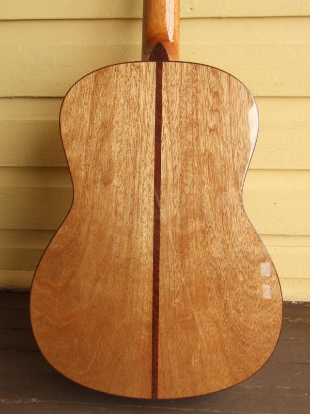

Post by mhunte12 » Mon Jun 02, 2014 4:22 pm
The wisdom of crowds...
Despite being pretty nervous, I cracked on with your suggestion yesterday evening. Made up some straight edges for the router to follow and cut the channel to suit the rosewood / BWB pattern I had decided on.
Used a chisel to extend the trench to the existing binding, then a scalpel to cut the mitre into the existing perimeter BWB. After that, things got a lot easier - just cut the rosewood & BWB to length, mitre accordingly, glue, clamp, scrape and breath massive sigh of relief.
Thanks ever so much for the advice - I'm not sure if I'd have ever got here without some pushing, but I'm really happy with the results. Hopefully it's all downhill from here!!

Post by mhunte12 » Mon Jul 20, 2015 10:58 am
Just to round this topic out completely...
The back is still holding together, despite the challenges of another surf coast winter:
Finally got around to fitting the neck (tapered dovetail, never again), finishing and setting the guitar up, and was finally able to have a play with it this weekend. I was quite surprised how much the tone developed in the first few hours of playing (it's getting better and better), and overall I'm really pleased with this as a project. Overwhelmingly tempted to buy up some more wood and start on #2...
Thanks to everyone who supplied advice during the darkest hours of this build, it was enormously reassuring to have some experienced opinions on the way forward. Thanks!
