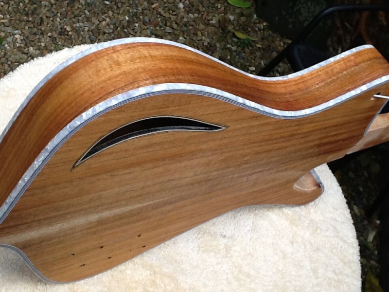

Like Alan, I've tried it a couple times. Here's one-a very long project-but you get the idea. Sand and scrape just like timber, I do....
