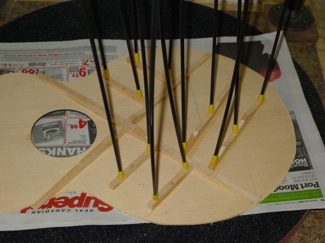

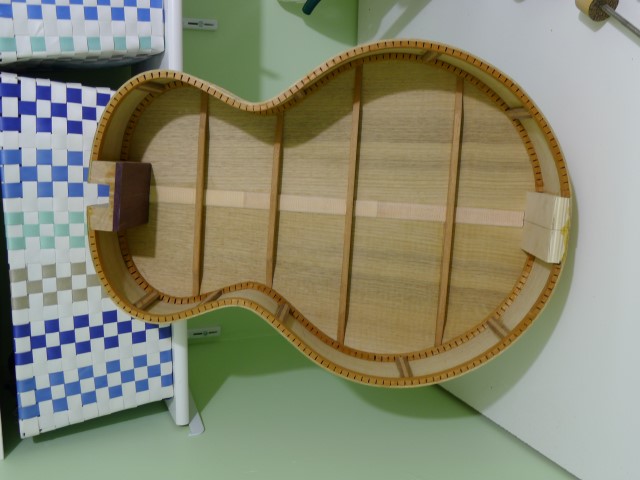

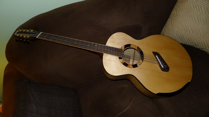

I've mad a mandocello based on a Gibson LO body shape but with fan frets to solve the C string issues and 14 frets to the body..
I used a x brace pattern modified to fit the fanned frets and get bridge angle.. turned out quite good IMHO..
Some pics attached best I have of the bracing.. Scale was 24.75 treble and 26.25 bass with the 6th fret parallel..
