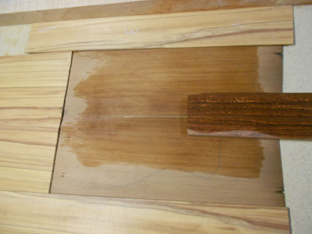

Well this is what I am considering, please tell me if it won't work.
? cedar top
Rimu back & sides
snakewood fingerboard
Rosewood neck
I did consider silky oak for the neck as i have a nicely figured piece about 70mmx70mm, would that be possible?
? cedar top
Rimu back & sides
Rosewood neck

Re: I am going to have a second go.
Is that NG snakewood or South American?
The NG I have does not seem hard enough to cope with string wear on a fretless
I bought it at the Sydney woodworkers show a couple of weeks ago and I would say it's NG snakewood.
If you think it's to soft I have some macassar ebony that might be long enough, I also have some tight grained rosewood and some ebony from where I don't know I have had it for quite a while it has a tighter grain than the macassar. I thought a softer fingerboard would give me more mellow tone.
That's where I got my snakewood too. Mal Ward said it was NG.
A softer fretboard will wear badly rather than mellowing the tone.
Macassar would be good.
