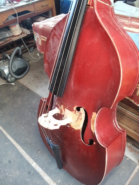

Hi all, the opportunity arose so i thought it was time to broaden my horizons a bit the story goes, i saw this bass up for sale inc. bow, soft case/gig bag and damaged belly, picked it up for less than $300, someone has already had a go at it but a very amateurish job to say the least. The instrument has laminated plates, the label says it's 14 years old and maybe European, not sure if HHG was used in original build or not, now here's the cruncher,,, i want to pick the brains of my fellow forumites as to how i tackle this repair job. Do i take the belly off or the back to gain access to guts of the problem?if the belly has to come off do i take the finger board off first? If HHG isn't what is holding this together what is likely to be? and is heat and steam the most appropriate tool here?
Any pearls of wisdom offered here will be much appreciated.

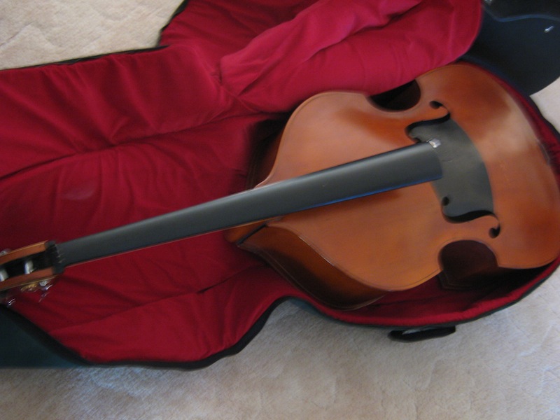

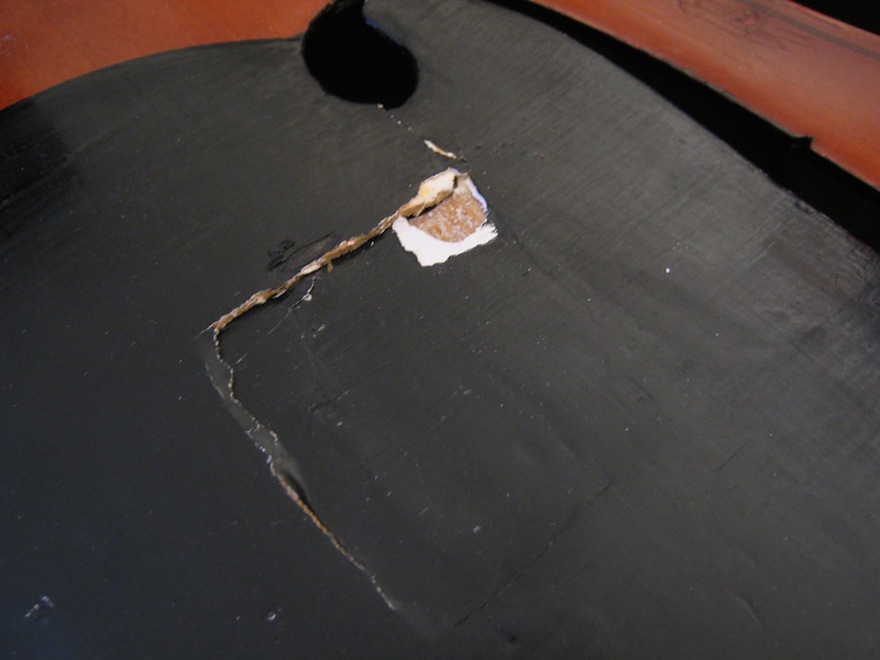

What the,
Is the whole black area a replacement section fitted (badly), or have they painted the original area black after attempting and failing at the repair of patching a split top at sound post location
It looks really bad
It looks really bad

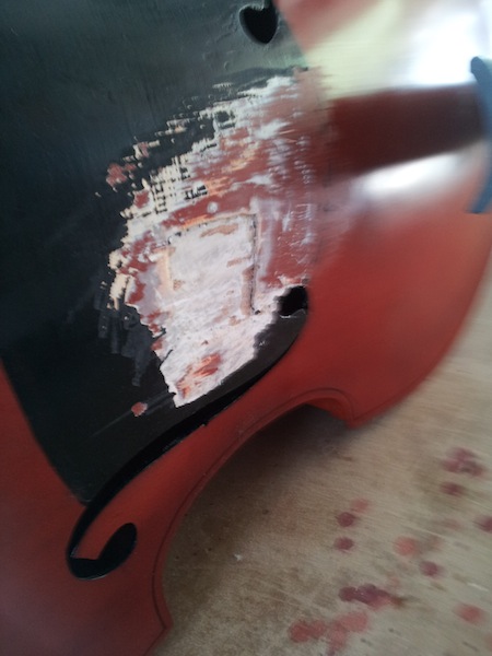

Yes the area has been painted black to disguise the shitty repair attempt, i can feel a couple of chunks of timber has been glued beneath the area when feel inside the "f" hole, this will all have to come off and a proper repair done, so i'm hoping to be able to get inside and up close.
Re: Double bass resto/repair
Okay, you may not have to remove top or back, but you do need to remove all the black paint so you can see what has been done, it appears they have cut a section out and then tried to graft a section in, is this right
Silly silly way to repair a soundpost top split.
Once you have the old repair removed post photos and I can walk you through the repair process, you wont need to remove the top or back,
If you wanted to remove for repair, then you remove the back, I would use steam and a blade, at a guess it looks like a cheapie, so they would not have used hide glue, but used a yellow glue, so heat and steam, just go easy around the neck heel extension. It kind of looks like they have yanked the top of and made an absolute mess of it

Looks like there's even a coat of finish plaster on there...

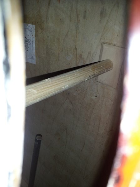

Thanks for your advice Mathew, I suspect the first failed attempt at repairing this has used a foreign piece of material, ply as well, as the inner upper edge of the F hole is very thin and protruding out of line of the arching this i think would explain the use of a plaster type filler closer to the bridge area, i think a flat bit of ply was used and the only shaping was done with the filler. I was thinking of using some spruce stock as a patching material and carving to shape inside and out, do you think this will be compatible with the ply? also i'm fairly certain hhg wasn't used in the original build, is steam and hot knives and wedges and patience going to be sufficient for this novice bass repairer?

I cant really tell from the pics but if the edge of the FF is misaligned this is most likely because the top is deformed. Much less likely someone has inserted flat ply in there (although i could be wrong) To get the top back into shape you need to press it back out to the right curve using heat and weights AFTER you reglue the crack but BEFORE you put in the patch.
Also check the ply at the back where the soundpost sits. if it is bulging you may wish, while the top is off, to add a veneer patch there too to spread the load. tis often done.

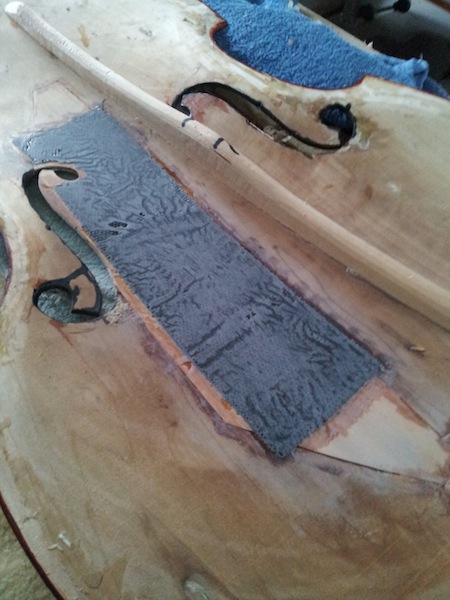

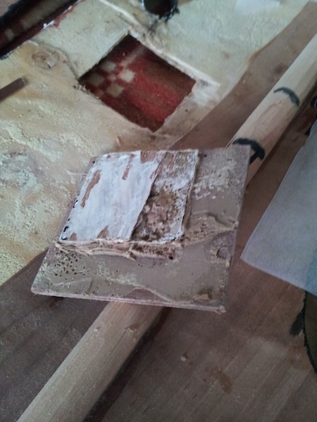

It's been a while but i've finally started on this repair job, some pics to follow ,,, but the top really is in a bad way, it's a laminated top and when it was impacted part of the lamination layer has been ripped off inside for about 600/700 long, the original repair was a very bad attempt, 3 or 4 layers of ply wood and a coat of plaster filler.
I'll take some pics and get them on here soon!!

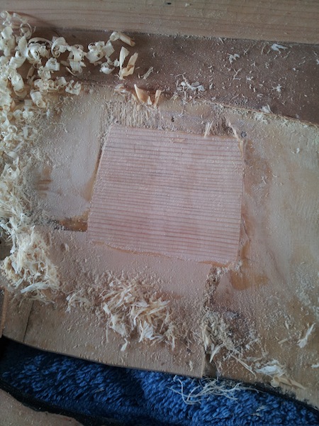

Thanks for this very good advice Mathew, i thought i'd follow this with a bit of a variation rather than invest more time and money on building a new top for it.matthew wrote:Proper way to do it:

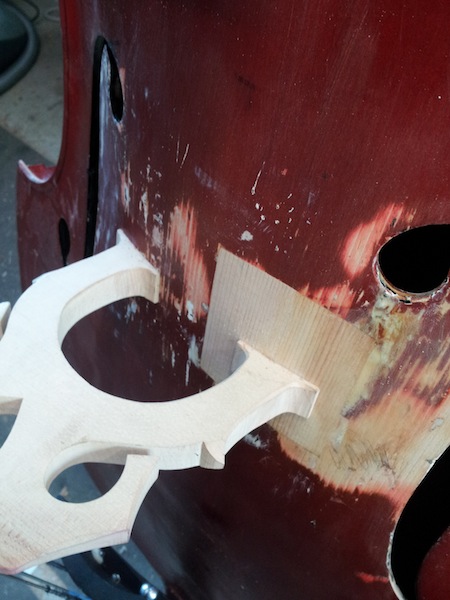

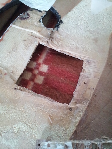

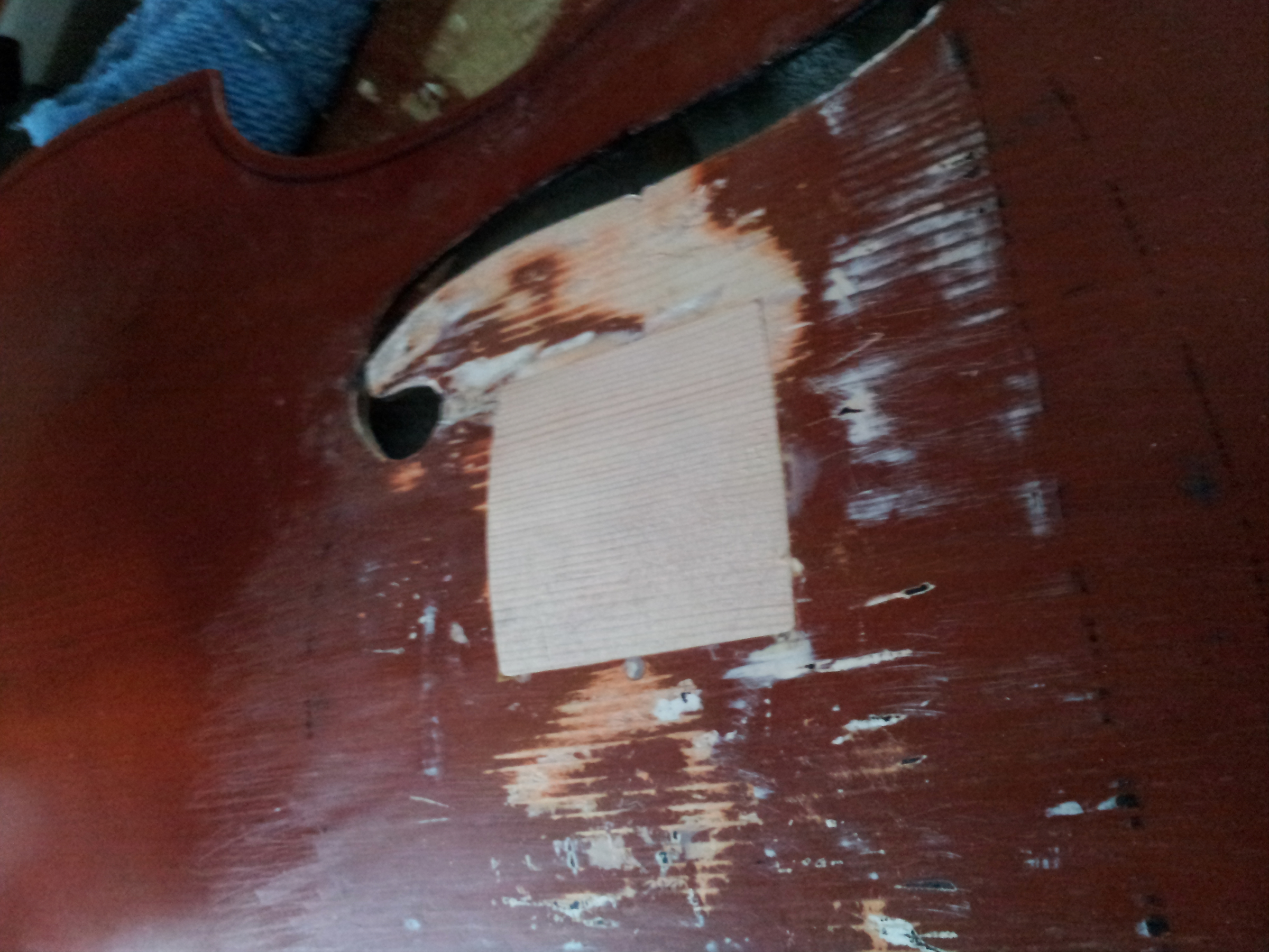

I got the top off ok but did damage it a bit, fixable though, fitted a patch, replaced veneer inside and reinforced with c/f tape. i still need to replace some damaged bits, some by me and some by others, looks like it,s been stood on, edges of middle bout are damaged a bit.

Clearly not a hot topic this one, some might think that it's a time waster but i took it on as a project for some experience and it's proving to be just that.
I had a little trouble maintaining an even margin from the top to the sides but i managed to get it back on ok using hhg, refitted the bridge and sound post and strung it up, i intend to keep it strung for a few weeks and inspect for any signs of failure in the belly, and if it stands up to the test i'l then proceed with the new finish.

Looks like as respectable a repair as you'd hope for on a bass like that!
Aligning the overhangs is a lot easier of you place the bass top upside down on some trestles, then fit the body over it. You can see the overhangs clearly and adjust the clamps all around till its right. Then loosen a few clamps at a time and work the glue in on a spatula, and you don't get any drips on the inside.
And that patch doesn't look too bad from the outside. Well done!
