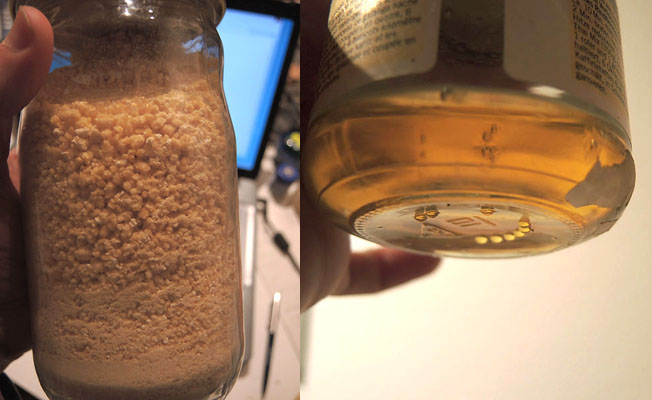

Not sure it's the same, it is only called "white", the actual colour is what you see in the picture.
Having gotten curious if what I still have would dissolve at all (bought it in 2011) I gave it a try using denatured ethanol from a half-empty bottle I bought two years ago. Much to my surprise, after 2 hours most of it was dissolved, and you can see in the picture how it looked like another 2 hours later.
I am wondering now why I had a slight problem with the same batch about two years ago, but not now. Maybe it is because now I only used a bit from the clumped stuff on top in the big jar, maybe it is the fine powder on the bottom that turns bad because of the greater surface/volume prone to oxidization. During the first half year I left it the paper bag it came in and stored it in the cellar (RH 60% and more, 12-20°C), after that I put it in this jar and then always stored it at room temperature (20°C, except during 2 months in summer when it gets up to 30°C), RH normally 40% and less, I don't recall how it was when I closed the jar last time.
