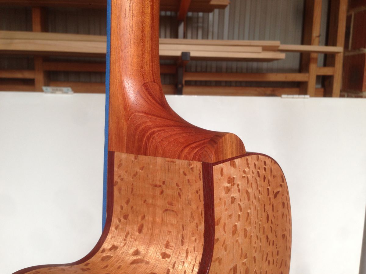

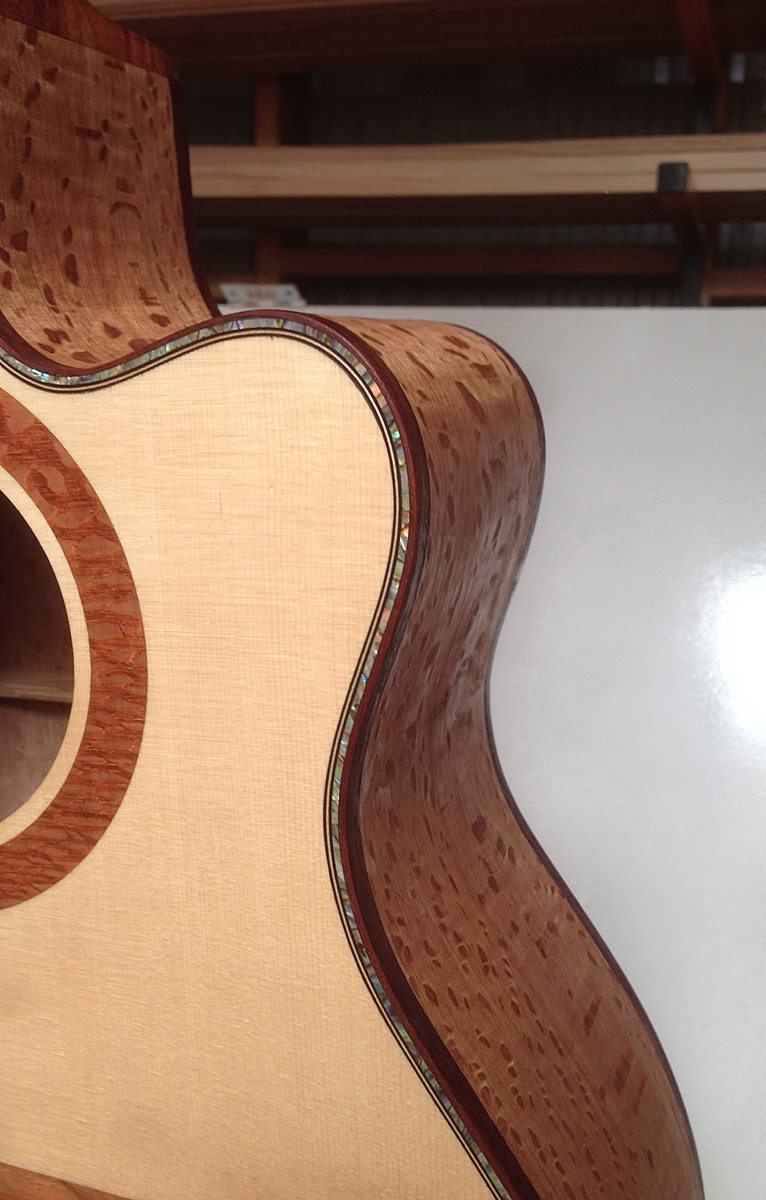

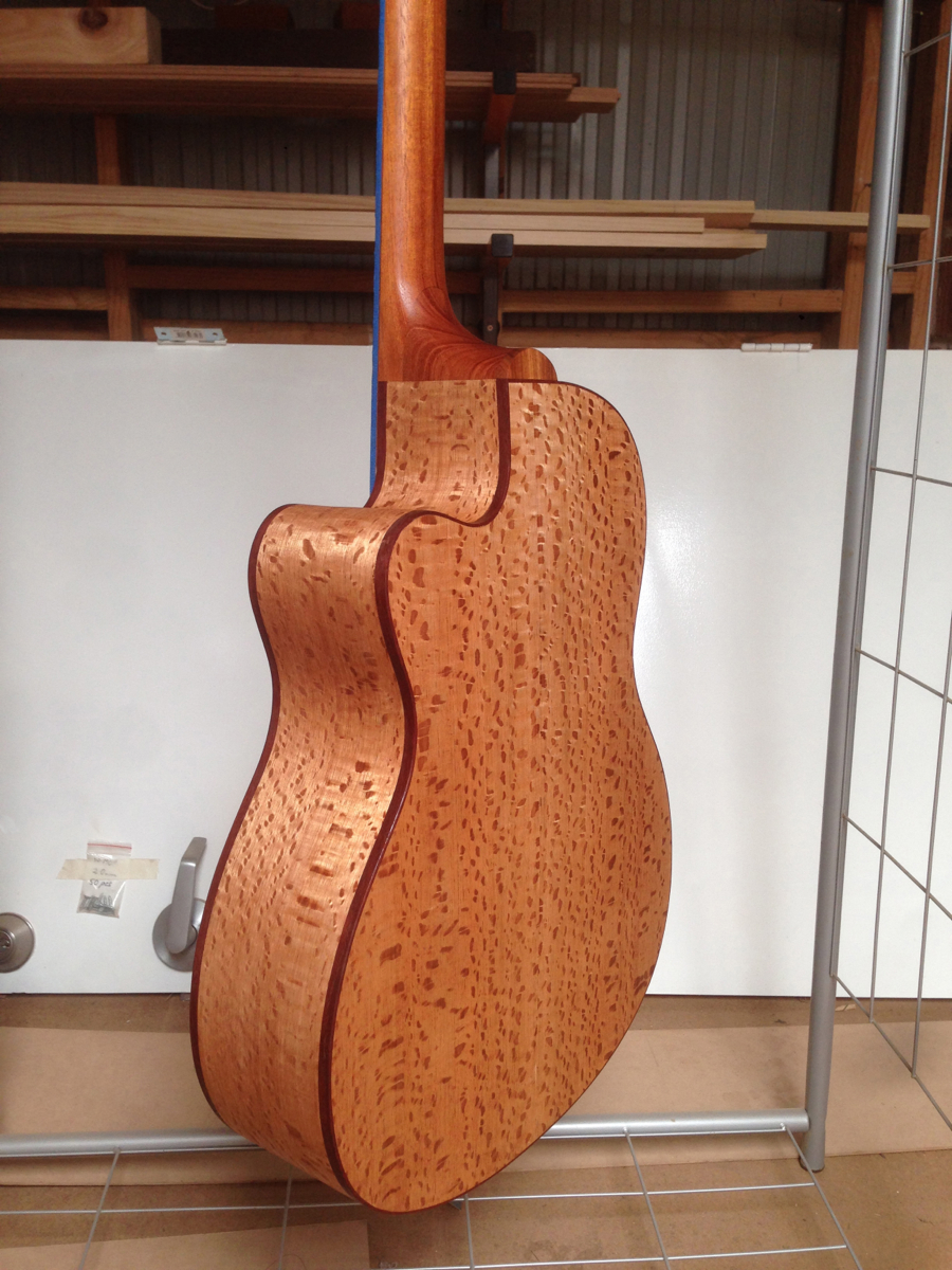

Hi All,
Well, I've been really busy this year with the starting up of the Australian Guitar Making School on the Central Coast. Don't worry, this isn't a plug just a proud teacher moment. Below is one of the first student guitars nearly finished.
Back and sides - Northern Silky Oak
Bindings - Jarrah
Neck - Brazilian Mahogany
Top - Engelmann Spruce
Zipflex (cheating? well at least it worked!)
Back and sides looking good so far.
Nice tight joins

Hi,
Nice build. Interested to know how the cut-a-way was bent, thickness, wet or dry bend etc. As I tried to bend some Brazilian Lacewood for a cut-a-way but was'nt sucessful. Any info appreciated.

Hi Wayne, the side did the cutaway was thinned down to 2mm then soaked for an hour before bending by hand on a bending iron set at 185 deg C. We've found that to be the best combination for the students.
