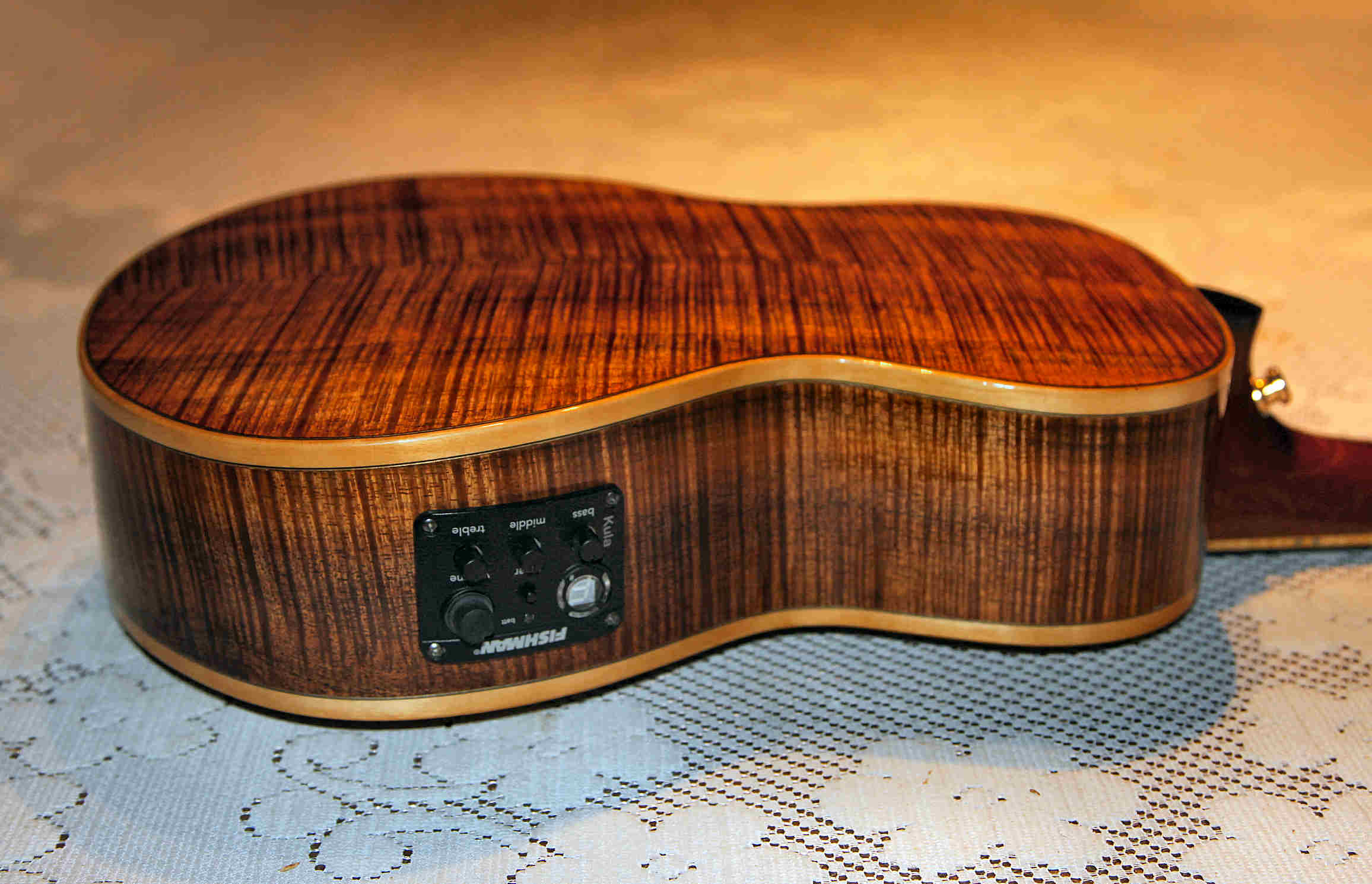

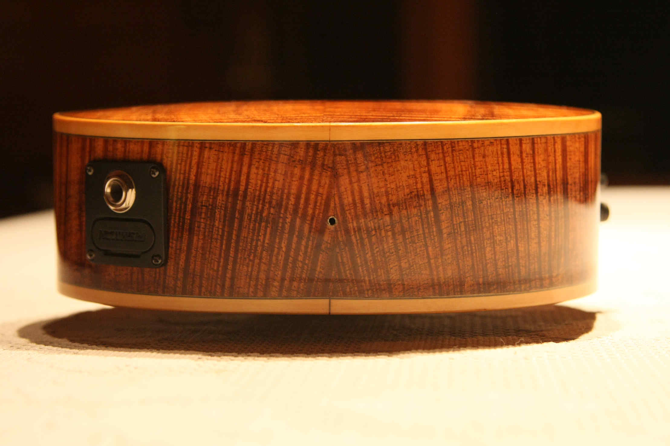

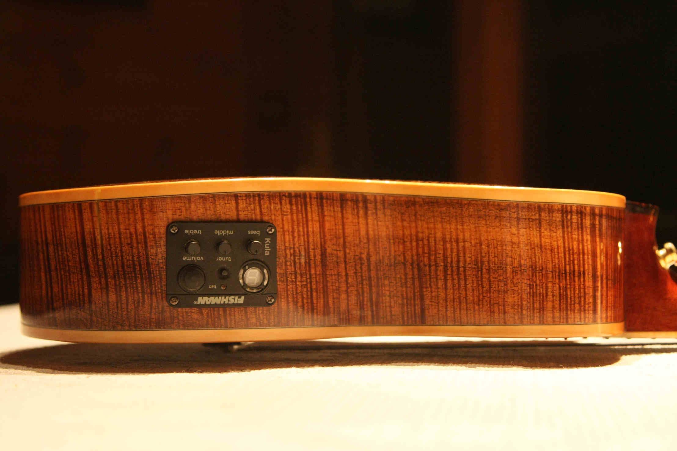

As a follow on here is a post that shows a tapered uke and a non tapered uke both with a 15' back radius. viewtopic.php?f=25&t=6547

Thanks John for the photos. I agree the side taper looks more elegant.

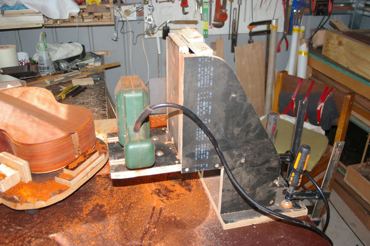

Ways for accomplishing this sanding at a correct angle include:
1). Sticking sandpaper into a radiused dish (the same dish as used to impart the curves while preparing or gluing in the braces) , and sanding all the linings, sides and neck- and tail-blocks;
2). Sticking sandpaper to a single bar of wood into which a curve equivalent to the "doming" of the back has been cut, and running this the bar from the neck-block to tail-block, sanding everything in its path, to the correct angle(s). This is my preferred method; you can get away with using a minimal amount of sandpaper;
3). Guessing it, or not worrying about it;
4). Using some other form of device or system - and in this regard I mention the "Ukulele Crown Sander.pdf" available from the same website whence you bought the plans (and it took me a while to figure out how to use this device, once I'd made it!) This is supposed to assist with the neck- to tail curvature, not the side-to-side curve, or angle, but I guess one could modify the device shown in the drawing, to do both!

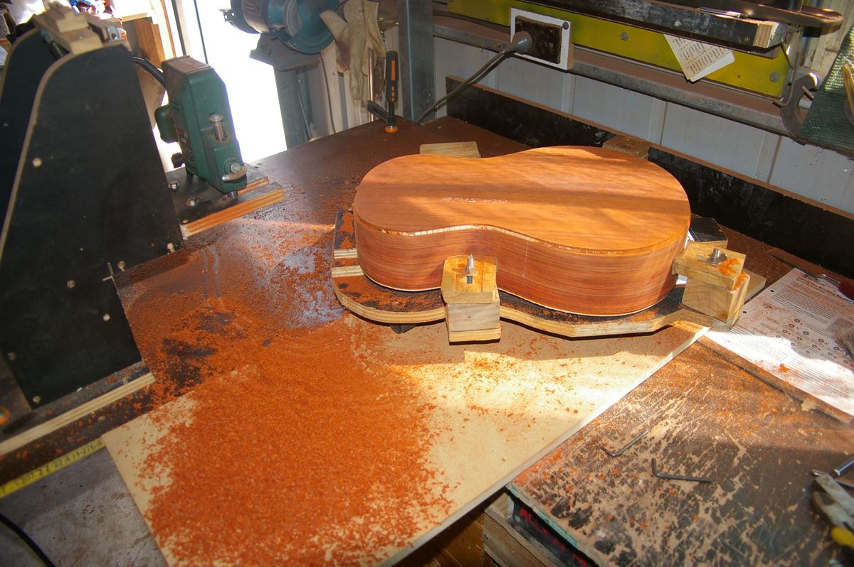

Hey Frank, your posts are so well thought out and clear, thanks for your thoughts, it all makes good sense. The photos show my version of a Jim Williams jig.

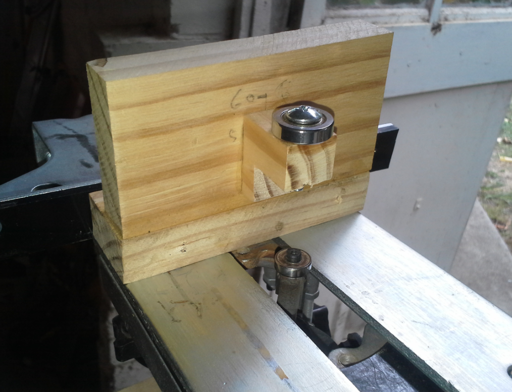

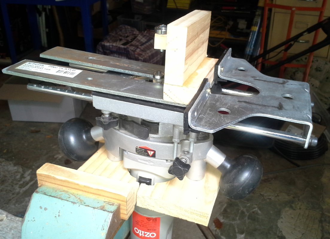

I made a board for the trimmer to sit in to clamp to the vice. I then used the edge attachment of the trimmer as a back plate and screwed the jig to that. Under my jig I screwed in two halves from a thick bracket I had in the shed as I found I needed a larger 'tray' to stabilise the base, while I focused on keeping the sides vertical while rebating. As I had a bearing on my rebating bit, I just needed to mount one above it and could adjust its position by sliding the edge attachment in and out. It worked well in the end.
Thanks everyone for your advice in the posts. It is extremely helpful to a newbie!

I must say that I don't quite get your jig, but it's great that it worked for you. Of course, using an appropriately sized bearing on your rebating bit is an extremely important and valuable technique (that I completely forgot to mention when I last posted a reply!), although I didn't use one for a long time after I started to use my jig. I now find that using both a jig that lets the router rise and fall vertically, and a bearing on the router, while a belt-and-braces approach, makes the process into a very predictable "ho-hum; no problems here" affair.
Frank.

Nice simple solution there Andrew, just watch for any play and slopiness on settings on that Ozito router. I bought one of those a few years ago at Bunnings and the thing ended up in the trash can after 5 minutes use...the depth stop kept slipping and I ended up routing a rosette channel right through a spruce top.
