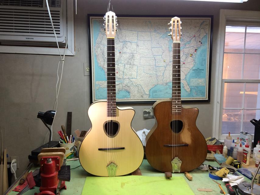

Peter, This is timely as I am trying to decide how to tint a guitar. Historically, I've done nothing more than use the finish itself to color the wood. In some cases, I have used amber shellac. But, now I have a project which requires a darker finish that resembles an aged vintage finish. Here is a picture.
The back and sides are currently grain filled with epoxy and the top is sealed with a thin coat of blonde shellac. I was thinking of added aniline dye (Stewmac Colortone) to 1 pound cut shellac and spraying thin coats until I got the color value I need, then blonde shellac over that to lock it down and seal. Finish up with standard French Polish techniques. Any comments on this approach?

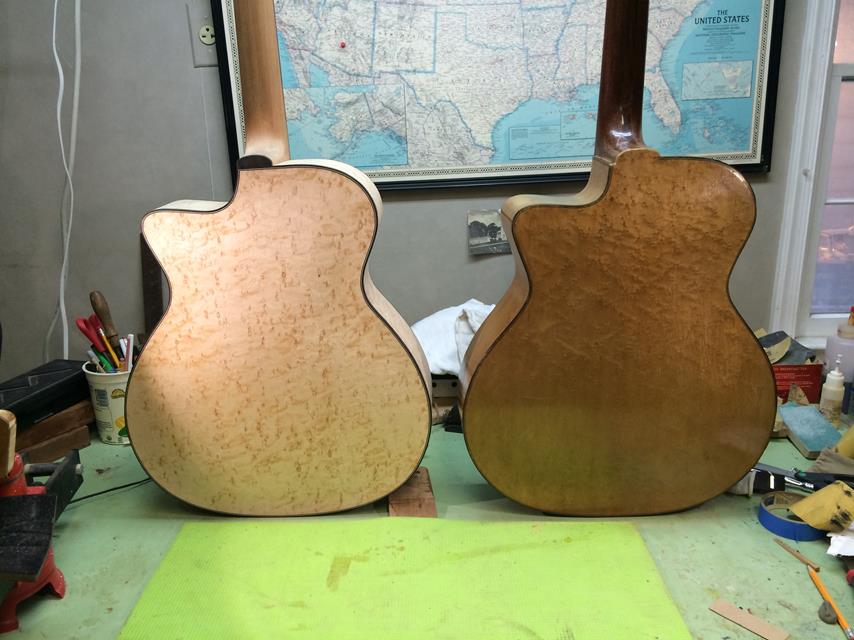

I tried some ColorTone dyes in 1 pound cut shellac. Spray it with many thin coats. Coats dry immediately, I mean instantly, so I can just keep spraying. I stopped only because I wanted to adjust the hue a little, too yellow right now, but not dense enough yet, so plenty of room to adjust. Seems to work just fine, seems very thin, almost no appreciable build up which is what I was after. I want to build up with clear to lock in the color. If Peter or anyone else has suggestions, I'm all ears.
