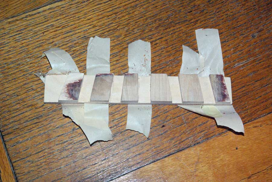

Well after the usual delays and scares along the way I eventually finished the Fleta style classical that I started some months ago. I started before I had absorbed the Gore Gilet book so didn't follow their methodology fully but pretty much stuck to their design.
I strung it up. It was very 'dry' in sound. It had good separation. It had not bad balance. BUT it had no volume!
Was I disappointed - yes. Was I sunk in despair -no. I thought I can work this out. I measured the spectra from top and back. I reread the relevant chapters of the book. I practiced shaving braces on a previous build ready to reduce the stiffness of this top. I played with adding mass to the top to see if clashes of resonant frequencies were a problem.
I sat and thought. I sulked! I went and did something else.
Then I thought I would just check that I had put in the lower transverse brace the right way, and that the flying bit was in the right place.
And just look at what I found:
I'm sure this must have happened to many a builder but as a beginner this was a big deal.
I still don't know if it is great guitar but at least it's not a terrible one!
So a much happier hobbit after a cold miserable winter day in the UK.

Been there. Done that…
Maybe we need T-shirts.
Re: Beginners nightmare
Great find!
I have read that such things even happen to surgeons, which lets me conclude you've got the ticket to charge a premium for your guitars.
A classic (
) example of what too much bridge mass can do to the sound! Good find Dave and glad it's not the Lemon you thought it was
My specialty is leaving big lumps of Blu-Tack!
Yeah, I bet everybody's done that. I know I have.
