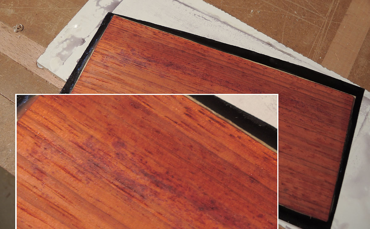

Now, as I glued a veneer to the head plate, when peeling off a paper I used to avoid the plate getting stuck to the pressing caul and at the same time let moisture escape, you guess it: the padouk plate revealed some of that violet staining! So far so good, but I still have no idea what exactly could have caused it. Main suspects are the bleached paper and scraper plane blade particles in conjunction with water and maybe the hot hide glue I used for veneering.
I'd greatly appreciate any ideas about the what the actual staining agents could be, and how a staining solution could be created.

I quickly changed the laminate to a dry caul to accelerate drying, and took a photo so you can see the purple spots,which is the colour I'd like to reproduce on an entire set.
